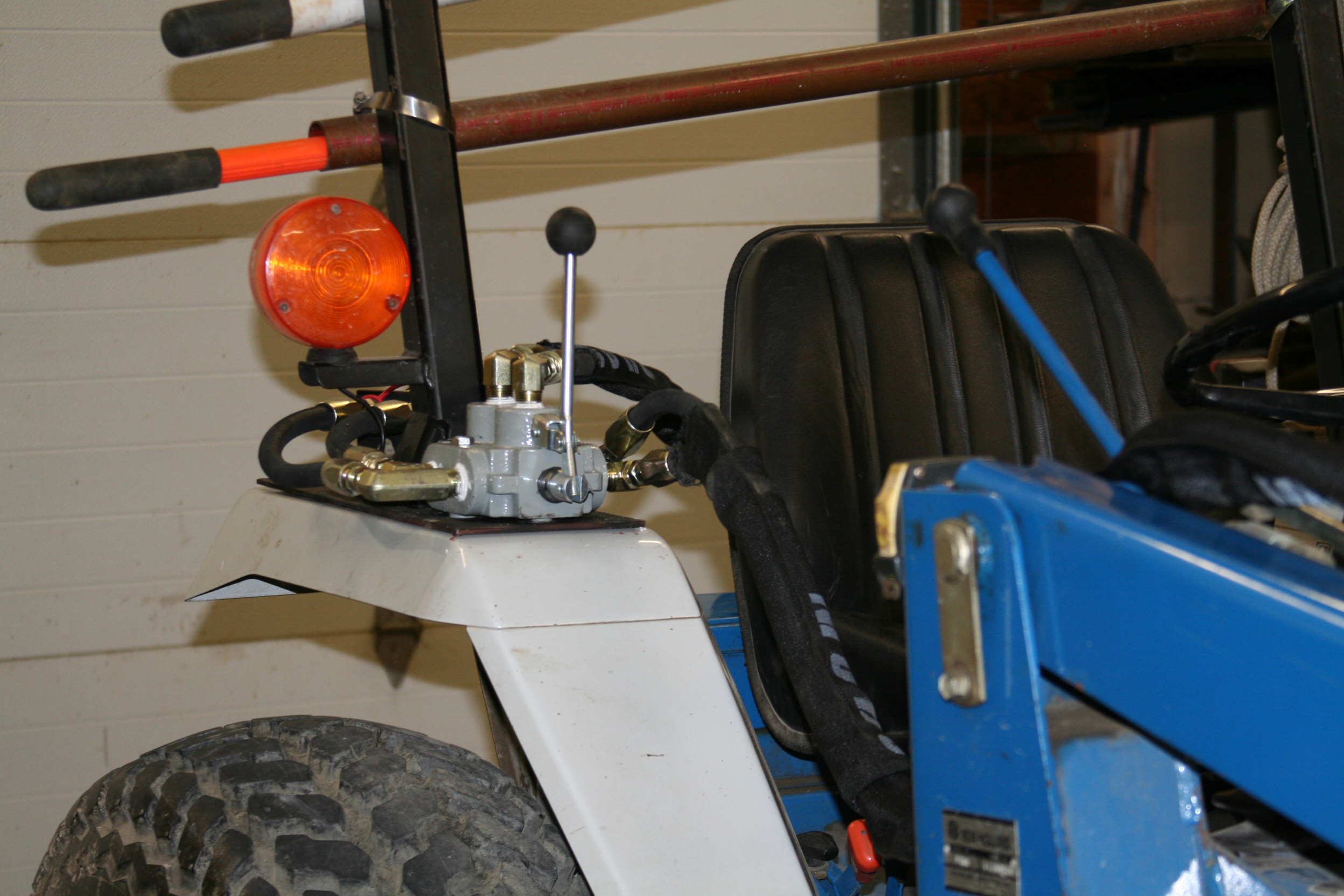

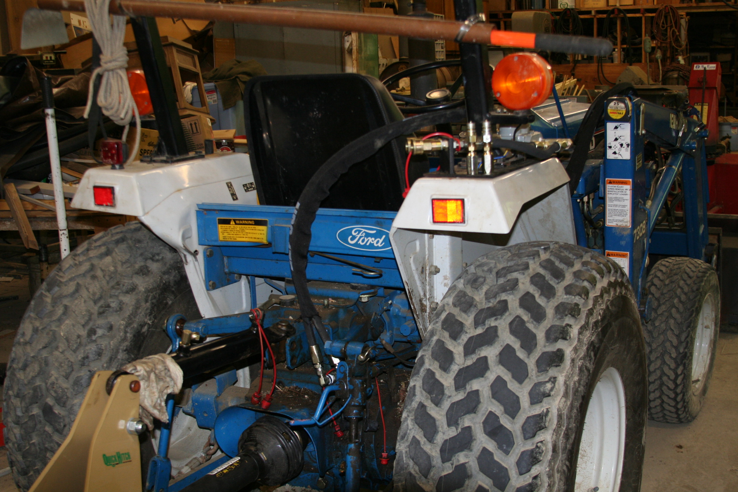

Is there such a thing as a manual diverter valve? I have 7ft plow for my loader that I run hoses back to my 3rd SCV. I just picked up a 3 pt snowblower with a hydraulic chute I want to be able to use both without switching hoses all the time. So does anyone make one? I've got a 2010, 3320 PRT open station. Thanks in advance
   / Diverter valve #3
Absolutely I did exactly that for the same reasons.
The rear disconnects you can see in one picture . Same valve as ref above I think. The front I don't remember what I did . I sold that tractor in 2007. IMG_3475.JPGIMG_3479.JPG
