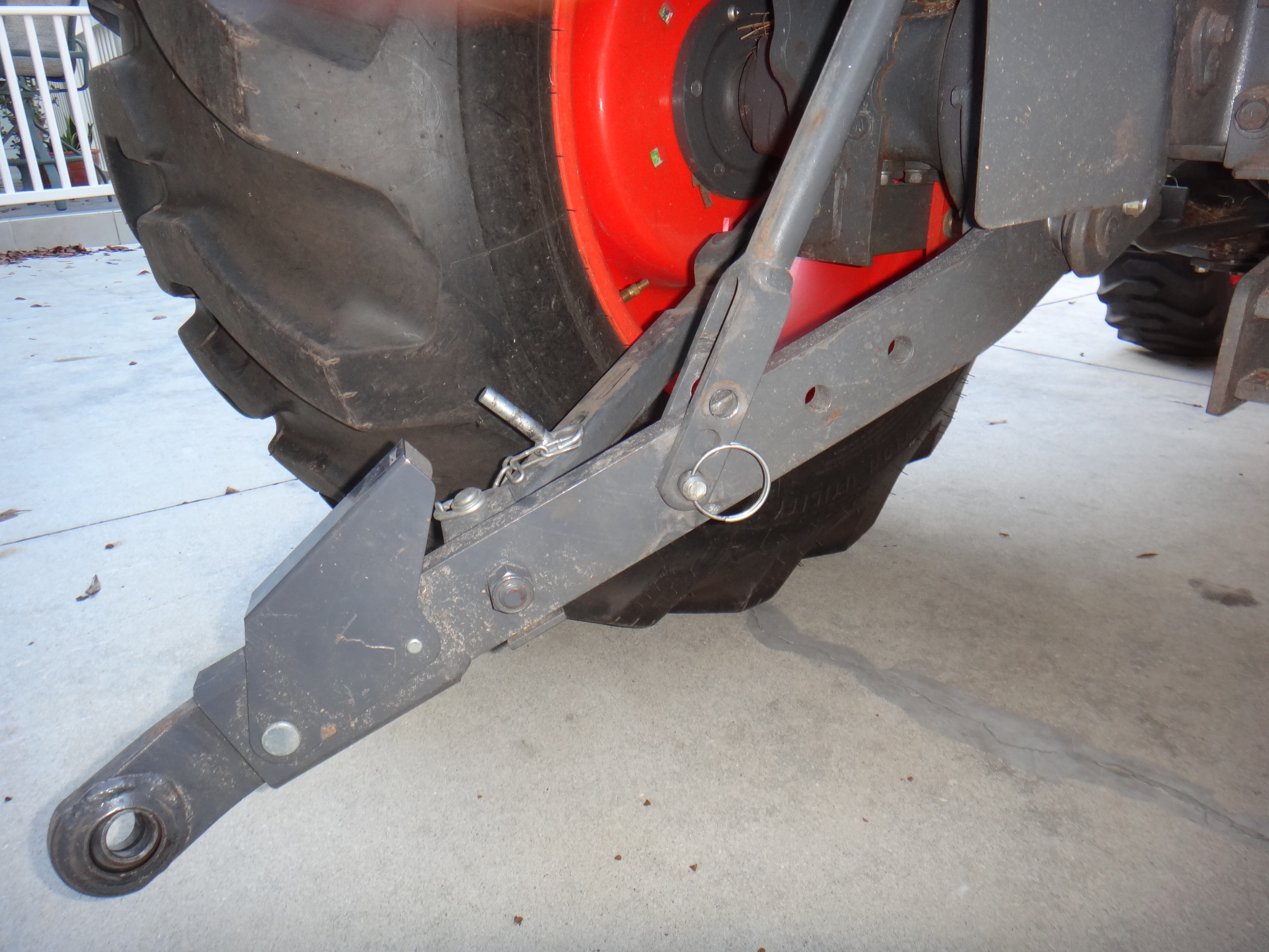

I bought a grader blade at TSC. It is pretty much useless. The old one that I mistakenly let go with my old Ford 3000, had two adjustments. One for right and left and one for up and down angle. This one just has the right and left. The angle adjustment on my Mahindra 4025 leaves a lot to be desired as it only allows for a very slight angle. Not enough to dig a trench. I ran my middle buster plow first and then the dang blade won't even go deep enough to clean the resulting trench out. Is there something I'm missing here or is that just the way it's going to be?

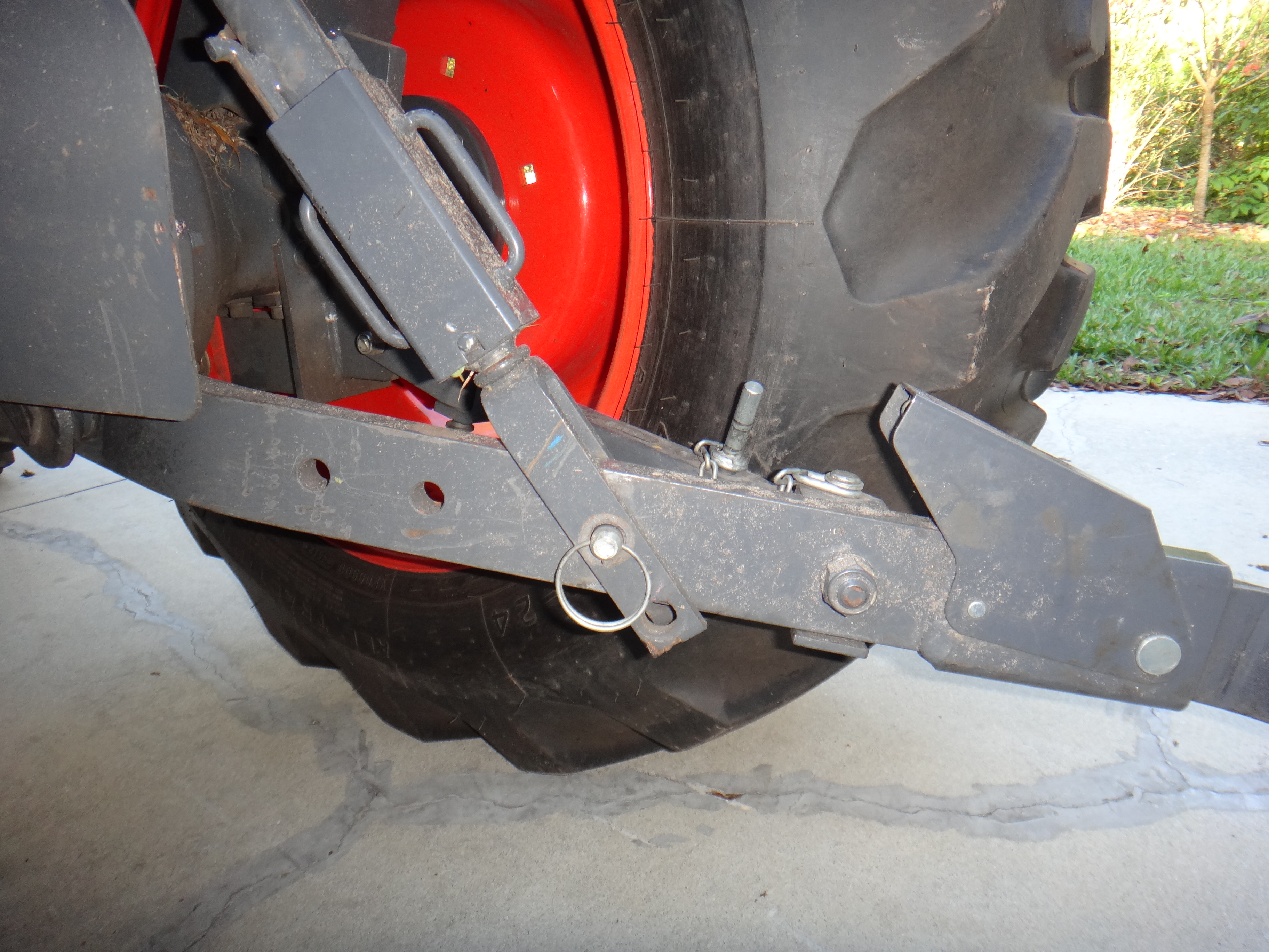

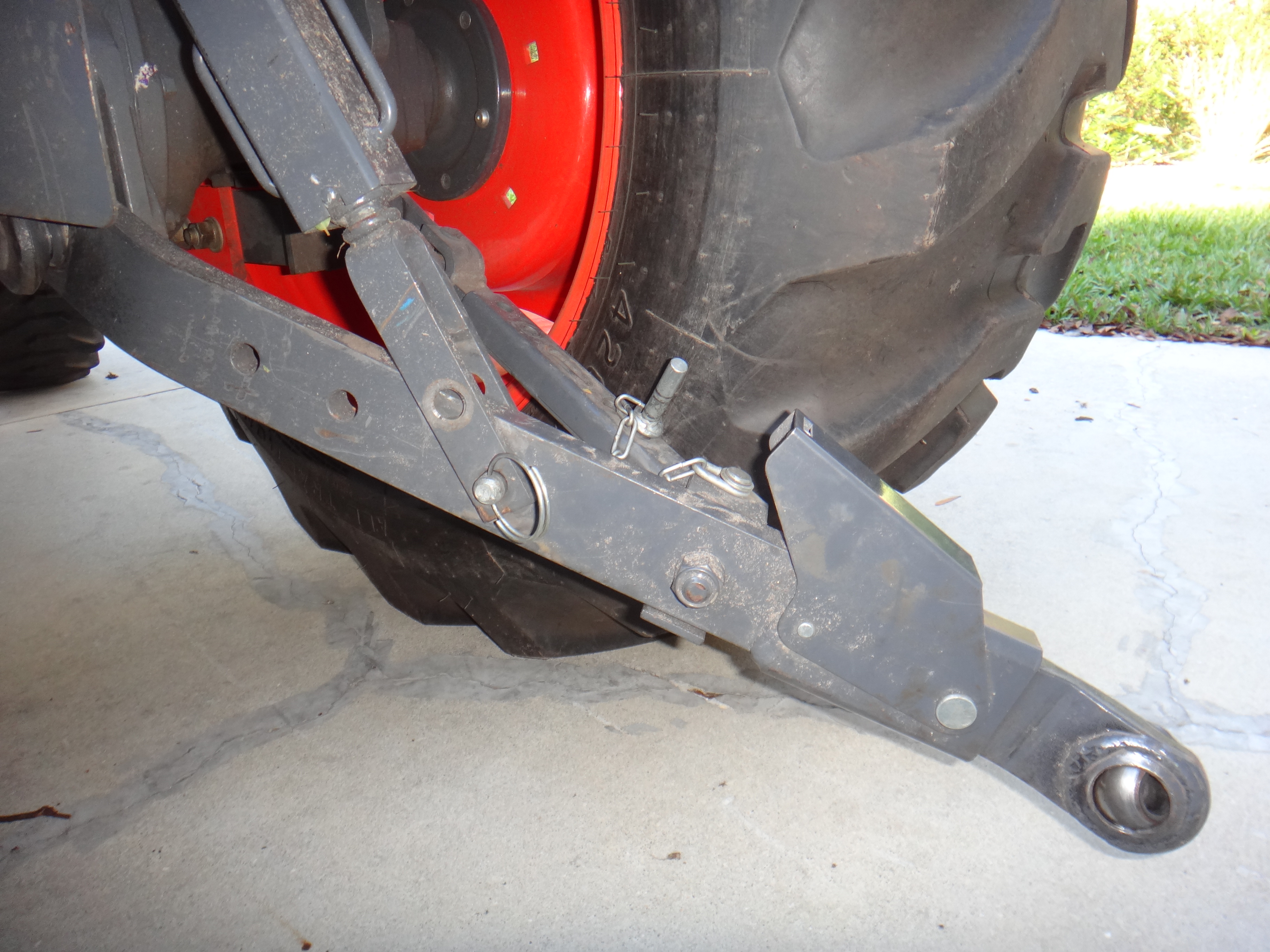

Adjust the Three Point Hitch: Move the pin on the left side and right side Lifting Rod stirrups from the top/default hole to the lower hole and the Middlebuster will go 4" to 5" deeper. Note how much the right Lower Link has lowered in Photo #2, relative to Photo #1.
Do not pound on the pins. Put in slack with hydraulic control and remove left pin. Adjust Lifting Rod screw on right side and remove right pin. Lightly grease pins before replacing. I use anti-seize compound.
On my Kubota, the left rod has three adjustment holes, so you can position implements with some tilt provided by the pin adjustment, if desired. Photo #3.
How deep, how broad, do you want to trench?
Photos: Kubota L3560
