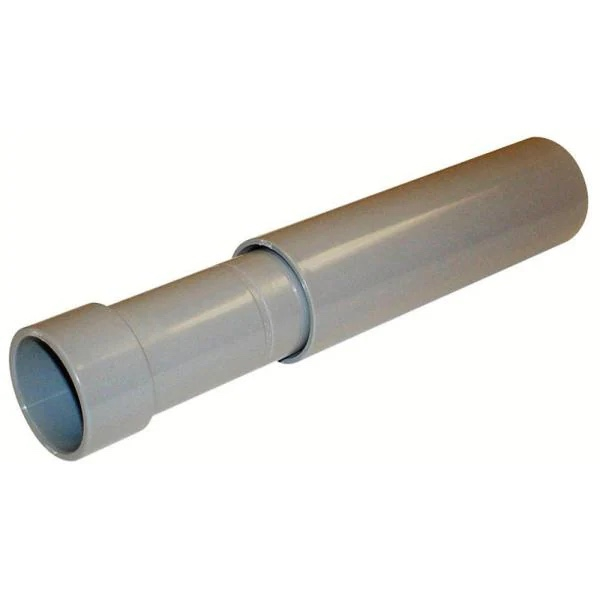

My area doesn’t but some places require an expansion joint in the conduit.
/ Ditch Digger
#33
I don't guess I have ever heard of that.
