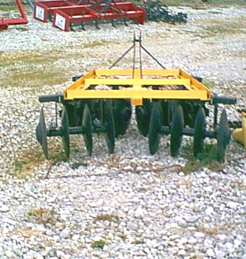

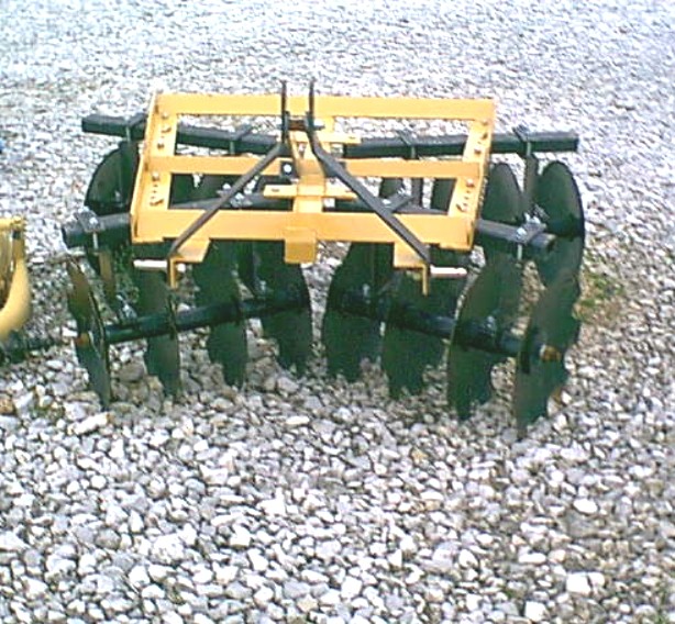

Here is a New adjustable gang 5 1/2 ft we sell for $675 + modest shipping. 18 inch blades. Ken Sweet
   / Disk size for CT225 #4
Hi Ken, this may be a dumb question but I have to ask anyway :laughing: - I noticed one end of it has scalloped blades and the other end is smooth blades. Why is that?
Thanks,
Bruce
   / Disk size for CT225 #5
Thanks,
Bruce
Traditionally, the front cuts more agressive and the back begins the leveling/smoothing out process. Then a good well casing drag filled with concrete should be tied behind the disc to finish the leveling job. Ken Sweet
