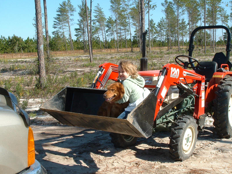

Thanks for the very fast feedback - I've attached a picture that was taken a month ago - You can see the weeds in the background - I think their growth has slowed down some now that it has gotten cooler, but I'm sure they'll be coming on strong in the Spring.

If that land is as flat as it looks - and it looks really flat - and you're leaving in place all the trees I see still standing, then a disk should work just fine. You could also just spray roundup and seed a few weeks after that (once all weeds die and you've had a few rains), just using a chain harrow to slightly scratch the surface.

Should be easy to fill in the low spots with your FEL and box blade. Use a chain harrow (= drag) to smooth out the sand. A piece of chain link fence attached to a log or something equivalent to a log works fine as a drag. Solve your problem for $20.
