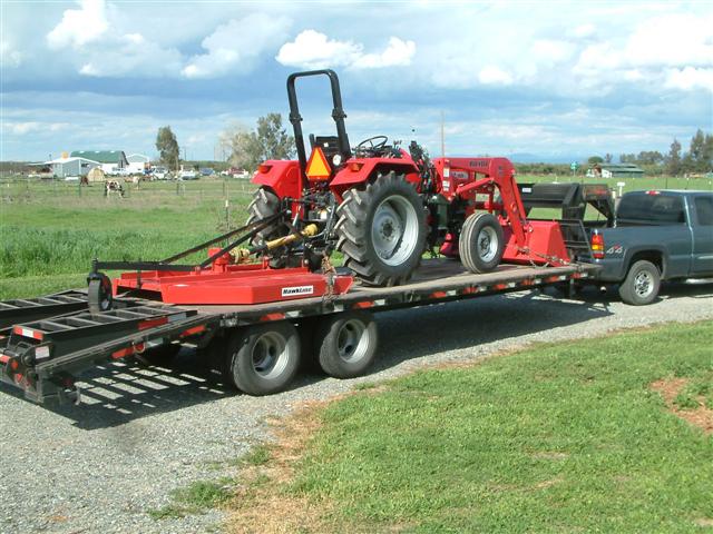

If you're not going to bale the cuttings, forget about disc, drum and sicklebar mowers. Get a 6-ft rotary mower (aka brush hog, bush hog, shredder, slasher). You can tilt it forward for rough cutting (the normal arrangement) or backward to mulch the cuttings. Mine is a Hawkline ($1150 when I bought it new in 2008) and I run it with my 2008 Mahindra 5525 (55 hp engine, 45 hp pto) which is about the same as your MX5100 in hp.
Your tractor is fairly lightweight compared to my 5525 so you'd probably have a problem handling a 6-ft disc or drum mower, which, again, aren't what you want for your job.
For 30 acres of mowing, figure about 2-3 acres per hour with a 6-ft hog in tall weeds (2 ft +)-- faster if the weeds are shorter and you know where the potholes are in the field.
