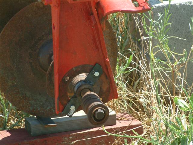

Could be easy or not. I have a 13-ft Minneapolis Moline transport disc (model KA1300).

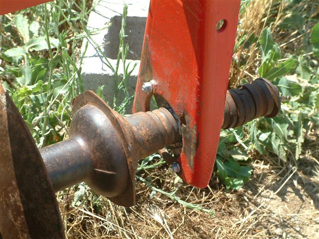

Getting the nut off the end of the axle can be a struggle. I had to repair the bushing on the end of one of the axles. The bushing had essentially disintegrated so I made a quick "farmers" fix to get me going.

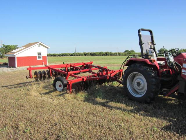

At 13 ft wide, that disc was too much for my Mahindra 5525 (54 hp engine) to pull in anything but dry soil, so I narrowed the disc by removing two of the outer pans from each axle. Instead of struggling with rusted nuts, I just cut the pans off with my 4-1/2" angle grinder and a bunch of cutoff blades.
Good luck.
