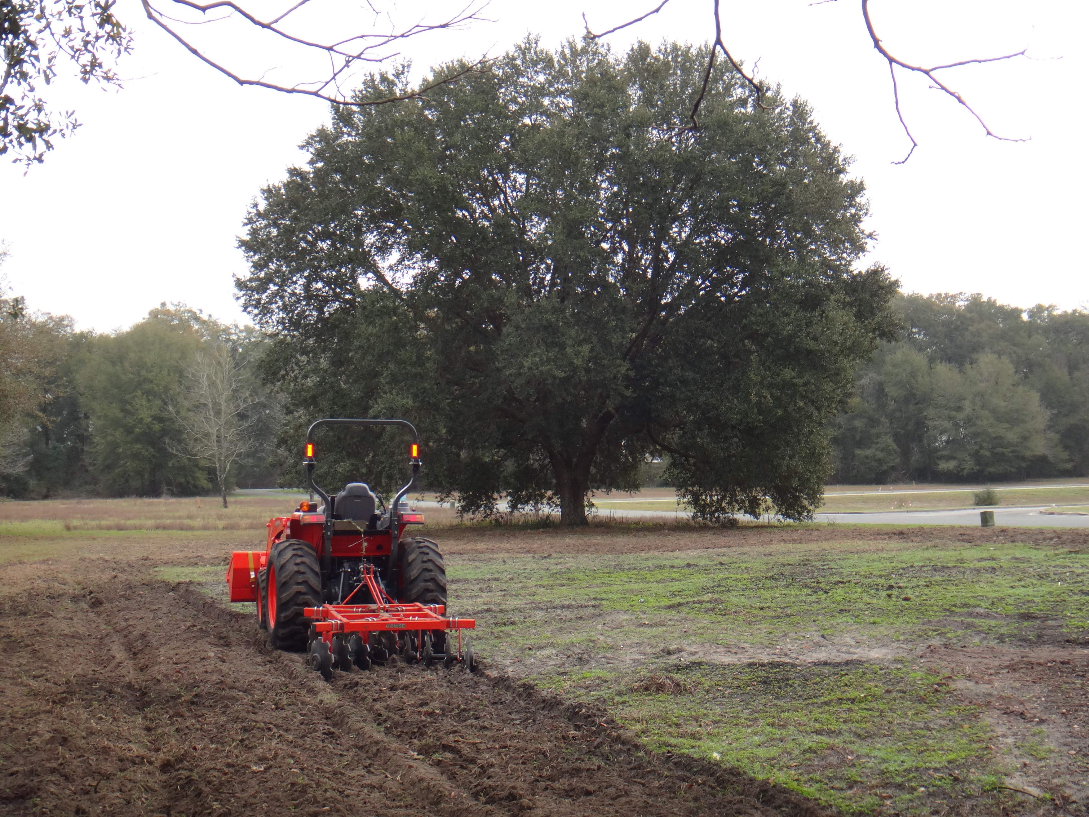

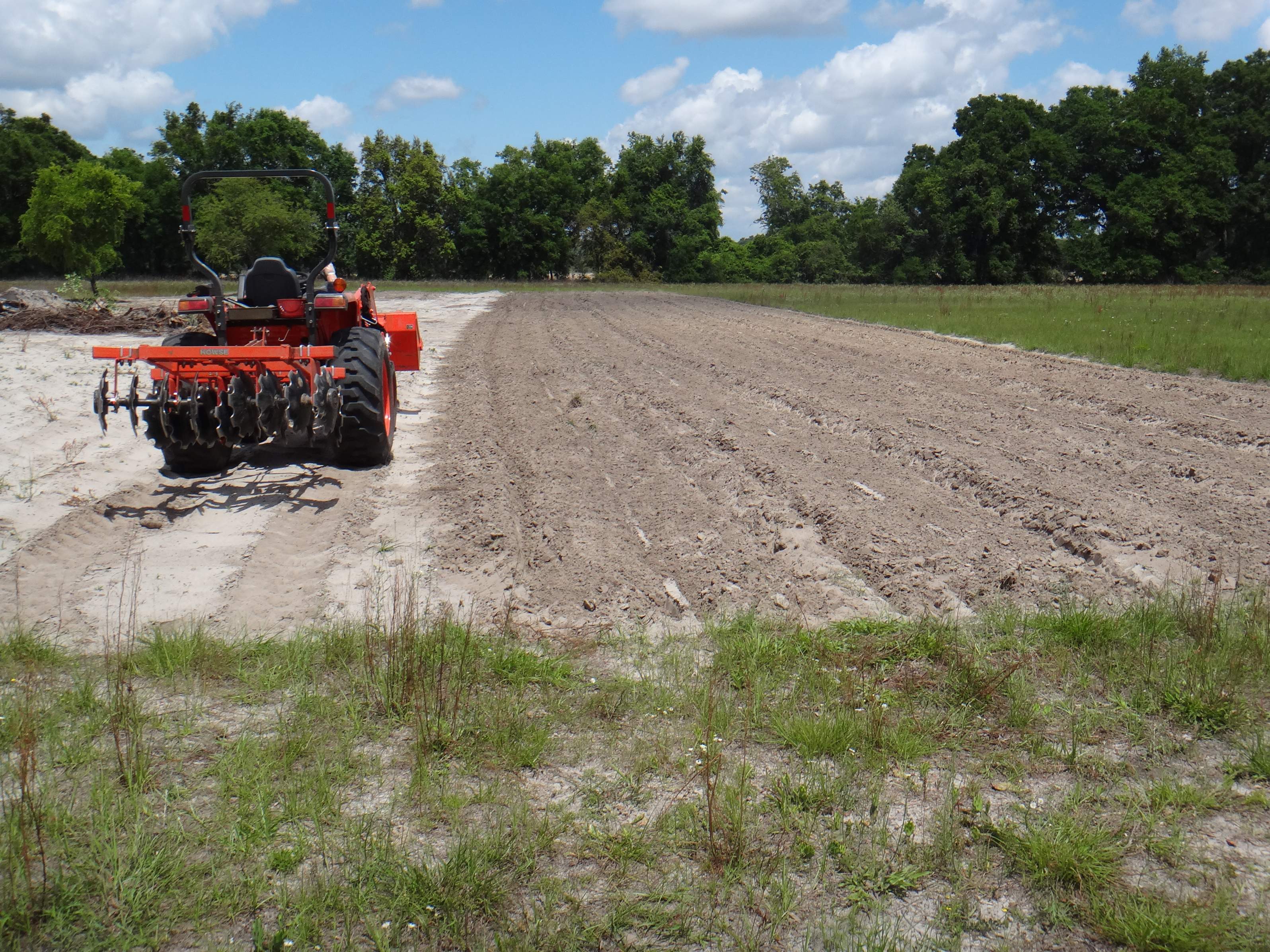

Consider a PTO-powered roto-tiller, rather than a Box Frame Disc Harrow. Both mix soil.
For a Box Frame Disc Harrow to mix soil properly a minimum of forty pounds of implement weight bearing on each "pan" is necessary. Even with forty pounds on each pan, multiple passes over an ALREADY PLOWED field are required to smooth it.
Disc Harrows with 50 pounds bearing on each pan cut better. Usually will smooth an ALREADY PLOWED field in one pass with properly adjusted gang angles. Will prepare a field annually for seeding with two to four Disc Harrow passes over the field. Box Frame Disc Harrows with fifty pounds bearing on each pan usually have pans 20" in diameter.
Both these weight Discs are too heavy for a 2,000 pound tractor. You will not have necessary traction.
Shop roto-tillers, which will efficiently use your 32.5-horsepower, for your 2,000 pound tractor. You will be happier with the result.

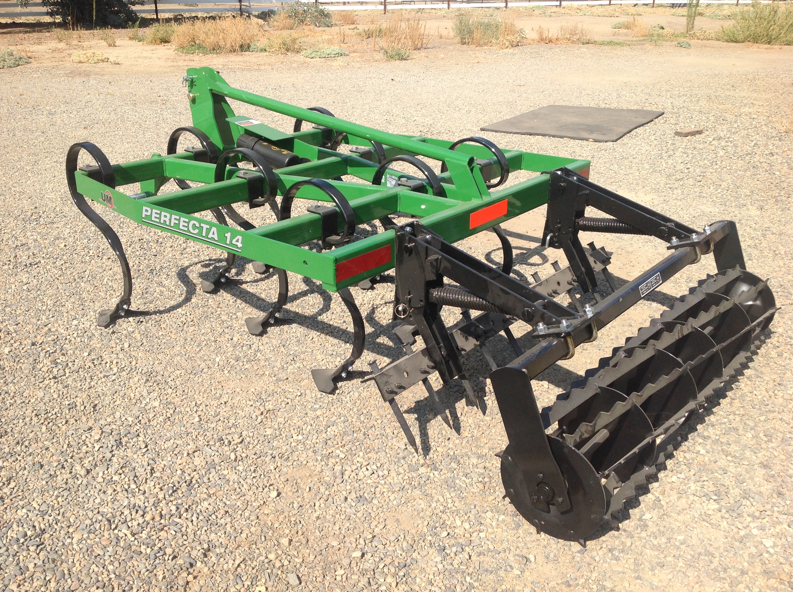

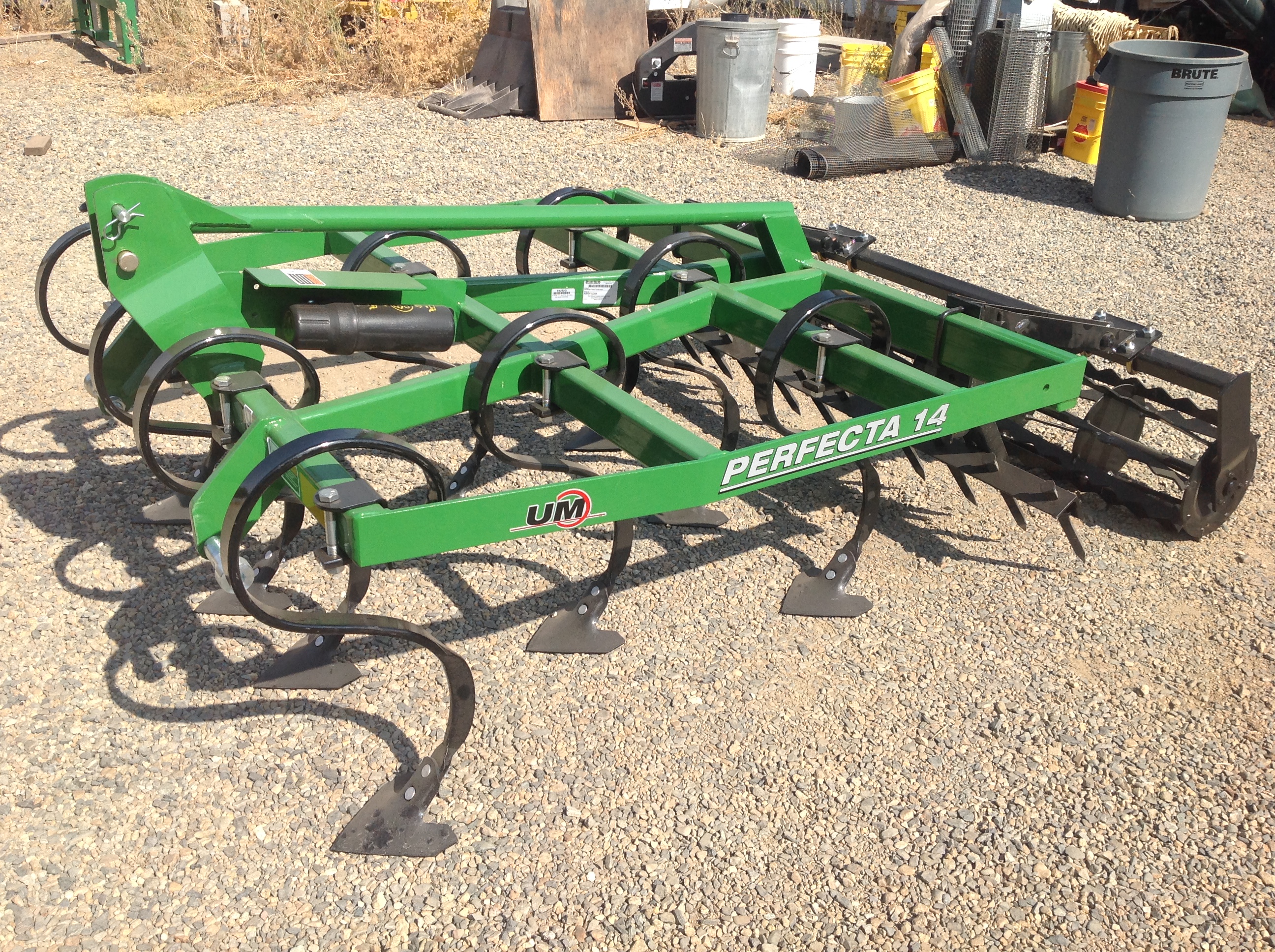

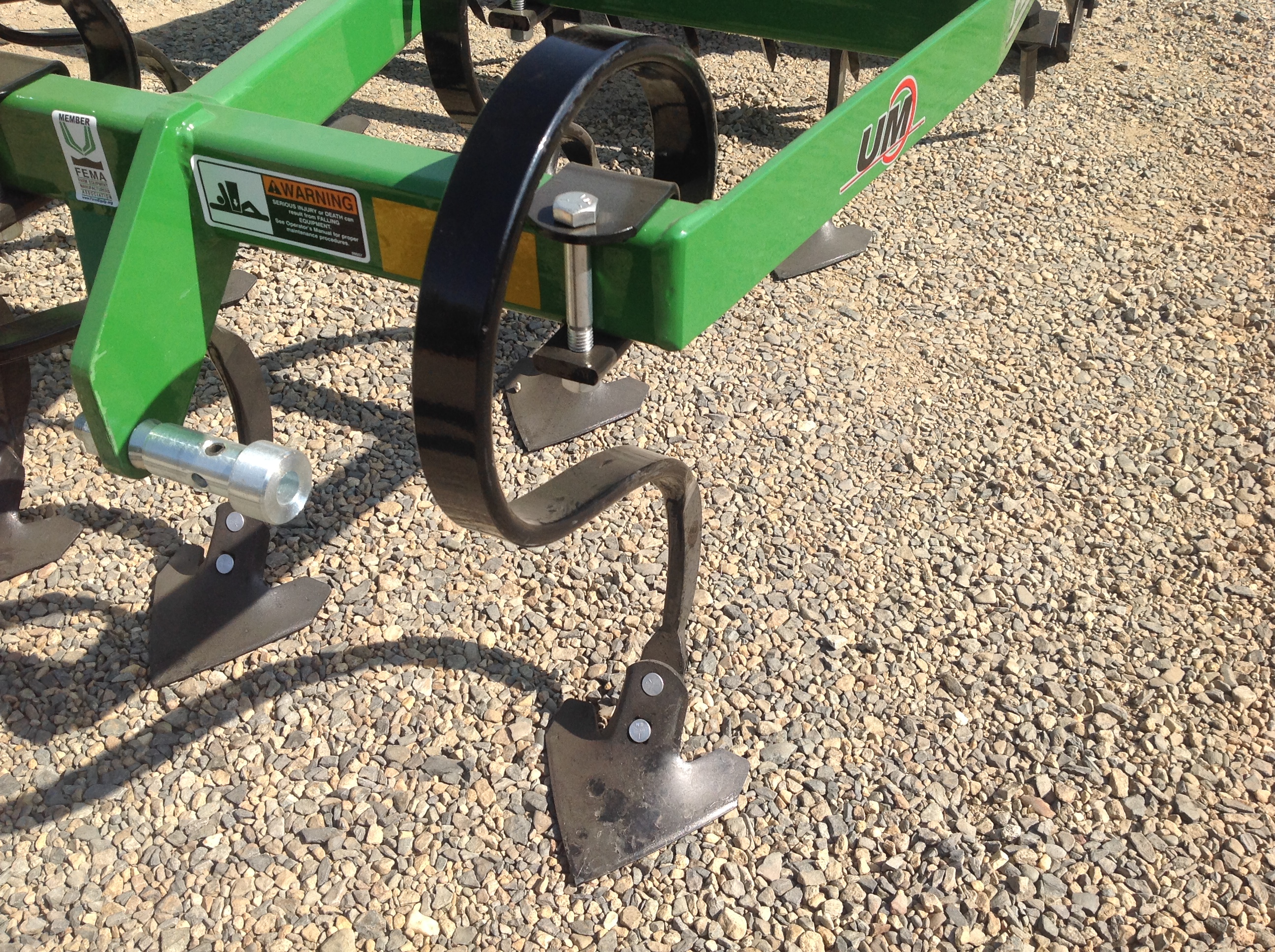

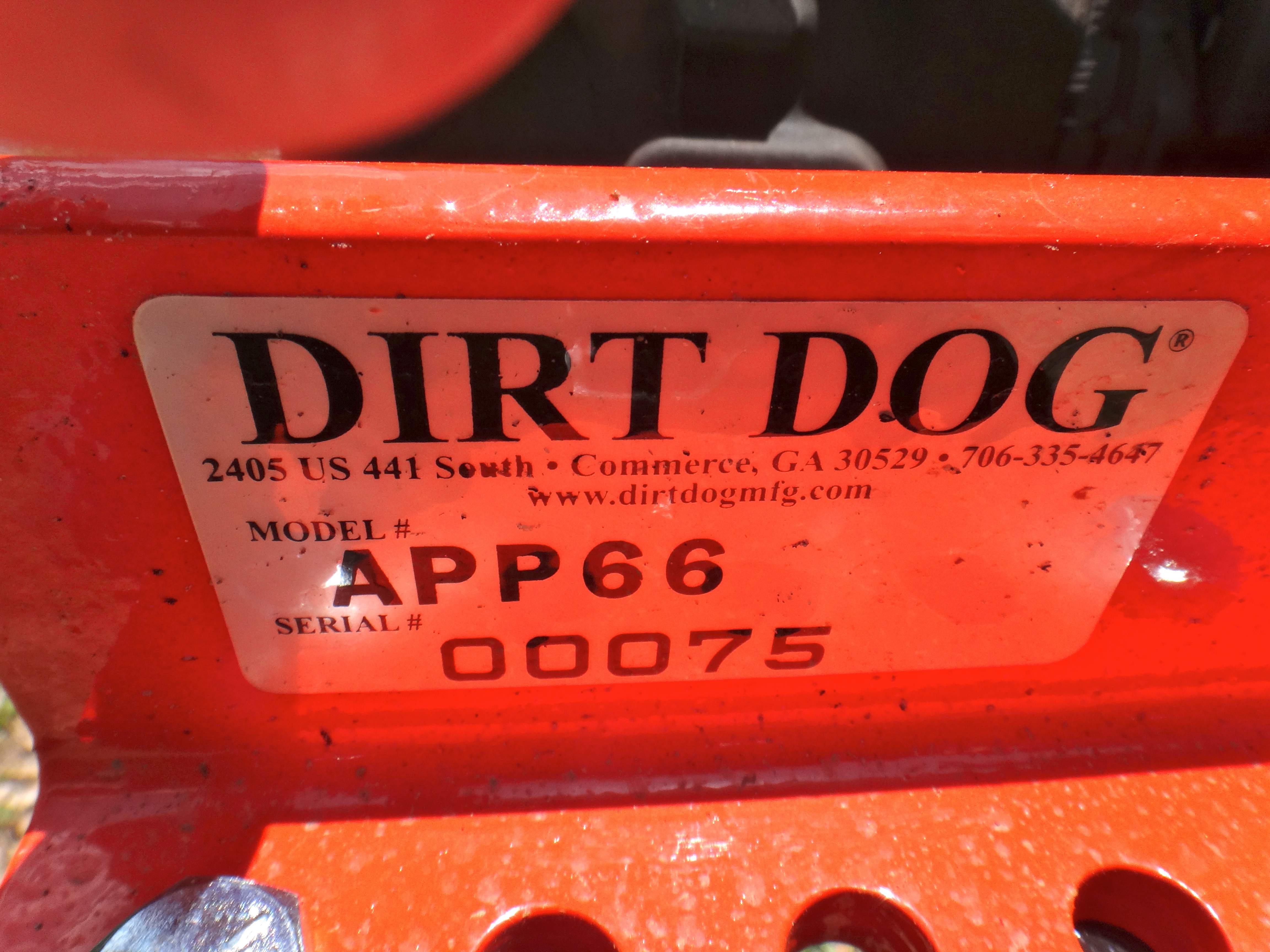

Jeff, I have read many of your helpful post in the past, I just purchased this cultivator but before I use it I wanted to buy the Dirt dog
APP60-5 to do the primary tillage. I live in CA. And at the moment I am having a hard time finding one in stock or finding a dealer that can help me, two dealers I called in Georgia has never returned my calls. Who did you buy your dirt dog from.
   / Disc Harrow with a JD2032R #9

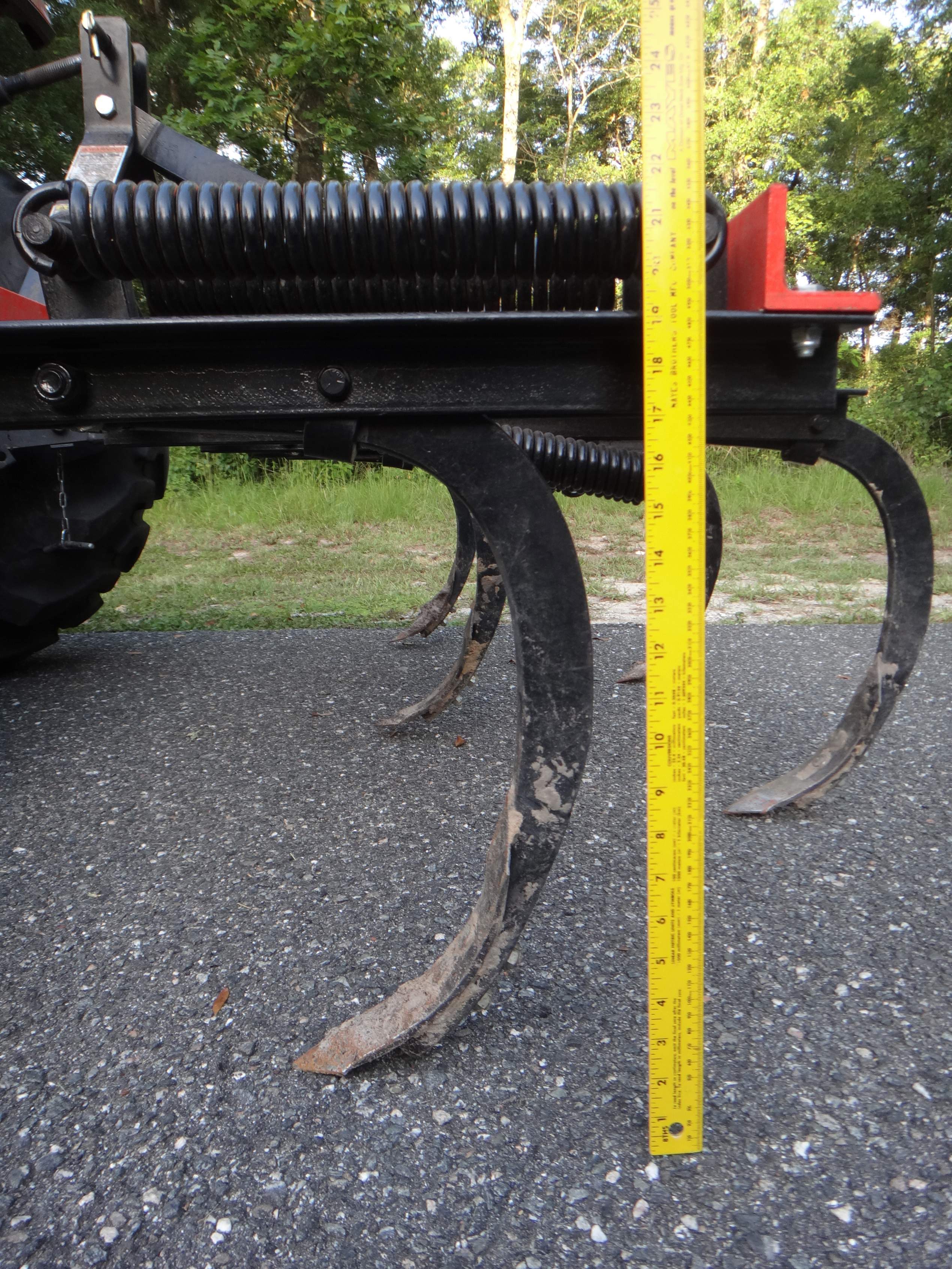

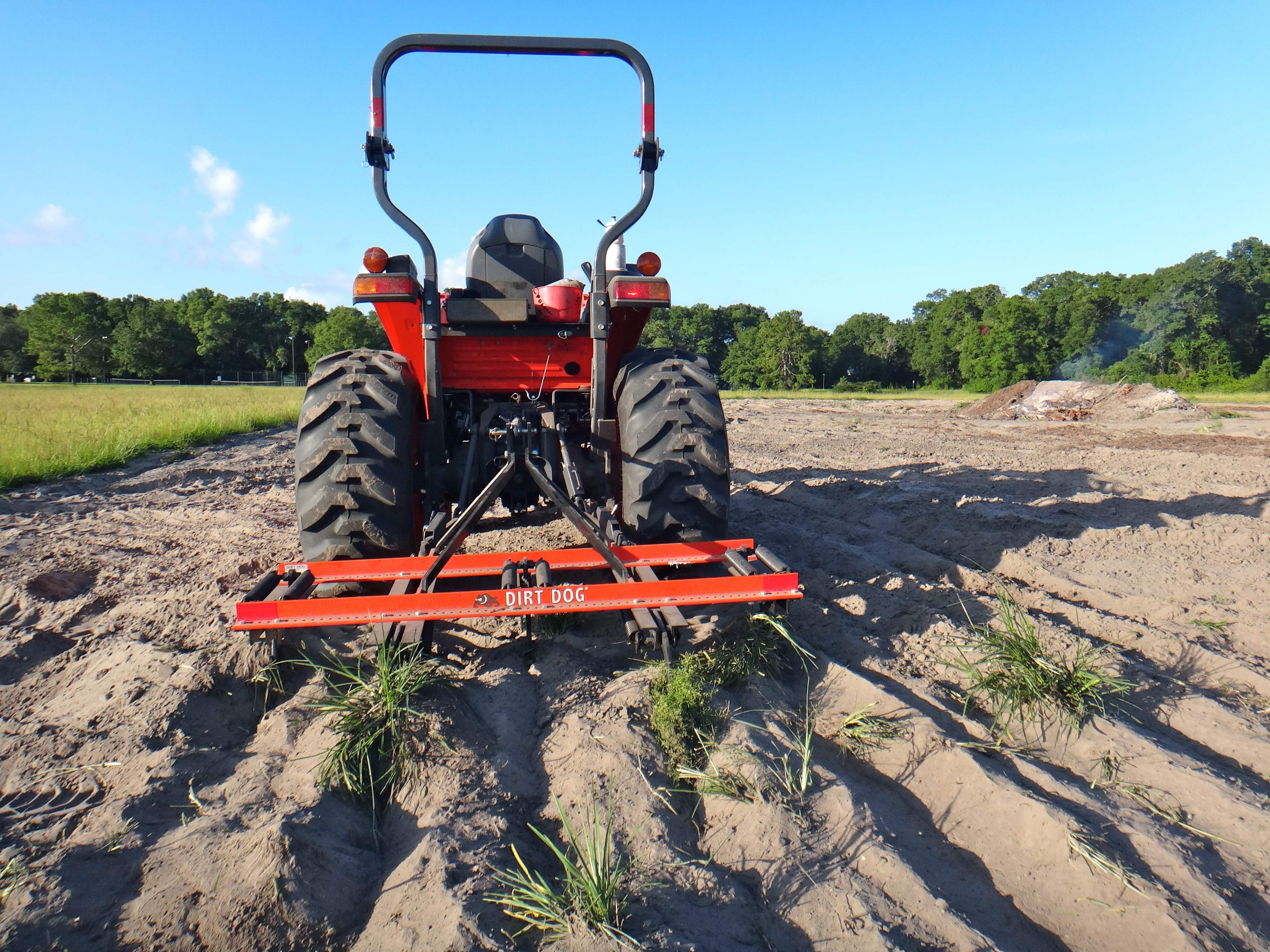

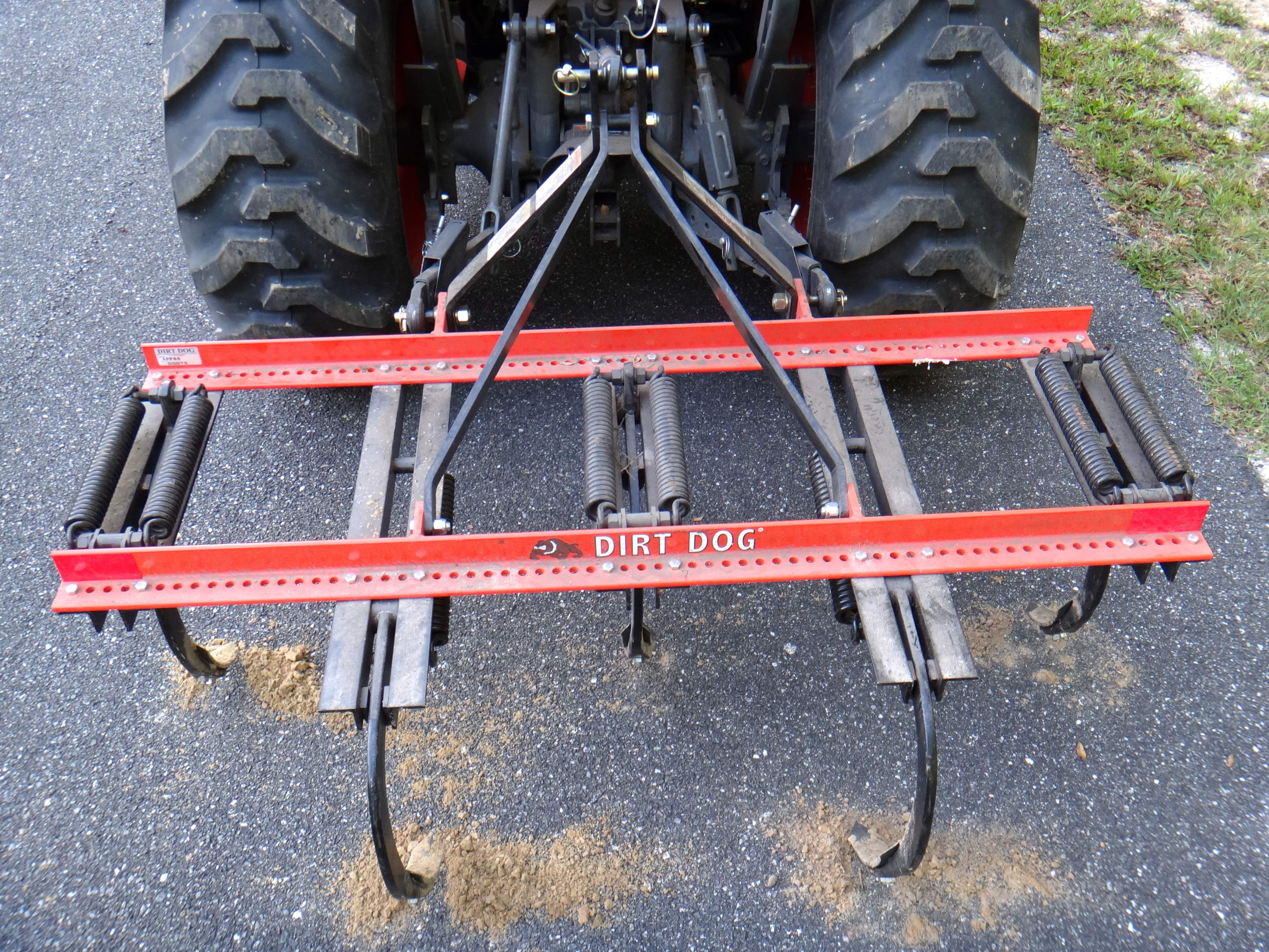

The green implement in three photos is a Cultivator. It has cultivating shovels. It is designed for shallow penetration, therefore S-tine spring shanks are sufficient. UNV is quality.
An APP will have points. It is a conservation plow which will leave 25% of soil surface untouched. Designed for deep penetration, each shank has coil-spring protection.
Between your roto-tiller and this cultivator you have ample equipment. You just need to learn proper operation in properly moist soil. Cover crops appropriate to your area will shade out weeds.
Neither an APP nor a light Disc Harrow is the answer.
Start a new thread in ATTACHMENTS: Need help improving Roto-tiller operation.

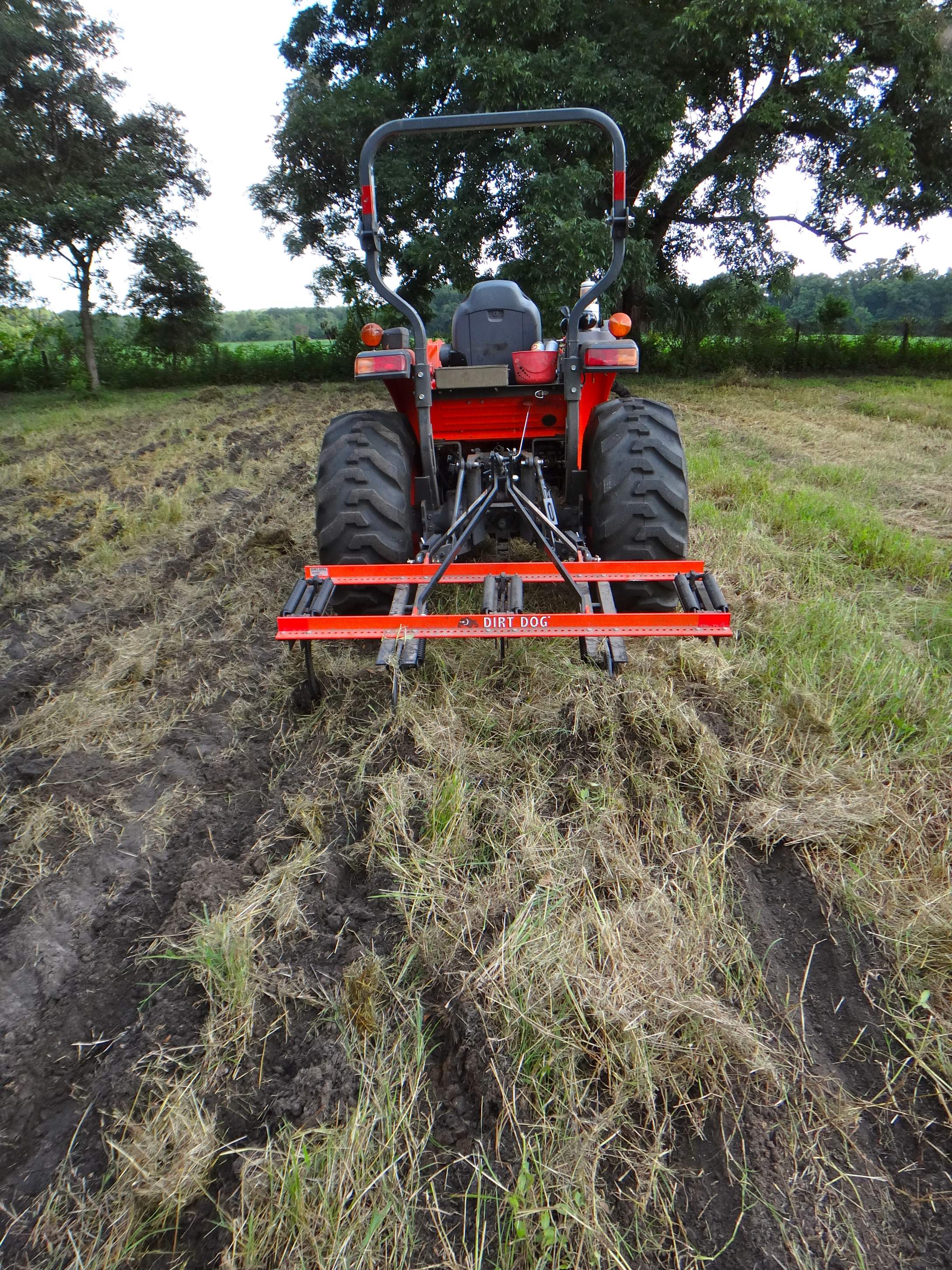

I purchased my DD/APP from local Deere dealer, who is also the Dirt Dog dealer.
