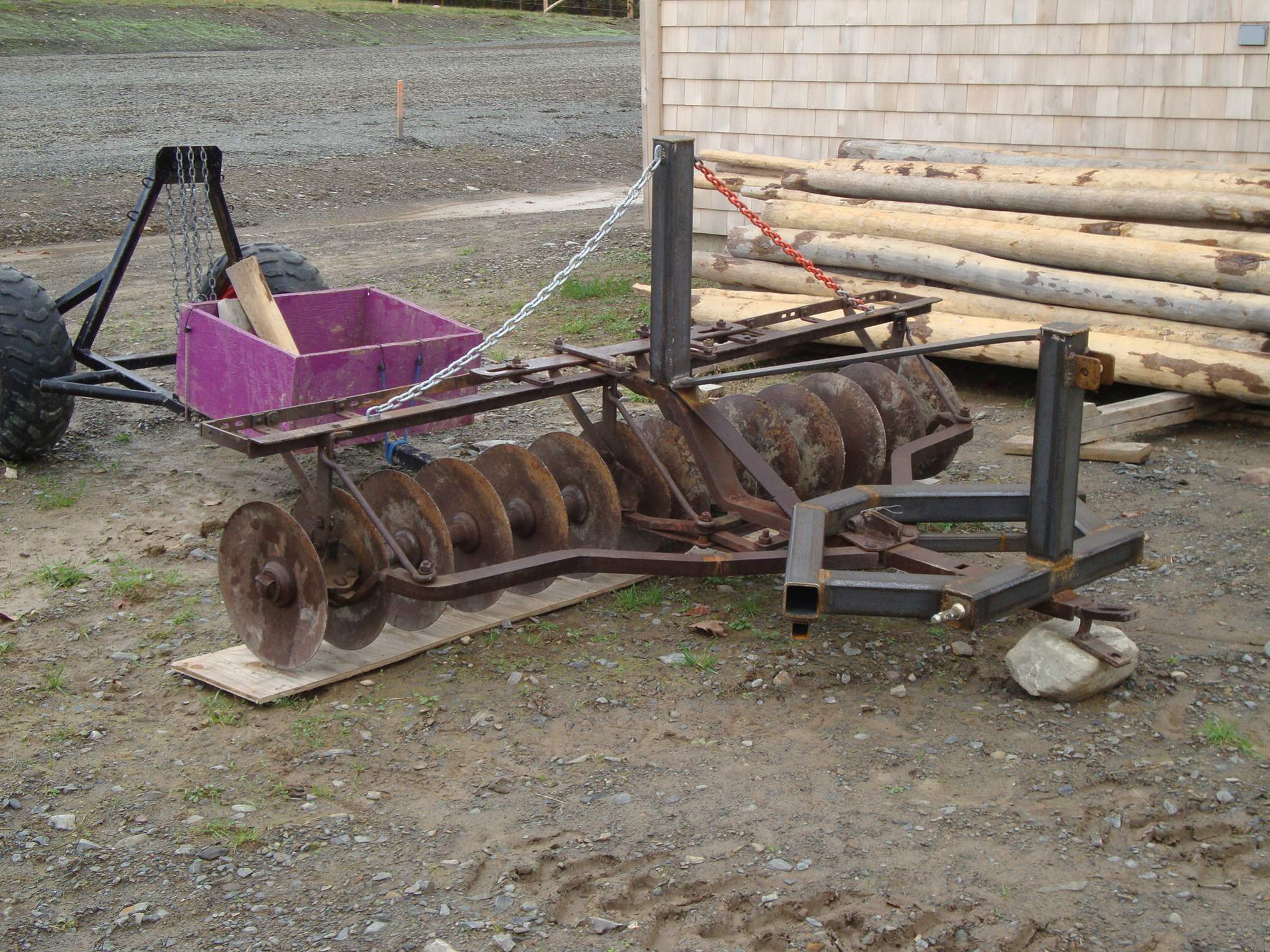

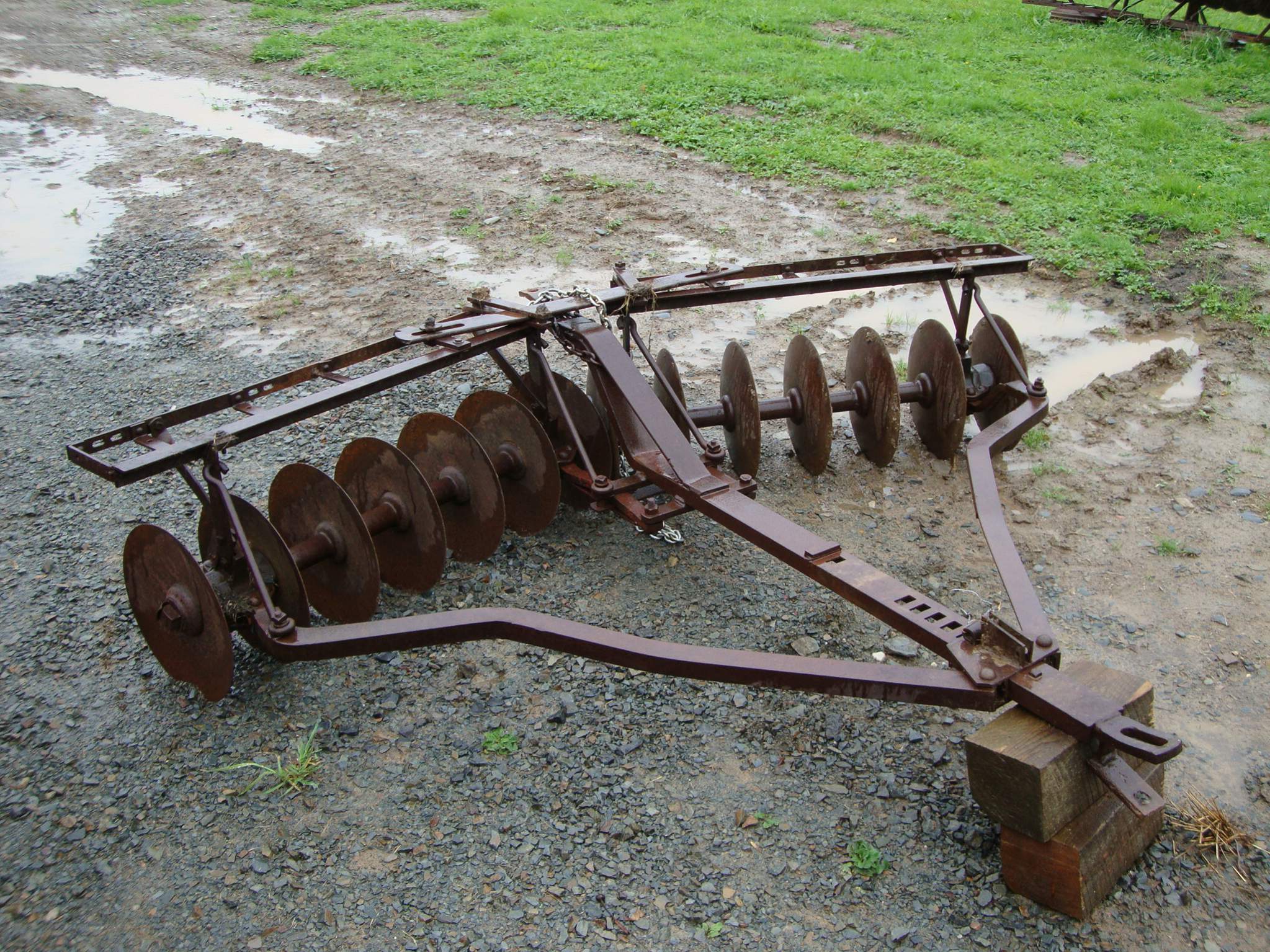

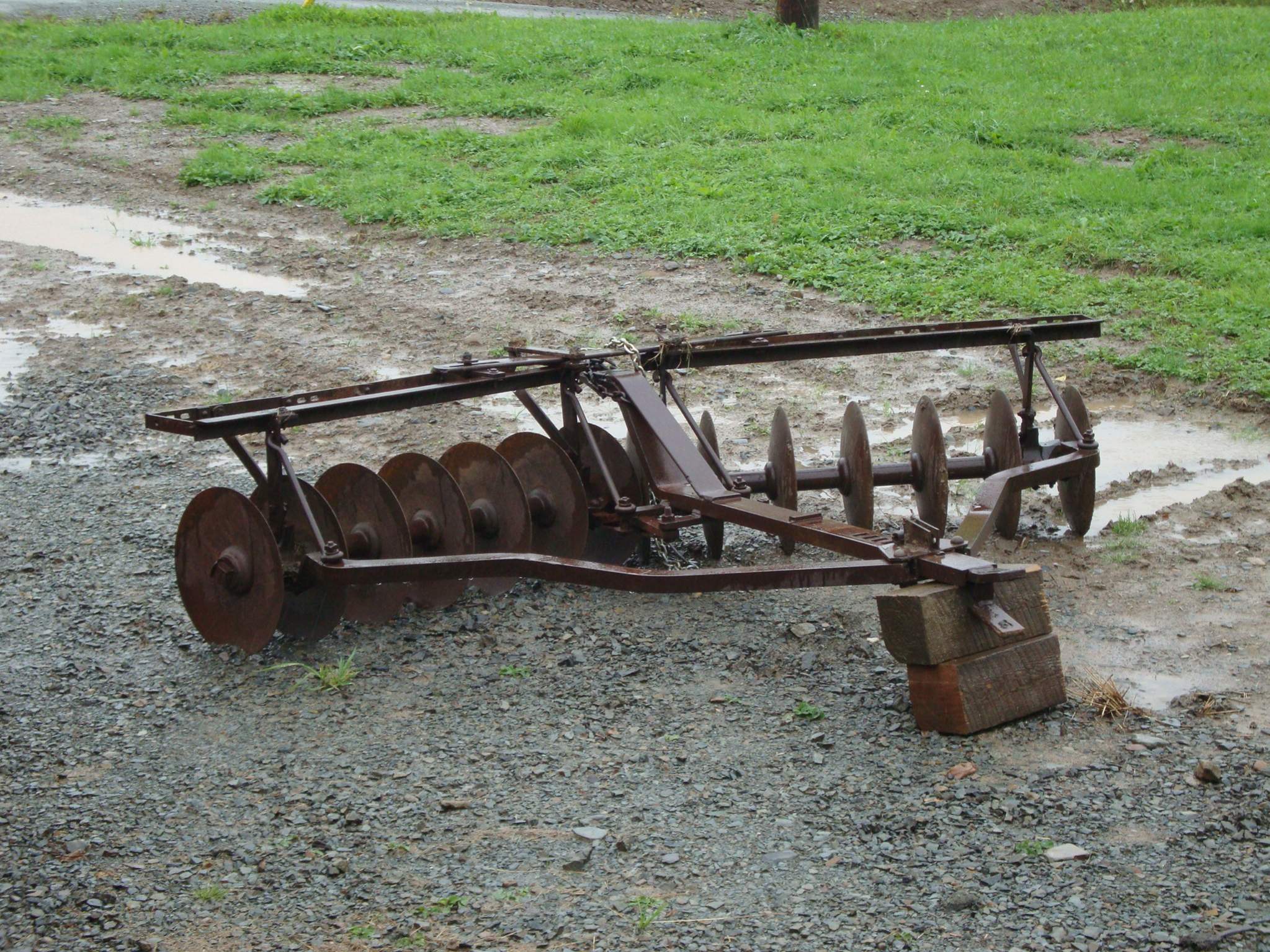

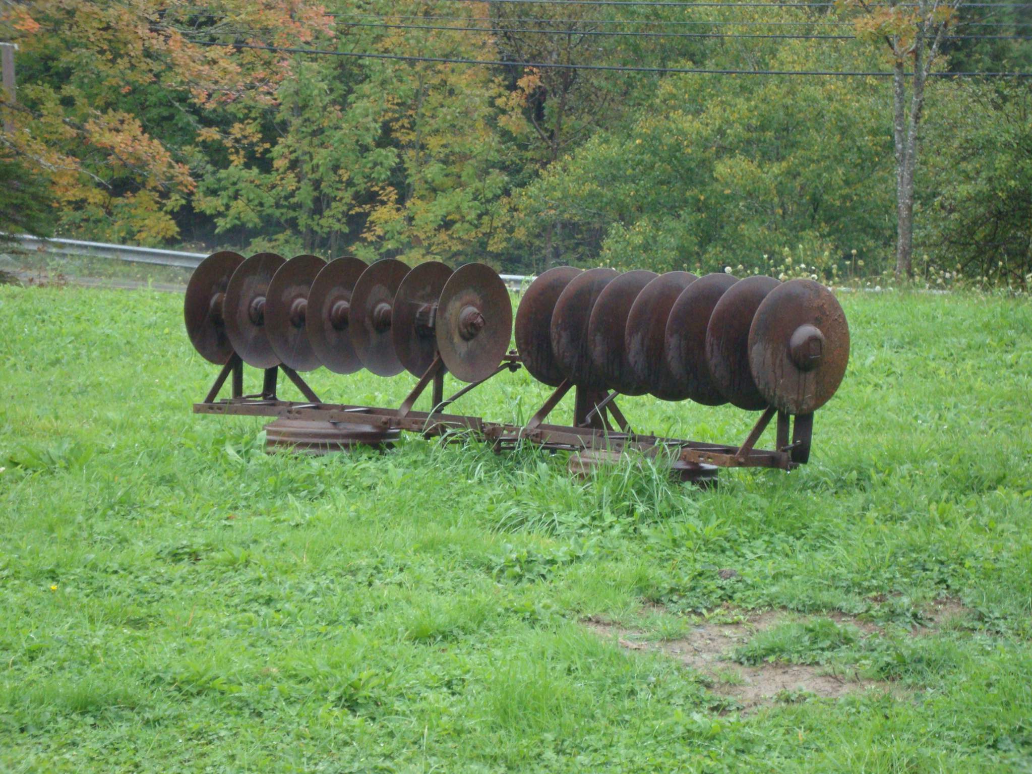

Earlier this year I came across these old 8 foot Massey Harris disc harrows, they were a set of pull-behind double harrows that had been slowly rusting away behind a friend's garage.
We worked out a trade, and now I have a project to convert them to a 3 point type. All the gangs of discs turn freely, which is a real plus.
I considered converting them to rigid frame tow-behind, with a linkage system and hydraulics to raise and lower, but that would have meant buying wheels and tires, plus at least one cylinder and hoses.
All I plan to do with them is an occasional pasture re-work, plus yearly vegetable gardens for us and a couple of neighbours, so extensive re-building didn't make much sense.
I'm going to use the front set only, and either keep the rears for a source of spare parts or sell them off if the fronts work well after the conversion.

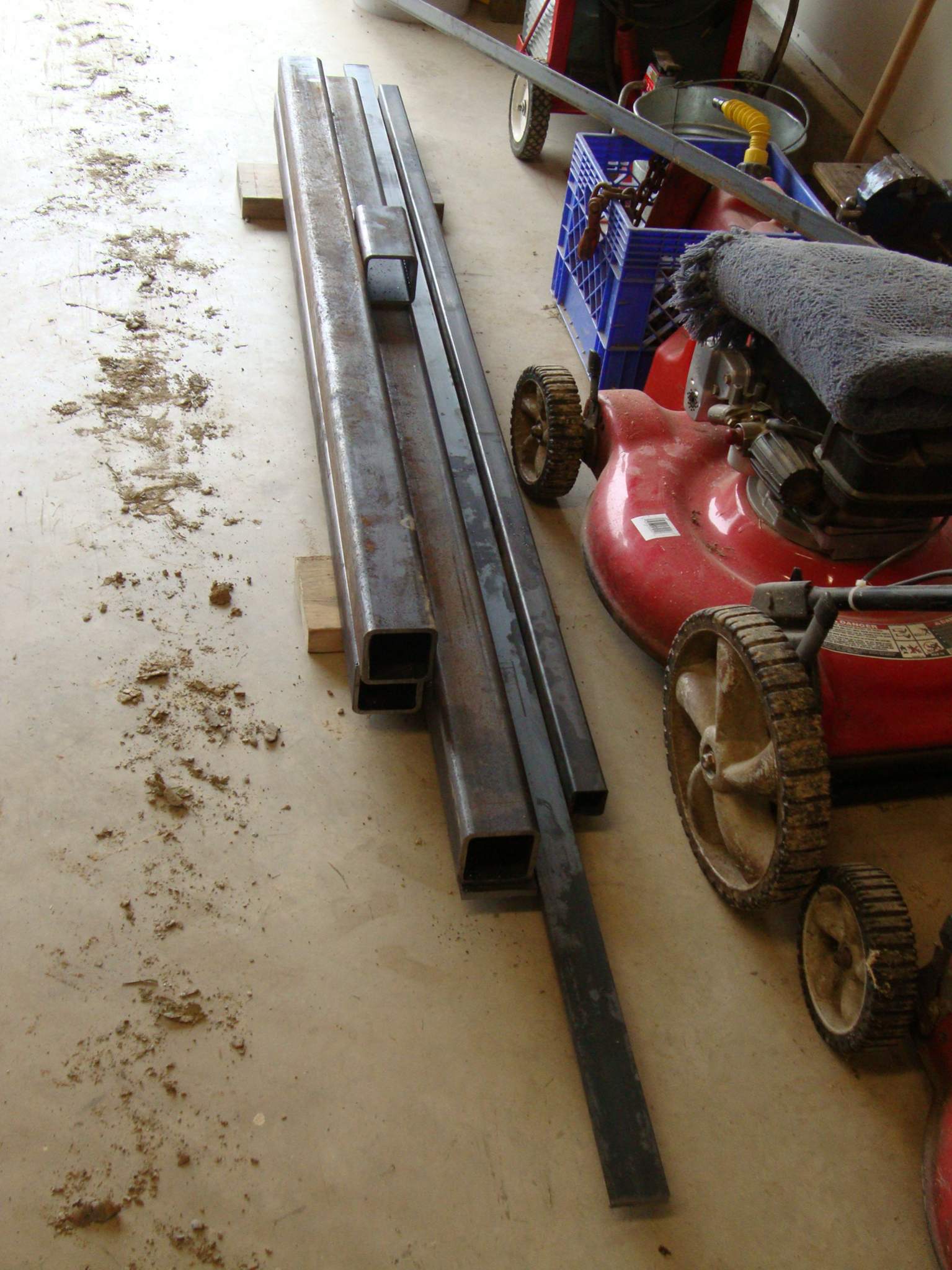

I bought a bit of steel yesterday to get started, and although it hasn't been that long since I did that, the price still shocked me.. nothing is getting any cheaper, it seems.
I'll post as the job goes along, it'll likely take a few weeks as the weather allows, not to mention the time factor. What with building a barn this summer, seeing these sitting there waiting for attention has been gnawing at me.

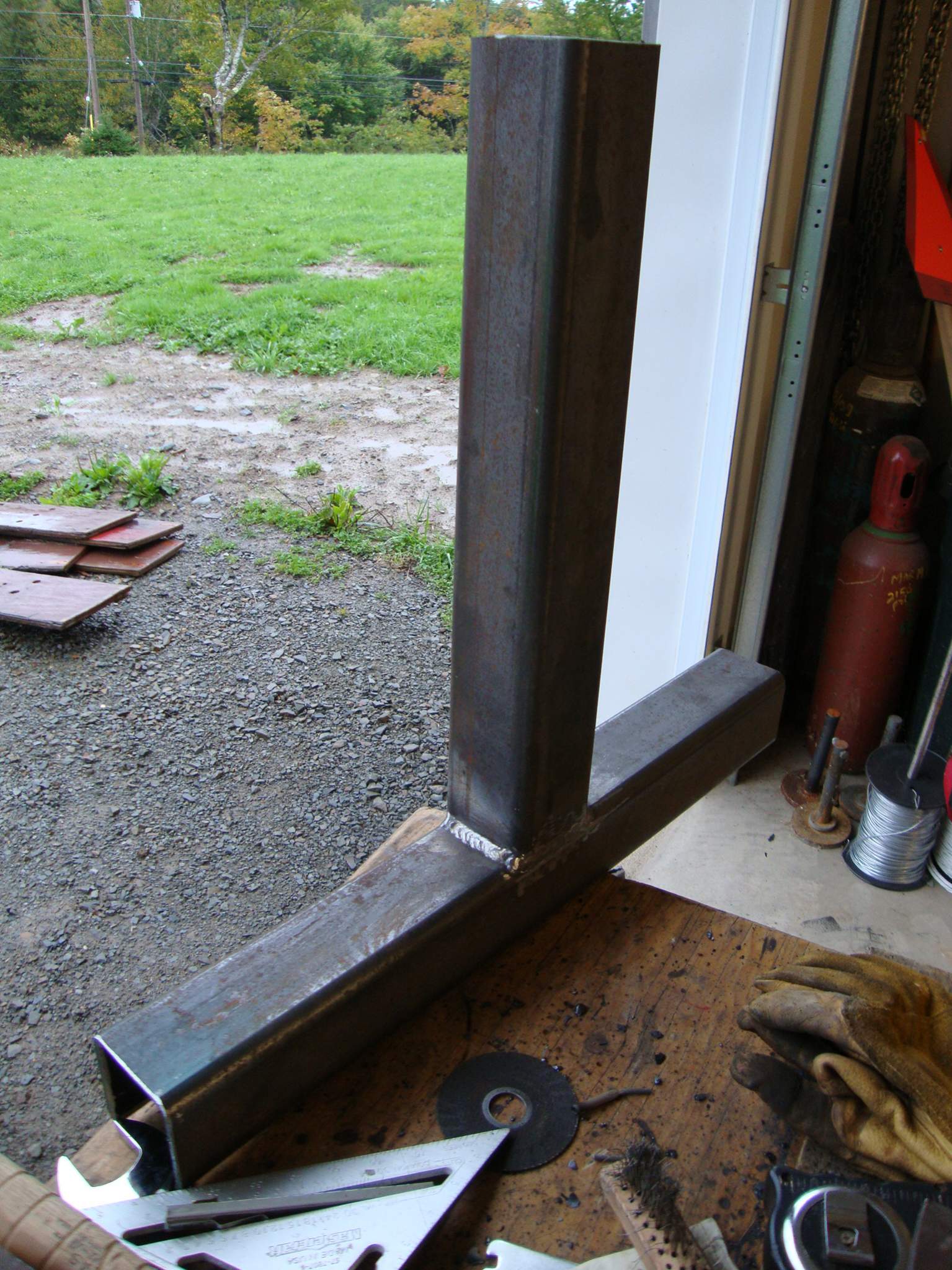

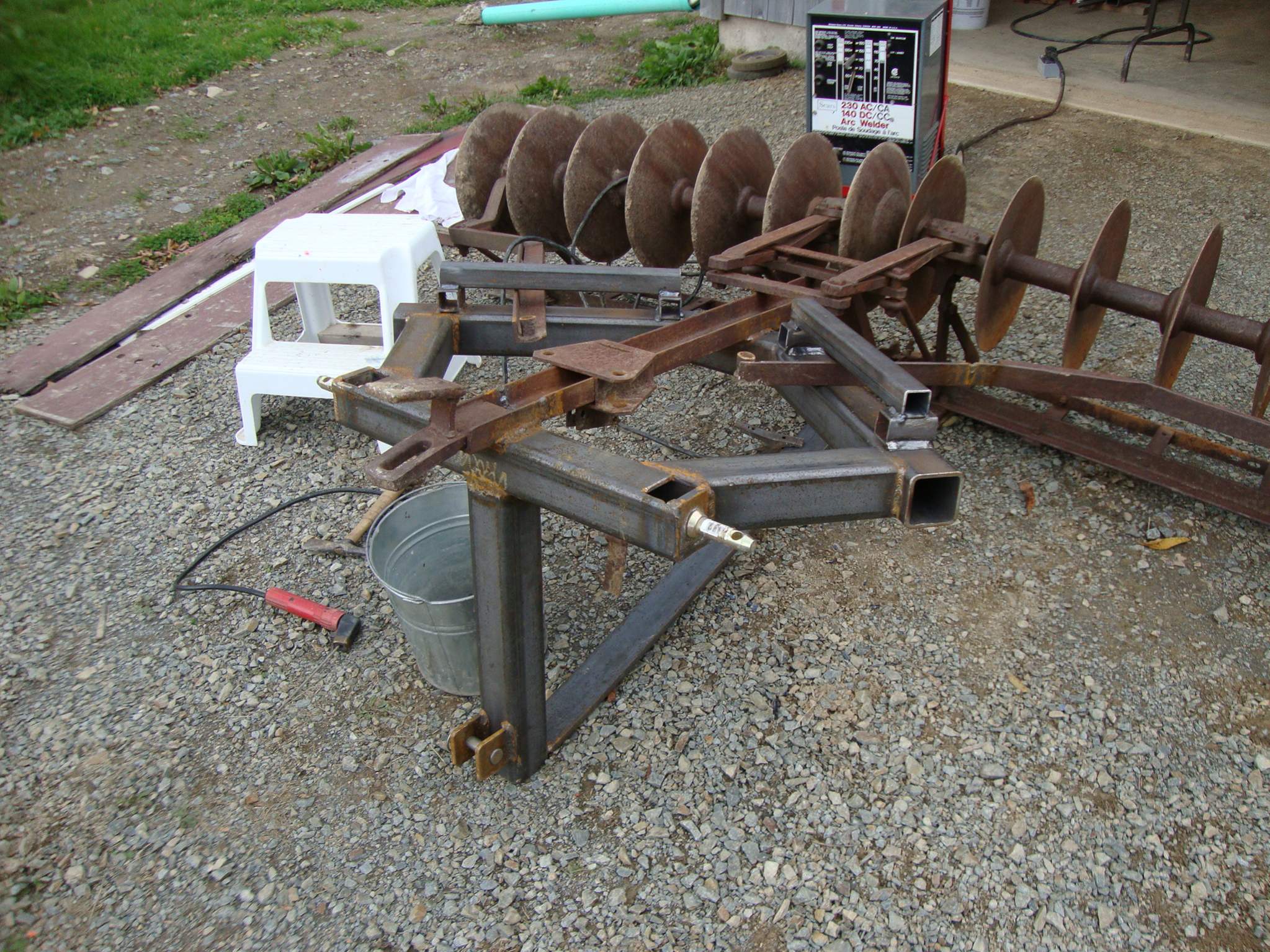

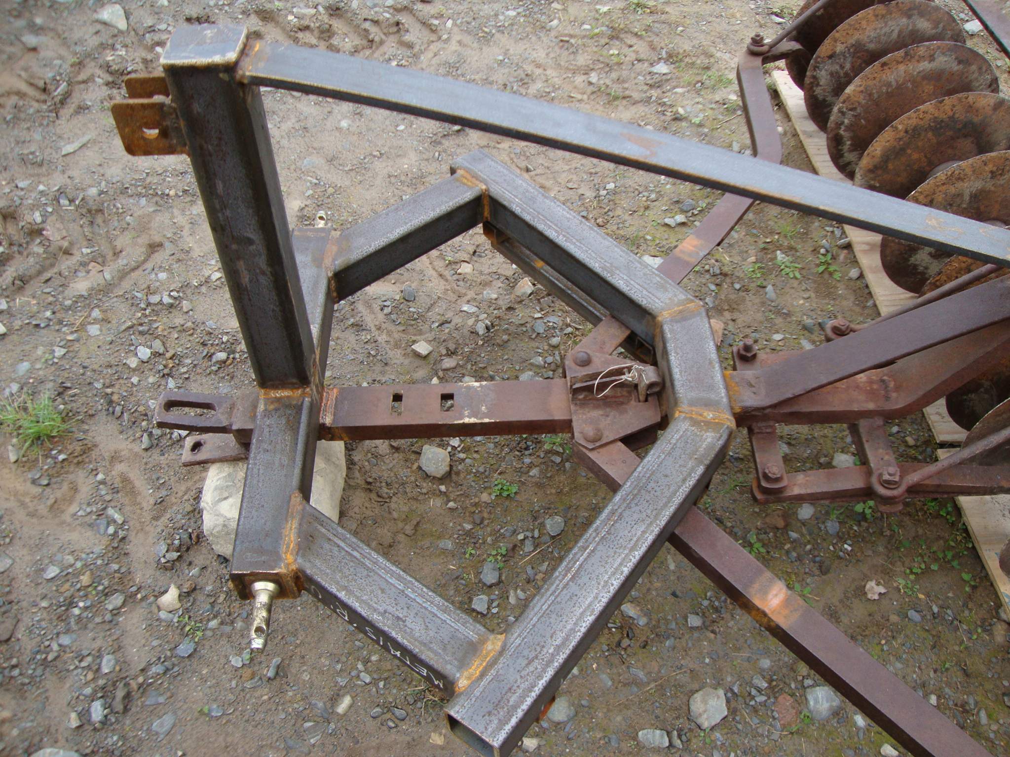

Yesterday I cut the 3-point cross tube and top link post, then welded them in place. The pins for the 3-point hitch will be bolted through pieces of 1/2 inch steel welded inside the ends of the cross tube. I used 3 inch square tube with a 1/4 inch wall thickness. Probably overkill, but I really doubt I'll bend it.
The only way to tighten the bolts is to cut an access hole in the bottom of the cross tube big enough to get a box-end wrench on the ends of the pins. I thought briefly about simply welding the pins in place. Very briefly. I'd like to be able to remove and replace them if necessary without grinding and re-welding.
The next step is to get the end caps cut to size and the 7/8 holes cut, then weld them in place and install the pins. I also need to decide what size to make the fork for the top link post.

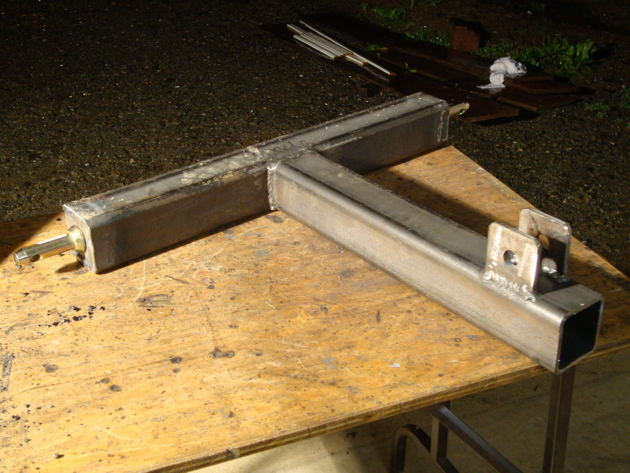

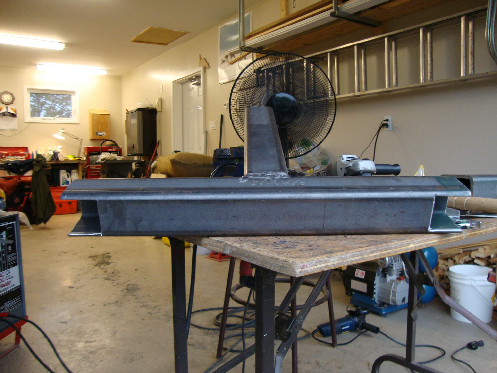

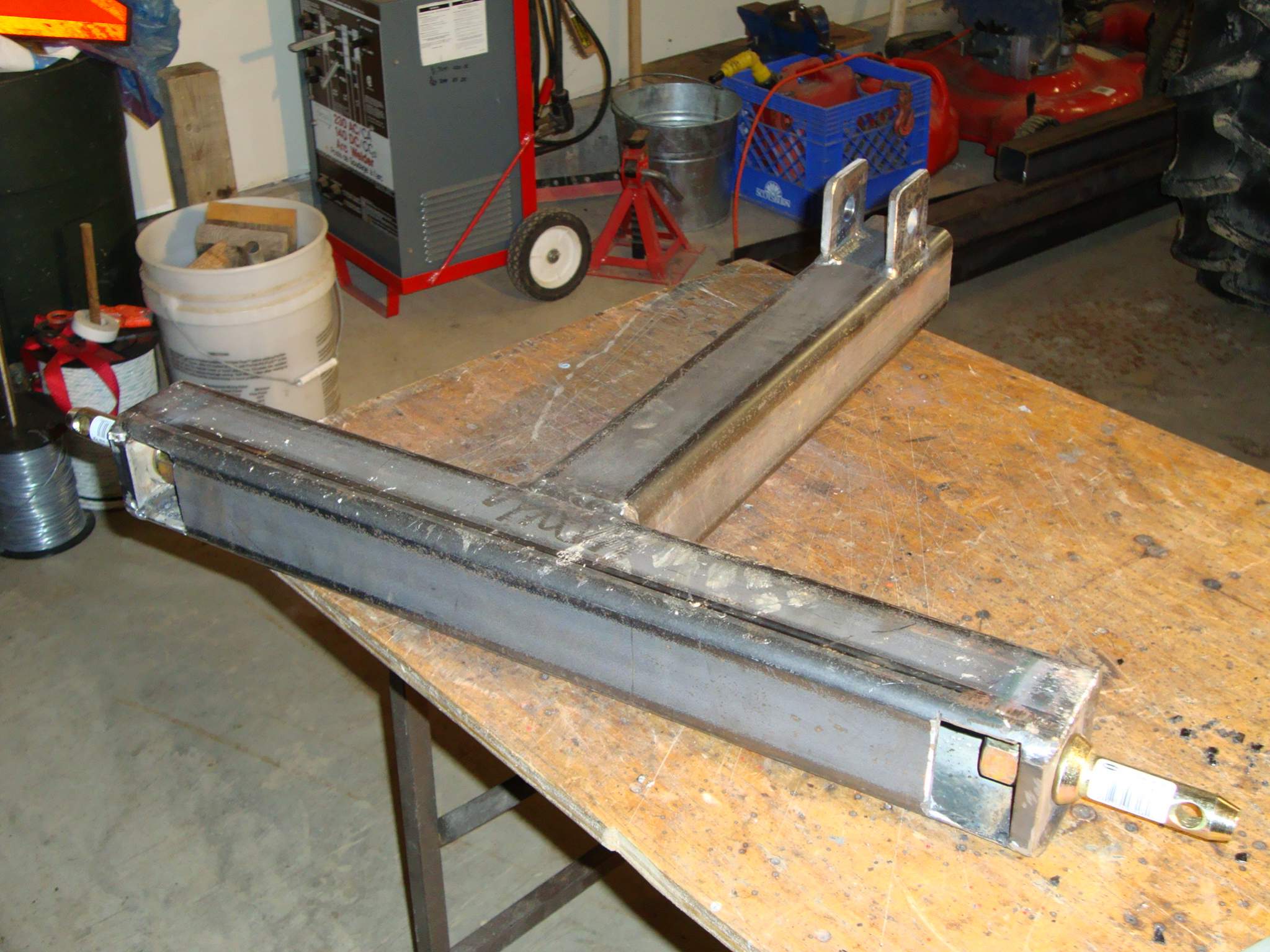

I got the end caps and top link forks welded in place and the holes cut.
The Cat 1 pins were a little longer than I needed on the threaded ends, so they got shortened by about an inch.
I doubt I'll get much more done until the rain stops and I can work outside again. Ophelia has been pretty generous with rain.

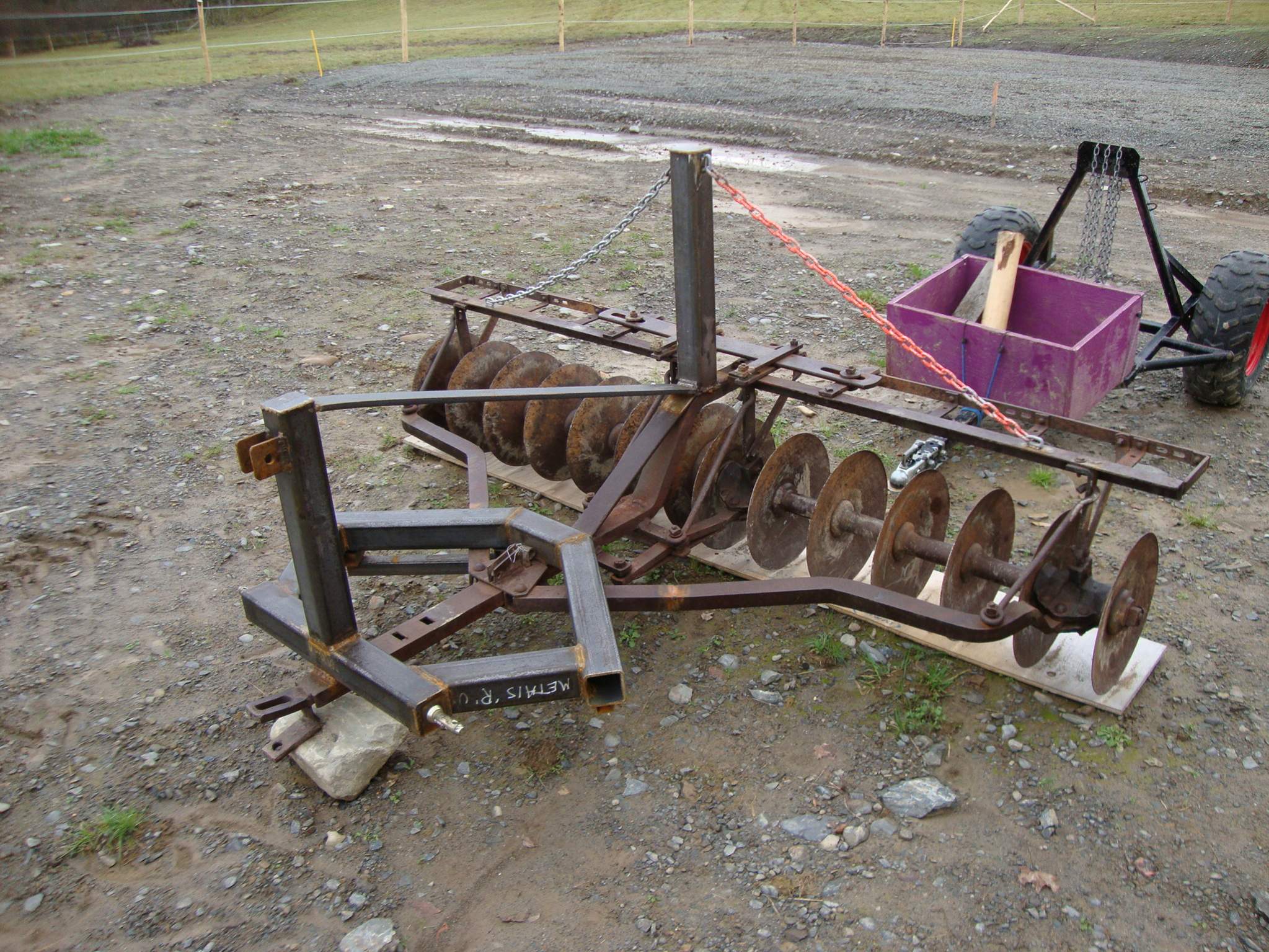

It's done except for paint... too wet here to really try it out, so it'll have to wait for spring.
I did end up shortening the frame by about 15 inches, the Kubota wasn't really happy about lifting it... no problems at all now.
The frame is designed to lend stiffness to the harrow while it's being moved, the adjustment rails on the sides are free to move back and forth, sandwiched between the main frame and the lower supports. The top strap is 1/2 x 3 flat bar to carry the weight on the 3 point.
I added the rear post and stay chains for those big bumps you just don't see coming going across a field or down the road.
Sean
