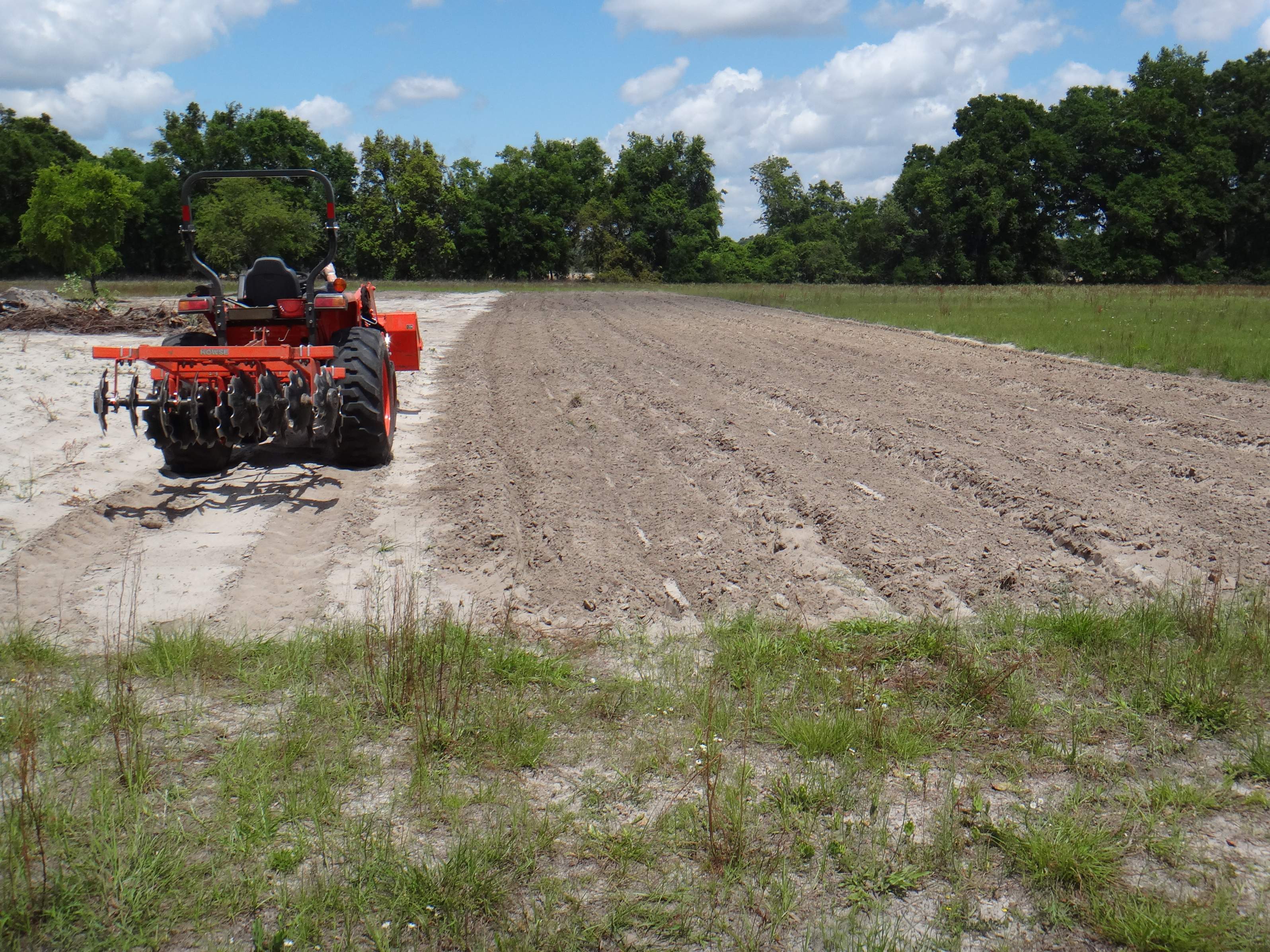

I made this 5 footer last year for my gardens. I prefer mounted for tight spaces. What tractor do you have? Does it have a remote hydraulic outlet? The 3 point is probably a little cheaper, too, since there is no hydraulic cylinder, running gear, or actuator.

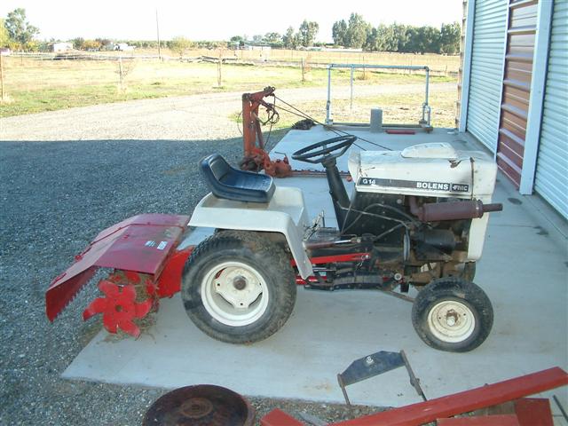

I used a middle buster and a used $350 48" Yanmar RS1200 rototiller when I installed landscaping on my new house. That's the way to go for a 2640 sq ft garden (about 0.06 acre). Forget about the disc. Get a rototiller and have at it.
For garden work I use an old $600 Bolens GT1453 garden tractor with a 33" wide rototiller.
Good luck.

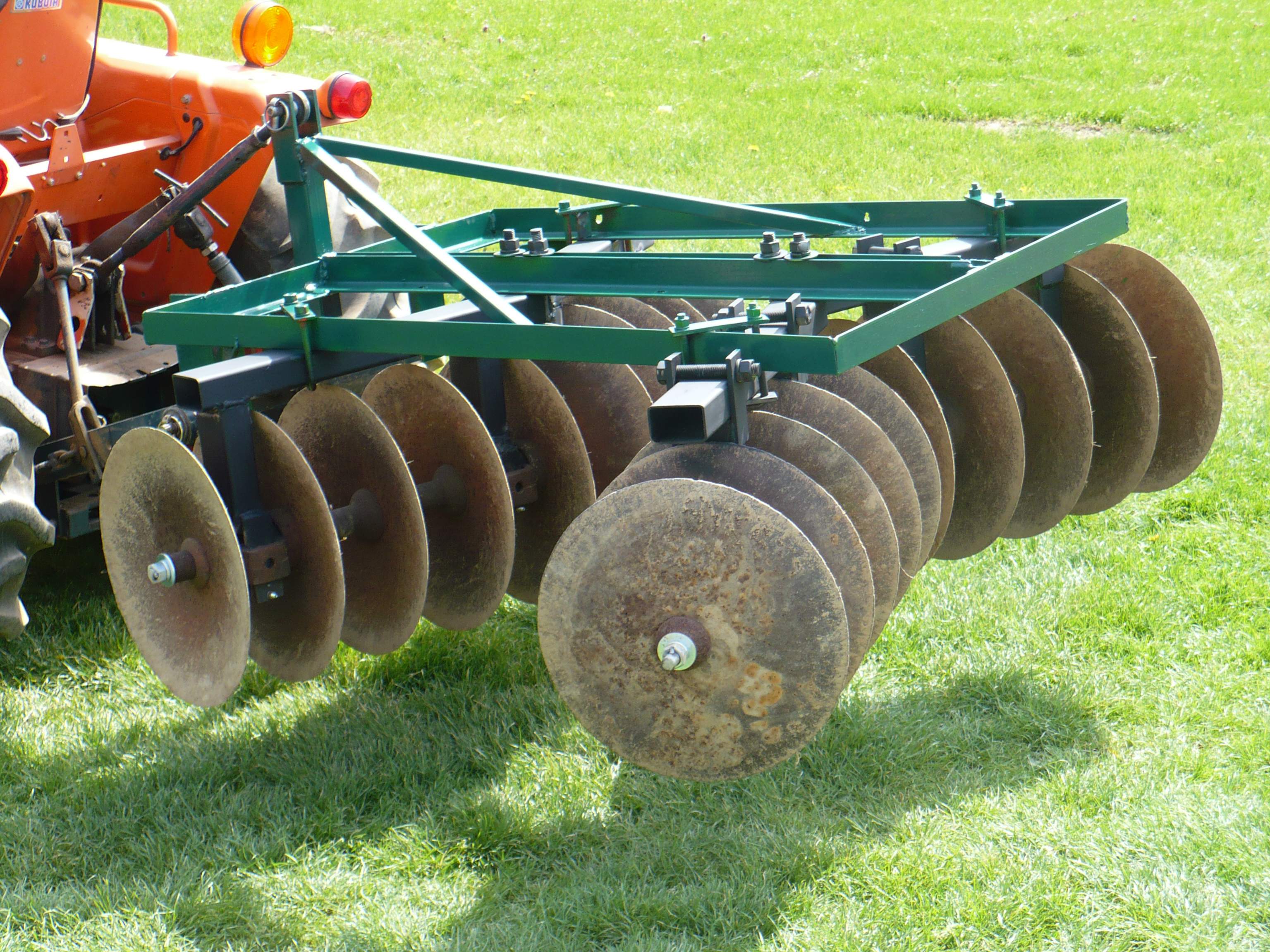

These aren't easy to find used, but they're still being sold new at farm stores like TSC, etc.
I was fortunate to find a solid, used one. This one is heavy, heavy, which is what I preferred. Best implement ever.

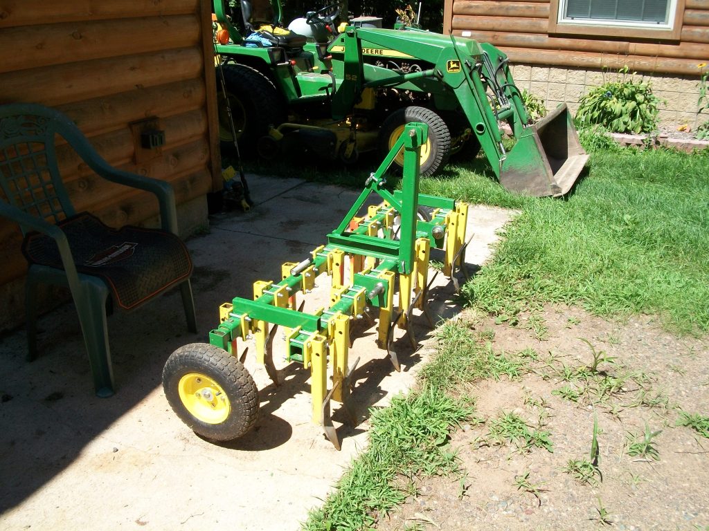

I built this 5' tool bar a couple years ago....
The wheels will adjust to let it dig 1.5" to 6.5" deep... All the teeth are removable and adjustable for spacing as needed to dig, or cultivate...
I use it with another tool to maintain my gravel drive also..
It weights about 350# depending on set up... And I have about half the cost of a disk in materials, hardware, and paint...
Plus the row hiller blades I built for it.... Thatch rake frame...
I can't/don't garden this rock pile, but have done wildlife food plots more than adequately, and garden spots for other....
And it is a more than once a year, one use tool...
Good luck
Maybe something like this will be useful at different times of the garden season.... Combined with a tiller...
