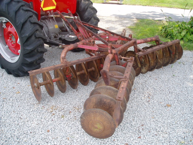

Mainly, the amount of HP/weight it takes to pull them. Offset disc's are primary tillage tools. They are usually heavy. They're made to dig deep. A tractor that would pull a 10' tandem disc might struggle with a 7' offset.
A good friend who runs an apple and peach orchard uses an offset disc behind a 255 Massey Ferguson. It's a 7'er. He uses the wheels to "gauge" the disc so it doesn't dig too deep. His 255 is 52 HP I believe. If he lets the disc drop all the way down, it'll stop the 255 in its tracks.

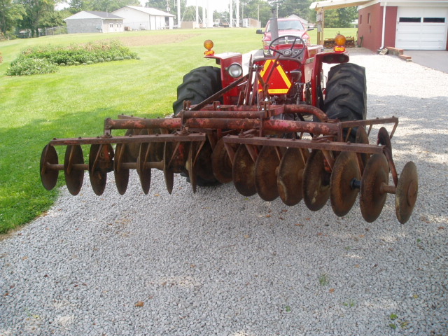

Back when the 135 was still in production, they sold like hotcakes here in Kentucky. (Apparently they sold well EVERYWHERE) Ky and Tenn. has always been a hot area for Massey's. When the 135 came on the scene, they were replacing a mix-match of small tractors from the 40's and 50's. A lot of farmers bought a new plow with their 135, and would use their existing disc. I've seen thousands of 135's pulling old pull-type "drag disc's". (The kind without wheels) They would handle a 6' , 7', even a few 8'ers with relative ease here in clay country. Dad had a TO-35, then an F-40 Ferguson, finally a 150 MF. He used an old IH 7' drag disc right up until the day he quit working his place.
I use a bigger disc behind my 150 than is common practice. (If you're not familiar with 150 Massey's, they're a 135 on steriods. Same engine, same tranny, longer wheel base, same front end as a 165, larger radiator, 165 dry air cleaner, bigger fuel tank, much better steering, more weight all of which is on the front end) Last new rubber on the 150 is a size wider than stock, and I've got it weighted, plus the pump has been turned up to 47 HP (pto). It handles the 9-1/2' lift disc just fine NOW. It wouldn't have done that in it's original state.
The 135, especially the diesels, were powered beyond their traction capabilities. (Which is better than the opposite) I'd imagine in sandy or loose ground that would be exagerated even more so.
I've just never been real impressed with the performance of a 3-point disc. I just recently bought the #25 Massey disc I have now. It's about as good as a 3-point disc gets, but is still no match for the IH wheel disc I have. Just takes more tractor to pull the IH.
