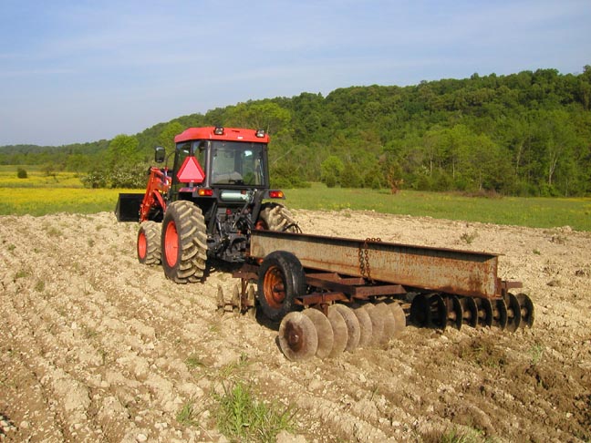

I'm pulling a 10 ft disc using a 45 hp tractor with no problem.

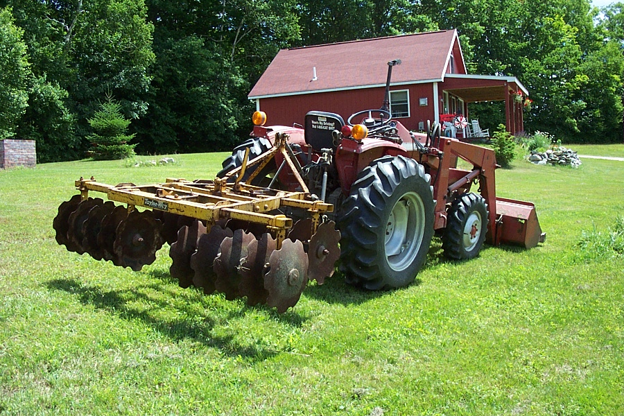

Mornin Zkubota,
I agree with the others, your 4400 should pull 6-9 ft harrow no problem. My Massey 1040 , 3800 without the loader pulls this Taylor Way 7 ft harrow no problem. I have only played around with this harrow mainly because I have a few more things to fix on it but its a good match IMO !

@oleozz
Rarely have I seen a more aesthetically pleasing and proportional weight than your chained-on 10' (12'?) section of I-beam.
Nice......:)

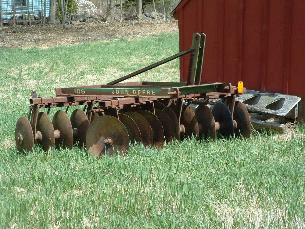

if you're just looking to keep the mx track "groomed" then i would go w/ a med or light duty disc. i think a heavy duty w/ the extra weight may cut too deep and you would have a very soft track. w/ a med duty you can always add the extra weight if needed. i have a jd105 disc 6ft which i pull w/ my 790 it handles it well in most conditions but when its a bit wet or heavy soil i def need 4wdm and could use a bit more weight on the tractor.
