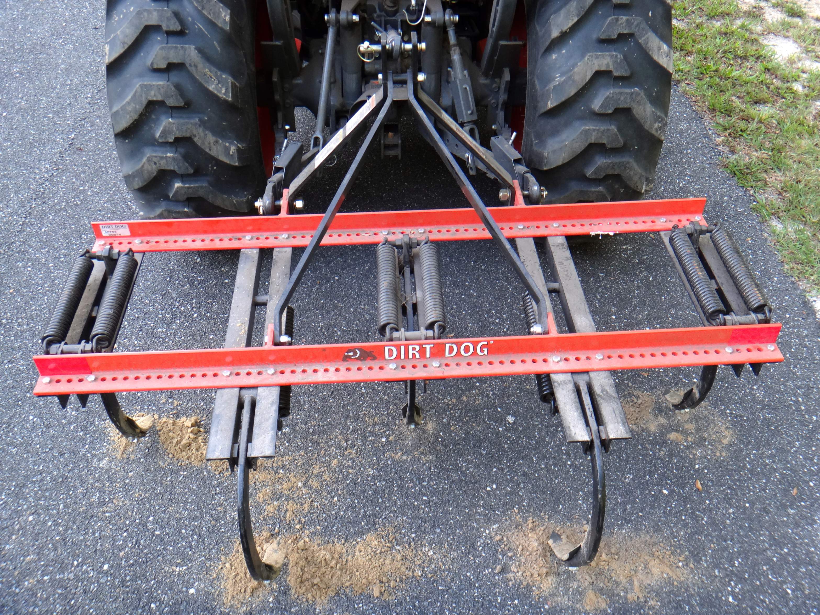

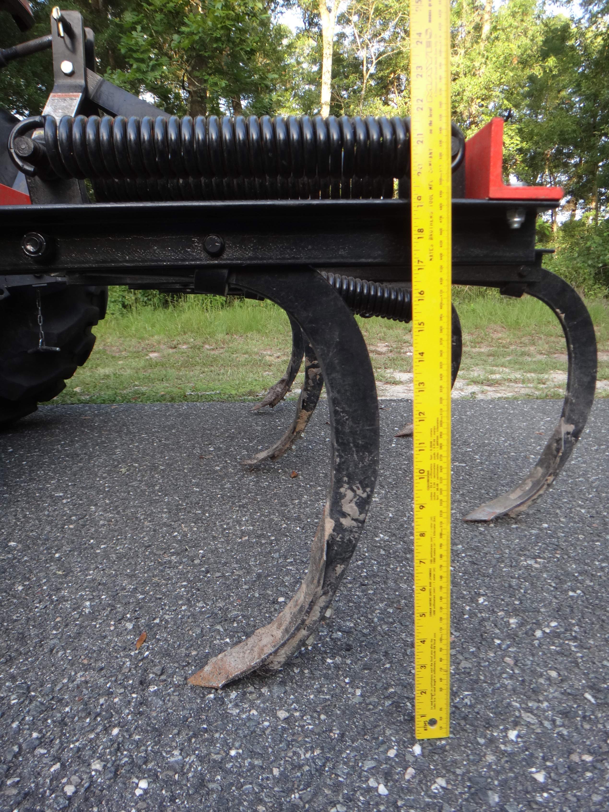

Photos: Dirt Dog (brand) APP/Field Cultivator aerating Bahia pasture, growing on Florida sandy-loam.
VIDEO: Cultivator/Ripper - YouTube
