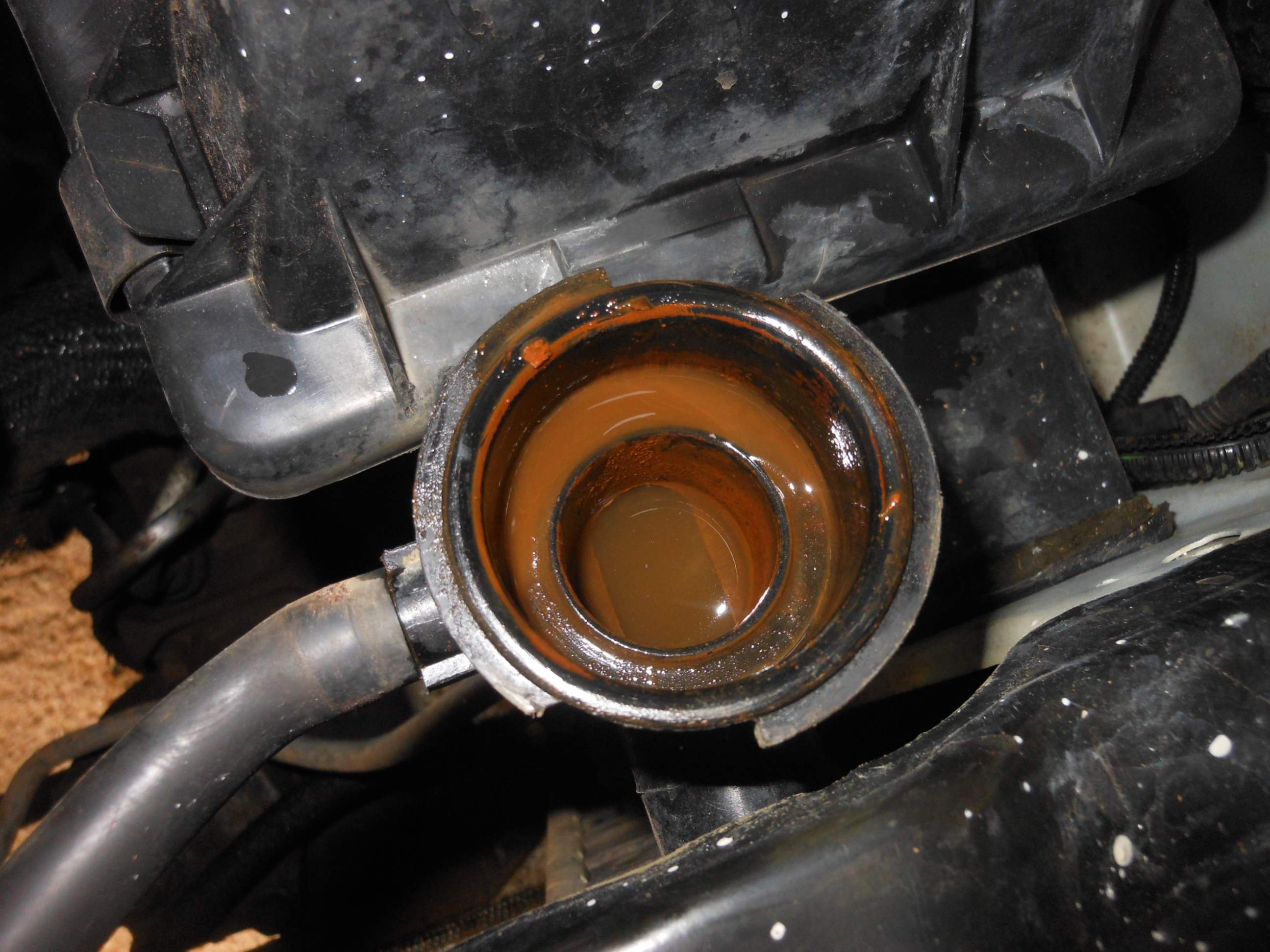

It ran perfectly for just under an hour before coughing and spluttering and then it stopped completely. The radiator cap was gone and I wish I knew how I could check the whole machine but overlook a missing radiator cap but in this case it seems as though I did just that.
It had very little coolant left so I drained the remainder and it was a very unhealthy brown colour which makes me suspect that I've blown a head gasket (it overheated no doubt due to the missing cap and subsequently low coolant.

An evaporated radiator is going to have that evil brownish fluid at the end because that's the color the coolant changes to once you've reached maximum condensation and concentration. As long as there's no oil in the coolant, no water in the oil, and your tractor starts normally after refilling the radiator; count yourself very lucky. Run it for a couple of minutes and then recheck the coolant. Do the check again at 10, 20, and 30 minutes, watching the engine temp all the time. If everything is nominal, then you're probably good to go. Otherwise.... well, either you have a problem with the cooling system, or you've blown your seals and you're looking at good sized repair bill.

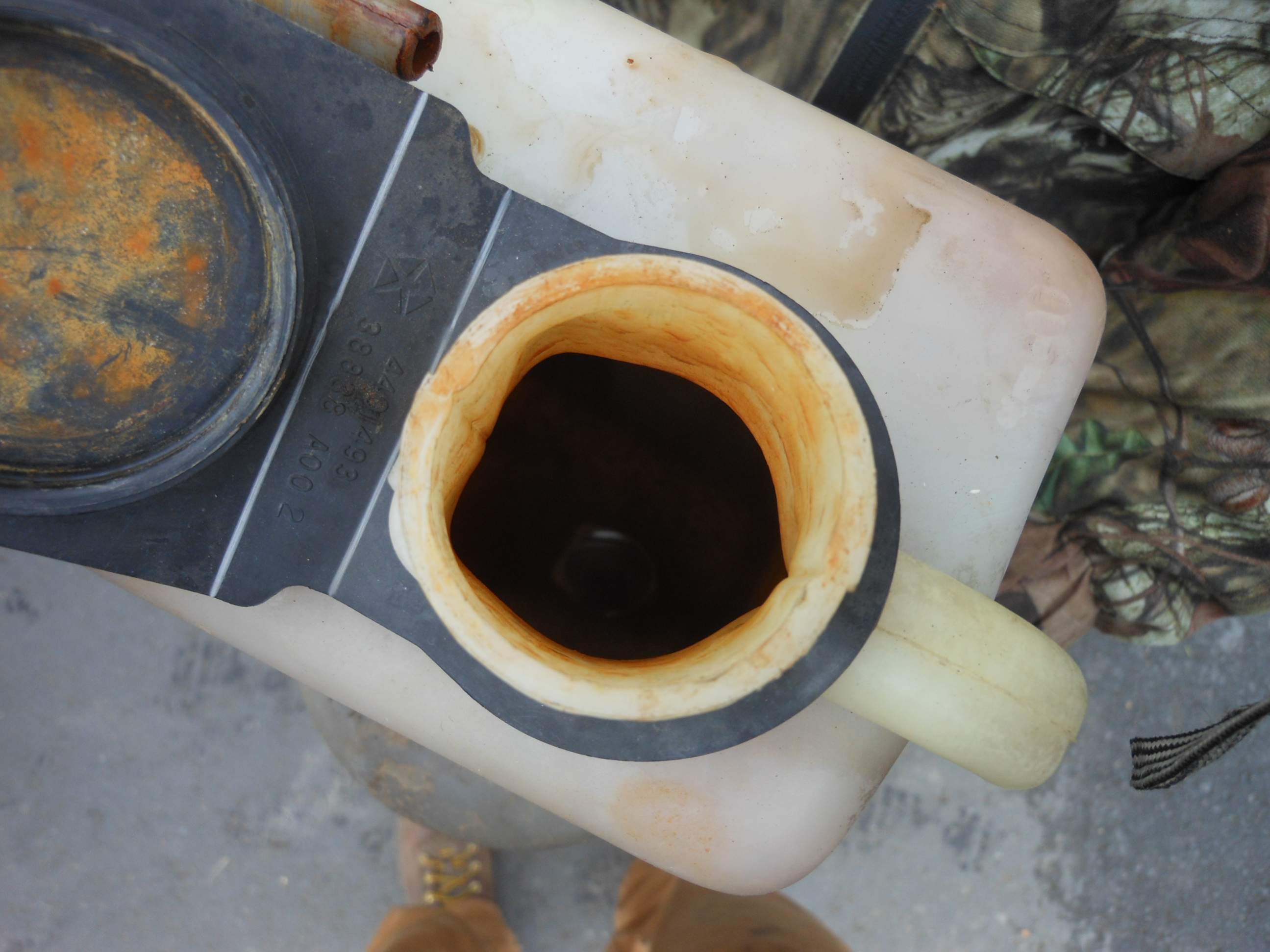

I tried commercial products to flush with no good cleaning. I got info from this site to use Cascade dish powder and the results were great. It stopped overheating.
Like you, when I got the tractor, water was brown and found out (again on this site) that typical filling of the radiator in the rice fields was from the water available, the rice fields. It's been 2 years since using the Cascade and no overheating.
