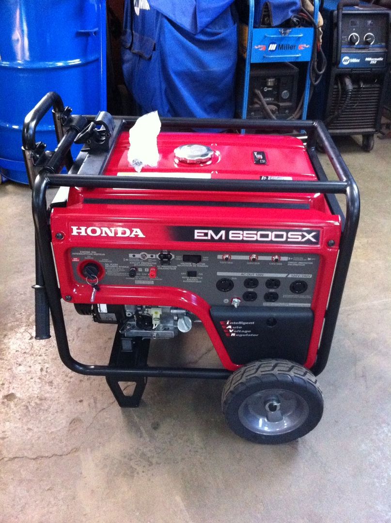

I could have bought a Champion for around $900. last year but instead paid $3000. for a Honda 6500 and yes it was a little pricey but I'll get a part for it easily for the next twenty years at my local Honda dealership if needed but I truly doubt I'll need any parts.
In the early 90's I worked as a Honda power equipment tech and even back then I didn't see many " natural" issues with the Honda product. The issues I seen were "man made". I'm sorry to hear about your issues. They didn't treat you right. I sure don't have any confidence in Champions or the other 50 plus Chinese built generators that on the market.

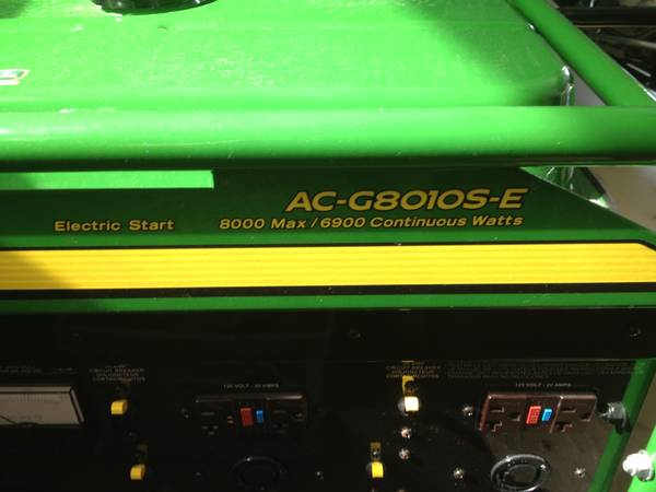

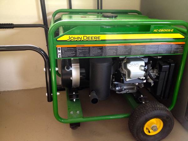

I got a whopping 2 hr.s on this one , original owner paid almost $2400 for it and then sold his house month or so later to move up north. Didn't want to take it. I bought it off him for $1200, Subaru mtr.Unit has E-start and recoil . I know Honda makes a kick butt unit but felt like I did well.
