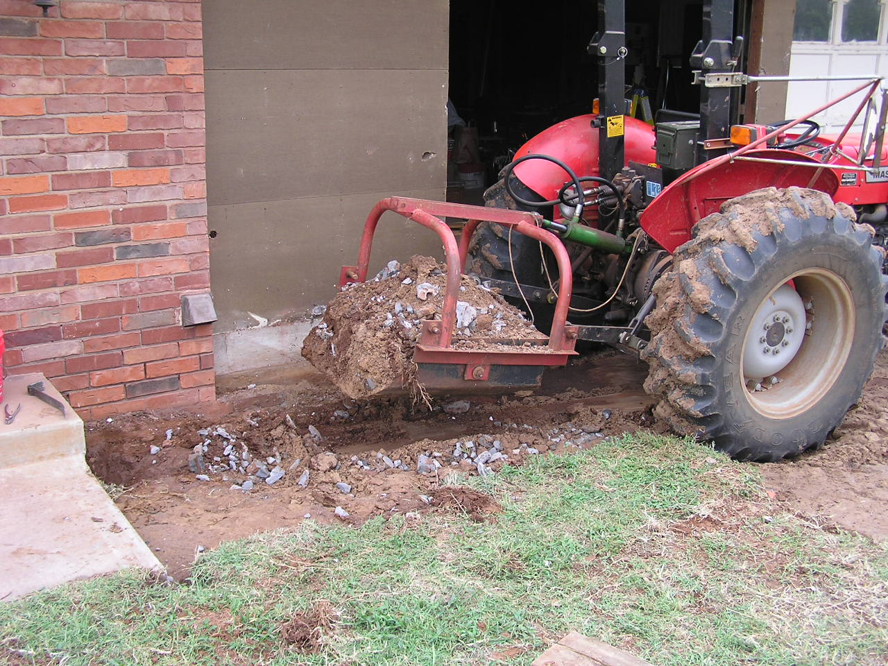

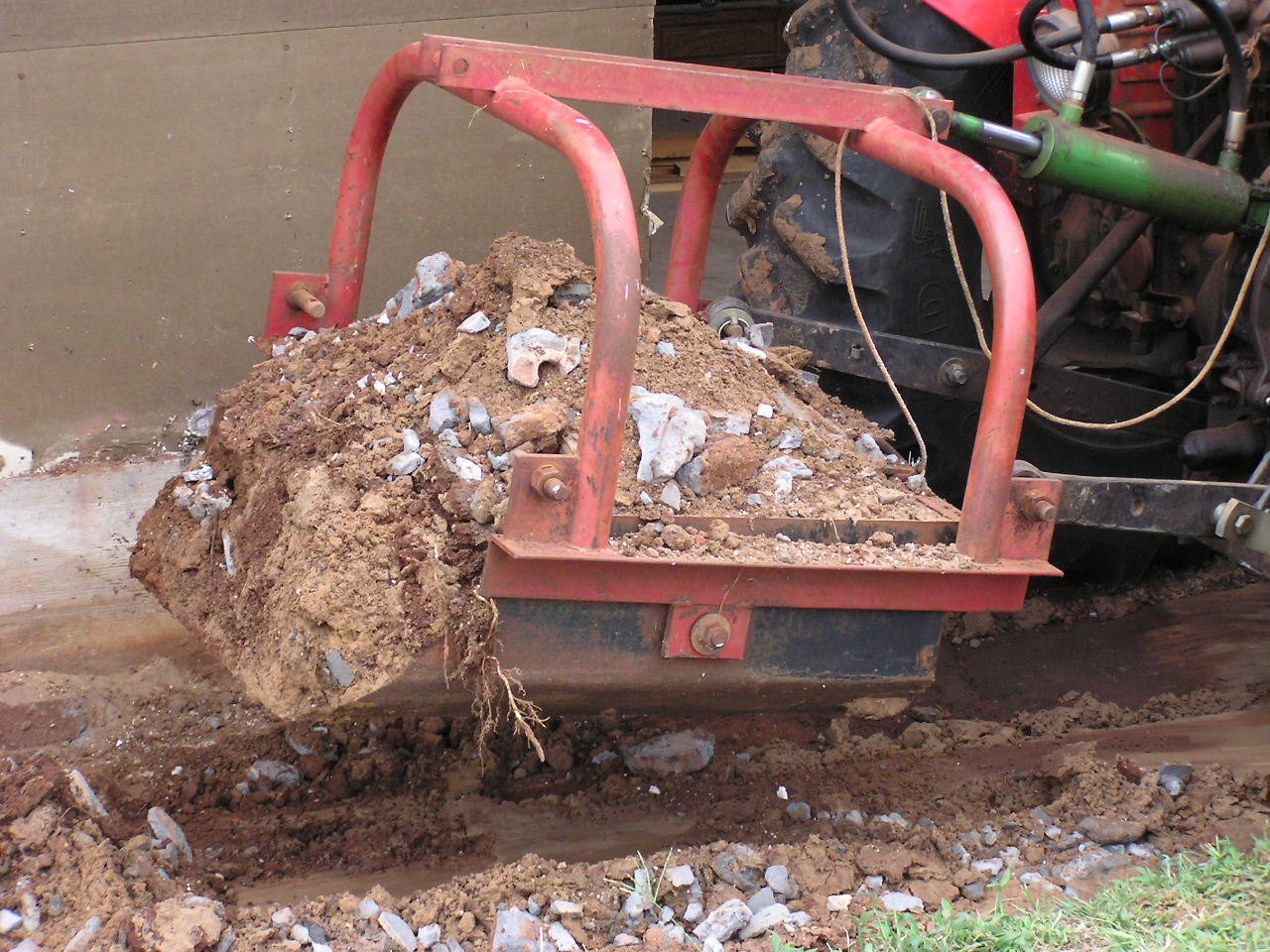

I had a 36" wide, cat 2 back in 2004. The hydraulic top link makes it work much better!
No FEL on the tractor.

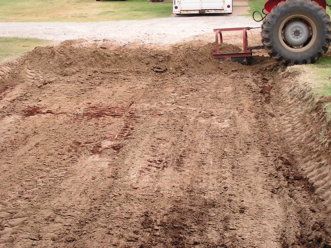

I have a 24" and a 30" dirt scoop (pond scoop?). The 24 came along when all I had was a Ford 1100 and it worked ok, except the tractor was a little bit low for it. The pins really needed to be lowered so the tractor could pick it up further for dumping. A friend had a 30" that looked new, except it had a rusted out bucket (from sitting in the dirt with water in it). I took a piece of 3/16" plate and made a new bucket. It really turned out pretty well, considering all I used was a torch, a welder and a chain fall to build it. My sheet metal brake won't do 3/16 and I wanted it to last, so I did it the old fashioned way. The 30" worked fine, but the main thing it was used for is digging out a ditch alongside a roadway that gets filled with sand from run-off. I just straddle the road with the tractor and run down it till the bucket is full, then go empty and spread it back on the roadway. Since I purchased another tractor with a loader, I haven't used either of them enough to justify them, but they don't eat much, so I keep them out back.

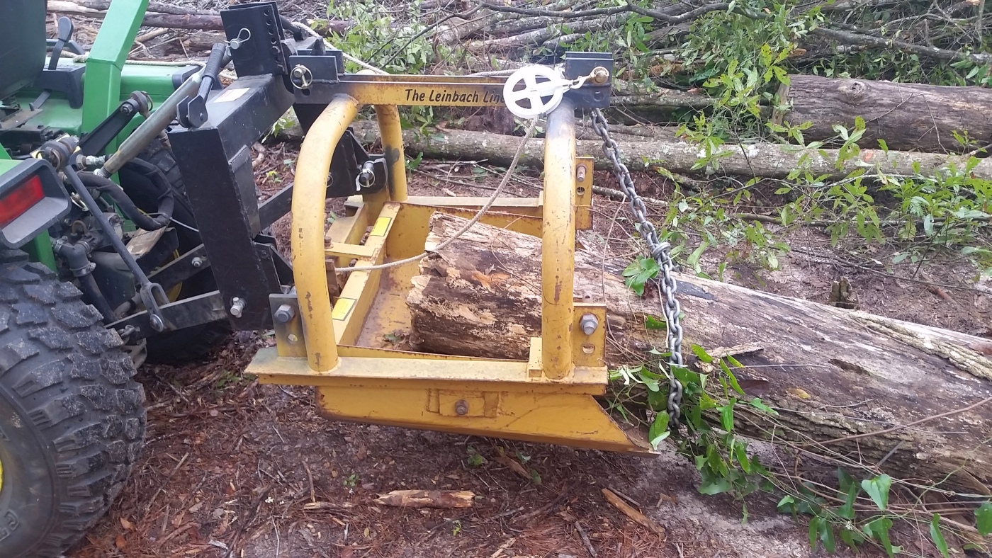

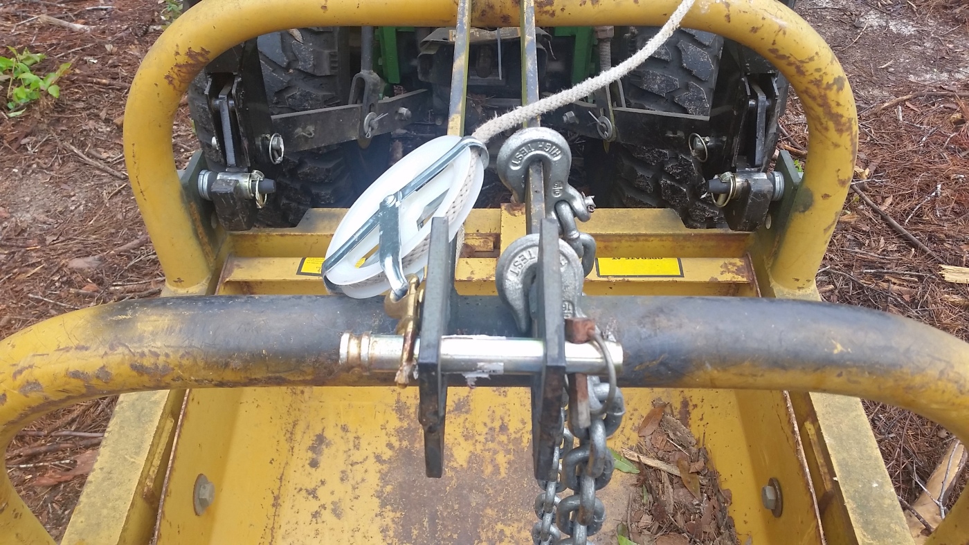

I had an old Leinbach I used more for skidding logs than I did for digging. I put a pulley on the release rope that made it easier to operate.
