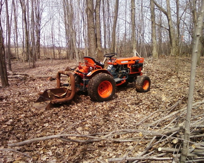

I'll agree with ninefinger here. $100 on Craigslist. I posted in the wanted section instead of waiting around for one to be listed, got multiple responses that day.
I'm finding it very useful as a tool carrier, wood carrier, sod scraper, etc.
YouTube - Removing Sod To Prepare For New Garden silly video.
