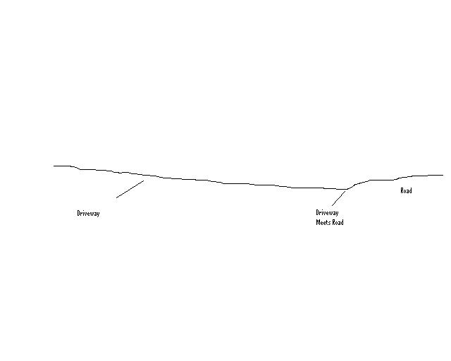

I've got a driveway that is about a quater mile long. It goes up a gradual slope for about 900 feet (pretty much 90 degrees to the contour, e.g., very little left/right grade, a miniscule amount of grade), then makes a 90 degree turn up to the house for the other ~300 feet. There is a shallow ditch on the right of the first 900 feet. The driveway is mostly dirt, with some stone left, although a lot of it has been "plowed" away or is in the hard earth.
I've attached a crude drawing of what the cross-section of the driveway looks like. The bottom line is, the crown is about gone, the shoulders are higher than the crown, and you can see obvious wheel ruts. The result is, when it rains and melting snow, at least one massive rut has formed (near the bottom: the water slowly builds up from the top because it doesn't get off the road!). The second (Very) crude drawing shows a view looking at the bottom of the driveway (Where it meets the road), looking from the side. As you can see, the driveway is much lower than the road, resulting in puddle of standing water for weeks after a rain.
Hopefully, that gives you the context of my issues. Now I'm looking to fix all that. I've been searching the forum and found a lot of good tips, but I'm still wondering if I'm thinking the right things for "my" project. First, I have an 855 with a FEL, but that's it. From my researching and reading, I'm leaning towards the following: buying a box blade and fitting my 3-point hitch with a top and tilt (vs. the other leading candidate, a rear blade (and possibly the top and tilt)). If the box blade is the right thing, is there a way to do it without the top and tilt or is it far more worth fitting the topand tilt?
If that is indeed the right thing to do (probably pushing $1K btw from what I can tell), then I have a lot of follow up questions since I'm unfamiliar with hydraulics and top and tilt (but don't let that lean you towards getting someone else to do it ... i know i can figure it out, just need a place to start). But first off, maybe I should leave it at the above so I can settle on the general approach before delving into that.
Thanks in advance!!
The more places the water can get off the road the better. I have a slight cut and rise to get the water off and I have practally no washing thus no maintainience.

If you have money to burn, get TnT, it saves time and energy getting on and off the tractor to adjust the blade/BB (but you don't have too.) I would put that money into a good blade and lots of gravel. I'm assuming the view you posted is of the side, I would cut the driveway and fill in the low spot where the water stands. Cut a ditch along side of the driveway and put the dirt on top of the driveway to build it up (make the crown so water will run off the road and into the ditches. Do you have drainage problems, or do you have a place for the water to run off?

teg - I do have drainage problems in that the water does not properly get off the driveway and accumulates: by the time you get towards the bottom of the driveway, streams have formed. There is a ditch already cut on one side of the driveway.
the rest - It looks like you recommend using stone rather than filling in with dirt. Do I have that right? My follow-up question to that is, we get a lot of snow: if I have that much stone, won't I plow it all away come winter?
Also, the shoulders are now generally higher than the driveway, meaning, even if I get the crown rebuilt, the water wouldn't be able to get over the shoulder and off. Should I use the box blade to cut down the shoulders? If so, the plan would be to use the box blade (would a rear blade be able to cut through this stuff, the driveway is pretty hard/packed?), break up all of the driveway (forgot to mention i have 15-20 3-4" potholes also), cut the shoulders down and move everything towards the center so there is a true crown all the way to the ditch on one side and to the slight slope on the other.

I had similar issues with a road that I maintain. Over the years we have tried to add gravel to get the road higher than the shoulders. Once you do that you can finally have a place to shed water, else the road becomes a drainage ditch!
If you have access in your area to different types of gravel then build up the road bed (over time if budget requires) with larger aggregate but then always add several inches of good "road gravel" - such as 3/4" and smaller. With the top coat of finer gravel you can work your crowns AND you are less likely to grade up big rocks later.
I have to agree with the others, that box scraper may be best for you for now. I use a landscape rake with a flip down blade for my road and it works great. But that setup is no good for ripping into hard packed road bed. Once you have the road under control, so to speak, a back blade or a setup like mine works great for semi-annual maintenance.
