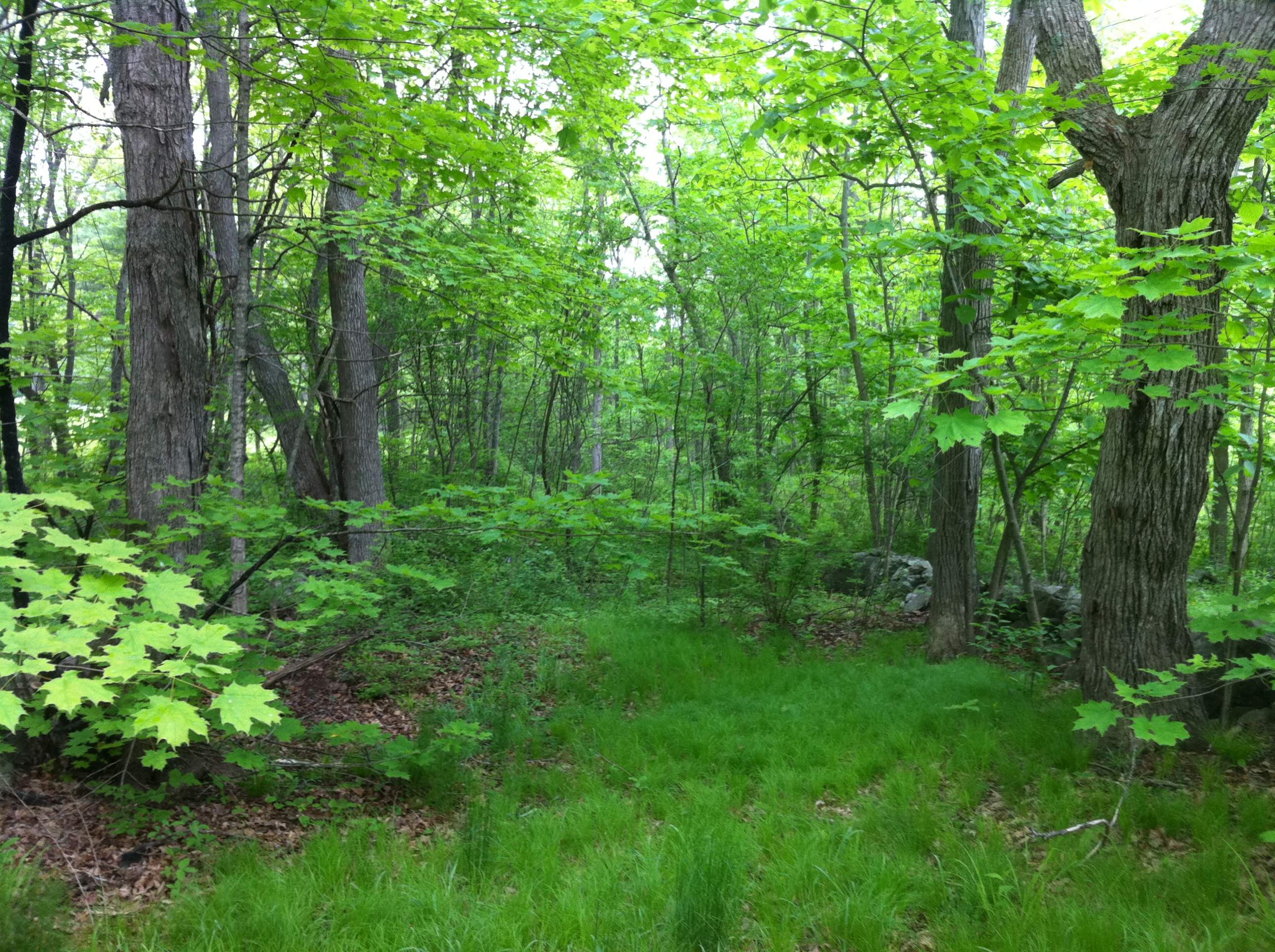

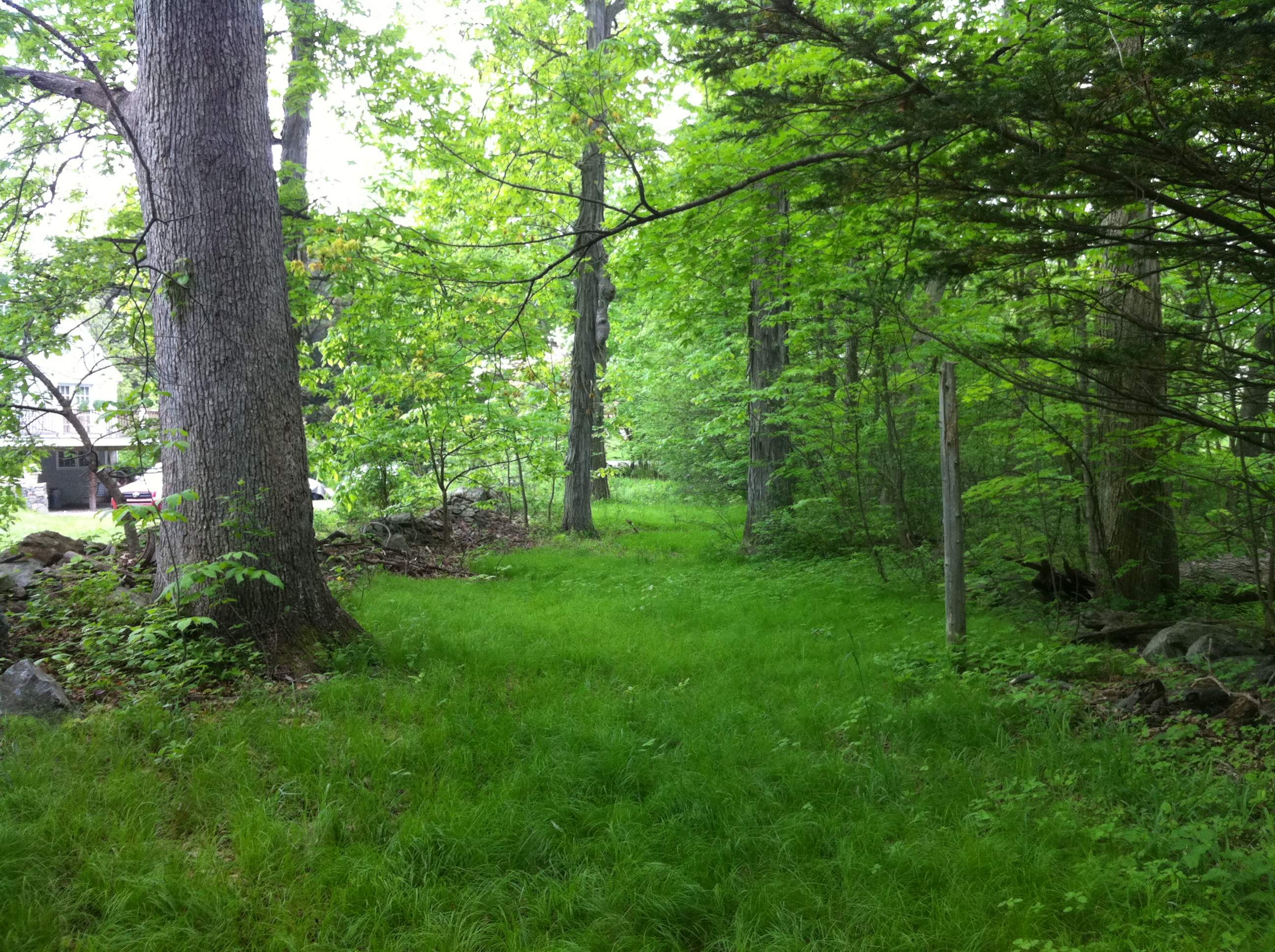

Here are two pics of the cart path in it's current state. The first pic is facing the front of the property. The second one is showing the path towards the back of the property and hence the overgrowth is more dense.

Box blade will do good for you, also the FEL (front end loader), On small areas, I use my FEL 99% of the time since it's always hooked up.
I had a long driveway one time that was natural dirt and rock, (caliche)((sp)), when I did get spots as you describe, I would bring in more of the same, but with as much gravel/rock as I could muster. The drive was 1/4 mile so it would have been expensive to top. Come to think of it I never did use my box blade on it, just the bucket on my bigger 140hp tractor, deeper holes I would fill half-way, compact, overfill and compact again.
I did have it graded twice professionally, A good operator can set most of the drainage and put a ridge in the road to push the water away very quickly and it looks good.
BTW, nice looking place you have, GREEN. From the second photo, I can't see anything an FEL and a shredder can't handle. again, I would leave the vegetation and drive on the short grass if I could.i

I also like the idea of just mow it and drive on it. That will tell you where the trouble spots are and what needs work without getting too crazy. You might find it sloped and packed well enough to be just fine as it is.
   / Dirt Driveway / Path #6
With regards to the green path area if you want it to be a dirt pathway you would typically need to take off the topsoil and work the path up from the subsoil. My concern on the path would be that you will hit many roots from the neighboring trees if you start taking away topsoil. In doing that you will injury the tree and possibly start a path to tree death. In a similar situation I used and air spade to clear around lateral roots and then made clean cuts and allowed to air dry(wound heal) for a couple of days. Good luck.

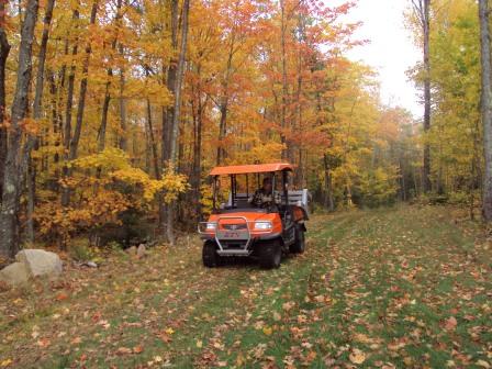

We maintain 45 miles of trails that are grass covered. When we put the trails in we try adress the drainage, but we prefer to maintain them with grass cover that is mowed. Not as muddy as dirt and looks better. We do not own a box blade or see the need for one for our trails/roads.
The roots are a real issue, the forest trees seem much more sensitive than a typical yard tree and nicking the roots or excessive compaction will kill the large trees over a few years.
