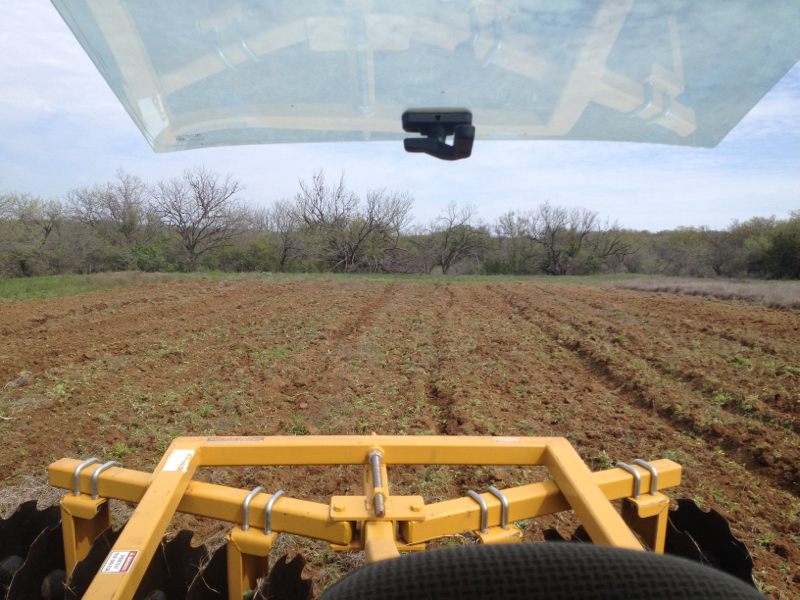

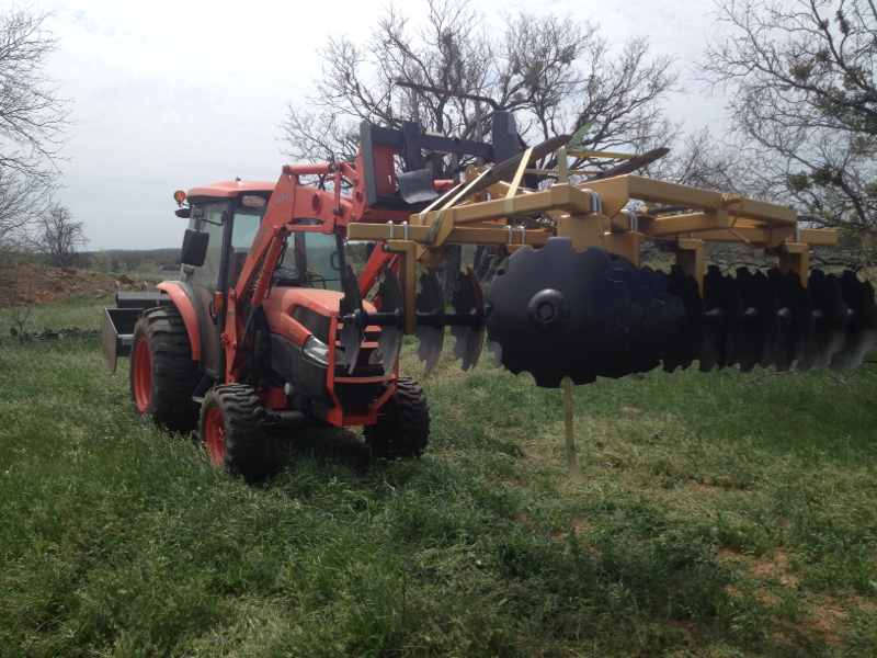

Well I only had a little time to play with it. Not quite a full review yet.
Unloading. Everyone likes a pallet fork pic. I could feel it for sure.
Getting ready to make a first pass
After one pass. I think my tilt cylinder needed to be shortened a little.
Here is a comparison of one pass (on the right) vs two passes (on the left) it did so well on the first pass you really couldn't see much difference.
After just a few minutes
Seemed to work very well for my setup tractor handled it beautifully.

Very nice. Looks like it did a great job. Looks like you have good sandy loam soil, and I'm sure that helps.
I wonder if ETA offers the option of a smaller diameter outside disc to reduce the furrowing that the full size outside disc causes.
   / Dirt Dog or Everything Attachments or ... disc? #10
Yeah, that might help. On my first pass I had the side link in float so it dug too much on one side as the ground was sloped.
It could be I pulled my rear gangs out too far or maybe I had it angled too much.
Need to spend more time with it.
