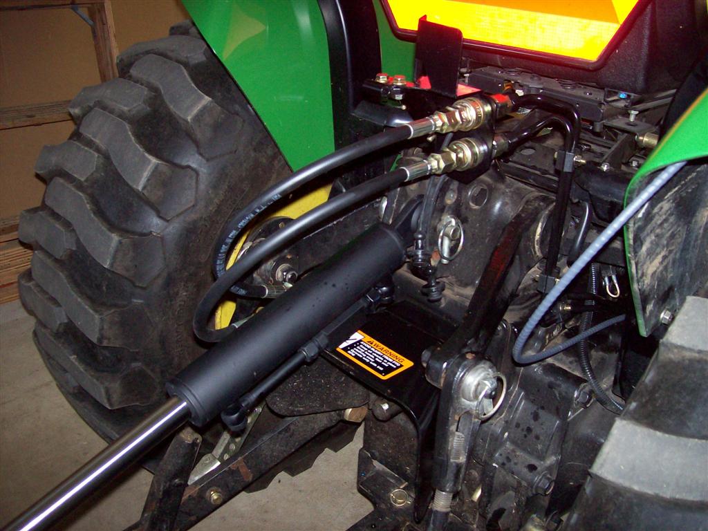

Anyone have the directions for installing the third SCV for a 4300? I just got this 4300 and they have the cable for the 3rd scv going out the rear of the fender and loped around the back of the tractor. I know this isn't right. It also doesn't seem to have the forward stroke on the lever that it should.
Also, does anyone know what length hydraulic top link I should get for this and the type of fitting I need? I'm not hime to measure the top link and haven't bought the bought the rear blade yet.

I can look for the directions that I used, but can pass on that I did not run the cable out through the right fender. I left it under the fender and around the rear. Had some concern that it would be in the way and get smashed with something, but hasn't bothered at all.
Here is a pic, of the cable and of the htl that I added.

oh, well that is pretty much how mine is ran except there i a hole in the fender that the cable runs through. I thought is was suposed to go forward from the control and then back to the rear of the tractor. i guess I was wrong.
