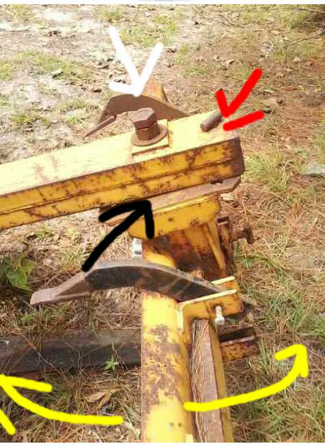

Looking at the picture of the blade from the side it appears that the blade itself will rotate 180° then fold the scarifiers down. That would put them in front of the cutting edge which is curved away from them. That would put all the weight of the blade on them as they cut and allow the blade to smoothly back blade right behind them. My speculation anyhow.

So it is a bit of an oddball with lots of stuff going on. That "pin storage" idea makes sense for that top link pin. not sure about the speculation of that blade rotating 180%, it also makes sense but I don't see the mechanics there to allow it to do that.

My guess (and it's just that) is you would pull the pin (red) the blade would pivot on the bolt (white) and the two pieces of frame would slide against each other (black) allowing the blade to spin on the frame (yellow). Note the pin holes on the opposite side of the plate from where it's currently pinned.

The pin at the hitch end is the pivot. The next one down the main beam is to select the angle of the beam allowing you to pivot the whole scrape to the side to pull ditches, etc. The one on top on the blade end is to give the blade more or less aggressive angle so you can pull it straight behind the tractor or angle it to pull your dirt or gravel to one side and it can also be spun 180 degrees. And the one at the back of the blade is to angle the blade up/down on either side.
It's pretty much like an ETA blade but with a few less settings.
That should work good for your tractor since it's basically 5 feet wide. The only downside I see is it not having a replaceable blade. I guess that's were the rippers come in handy to loosen the soil before you scrape if you need it.
