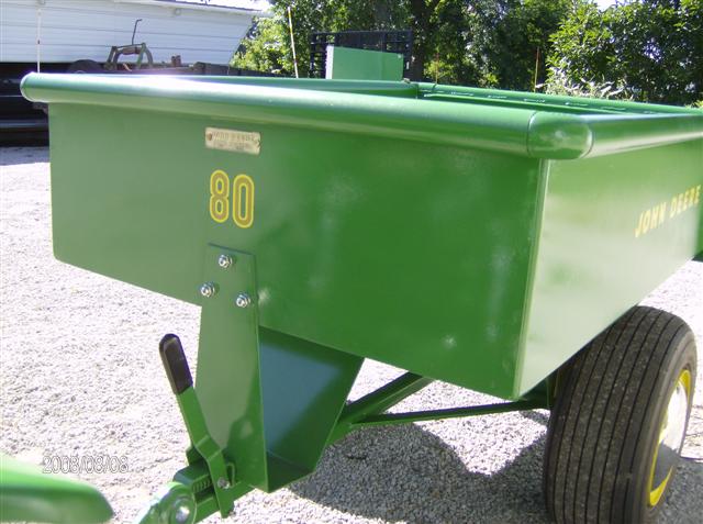

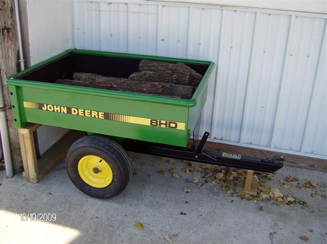

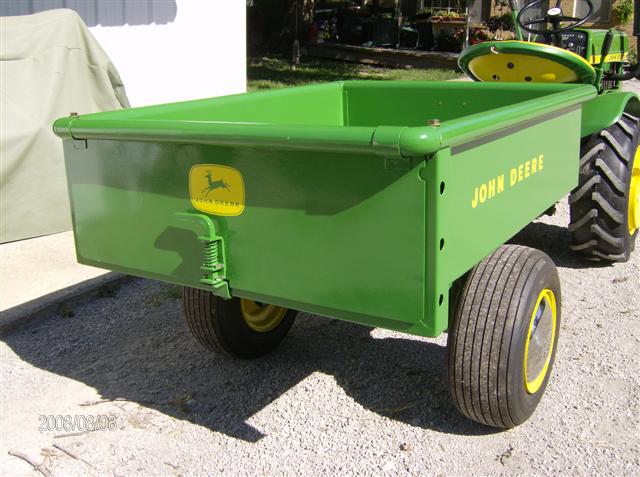

The "book" box dimensions for the model 80 cart are as follows:
Length---42"
Width----30"
Height----11"
Box Capacity---8 cubic Ft.
Rated load cap.--900lbs.
Mine is an early model, although not the oldest. First ones used 4.80 x 8 tires, mine has 16 x 6.50 x 8 tires.
The model 8HD used the same box, but newer style undercarriage.
Hope this helps! ~~ grnspot110
