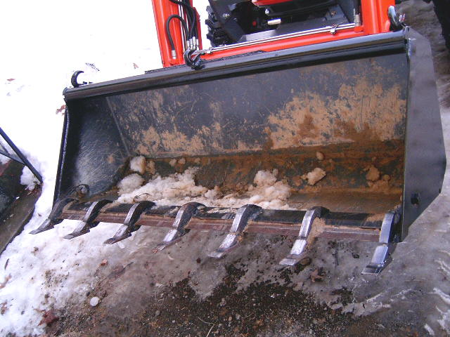

Carver Equipments sells the WR Long toothbar.
Thats where I got mine, and it is a real nice toothbar.
Just call Carvers and have them install the toothbar for you, that way you get a nice bar and you know it fits..

Here is a picture of my WR Long toothbar, (cost with shipping from Carvers was around $300).
I hooked 1 tooth on the tungue of my trailer and lifted till the loader ran out of lifting power and never bent the tooth. Thats strong enough to suit me.. /forums/images/graemlins/grin.gif
