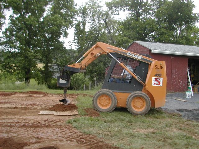

I'm about to start construction on a 36x48 monitor style pole barn. I had to special order the 24' poles for the center section and they're supposed to be ready for pickup in 3 weeks.
My site has been leveled and layout finalized and the next step is to drill 20 15" diameter holes for the posts. I'm planning to bury the posts 42" deep and I want to start out with 48" holes to allow for 6" of concrete under the post.
What has me stumped is whether I should buy a 3-point hitch auger or rent a skid steer with auger. A 3-point hitch auger would definately be a good investment and have other uses around my property, but I can't figure out whether it would have the ability to drill a 48" deep hole.
Can someone who's "been there/done that" give me some guidance on the right tool for this job?

I can't comment beyond what I know which is the skid steer version... 3 points generally do not have any downforce. A skidsteer does. If you have complicated soil the downforce is a good thing to have.
To get around this, you can get a hydrualic post hole digger (or build your own which is what I did), and attach it to your bucket. Then you have downforce. But it all goes to what kind of soil you are working on.
   / Digging post holes for pole barn #3
Skidsteer auger (or dingo auger) are MUCH easier to use. not only for downforce (which is essential at times) but also for seeing what you are doing and ease of positioning.
A tractor auger is nice, but your neck and back will appreciate looking forward all day from a skidsteer or dingo.
48" is really deep. it would depend on the auger you have, but I believe most of mine are around 36" ish. you would need an extension. Generally you can dig all the way till the powerhead is at the ground surface. Measure the augers that you have available.
You will still need a manual post hole digger to get the bottoms clean. Buy the ones with the joint in the middle. You will need them to get that deep. Not to mention they are just a lot nicer in general.

I just priced a 24" auger for my 3pt. post hole digger, $650.00. I can rent a skid steer with 24" auger for $355 including round trip delivery/pickup. No brainer there, I will be renting one. in a couple weeks as we are going to be starting a 50x40 monitor barn.

If you have a lot of rocks, a 24" auger will be handy because the hole will bounce all over the place by the time you're done, and then you won't have to do any handshaving on the sides to get posts in the right location. If you're soil is rock free you might go with a 20". The bigger the hole the more backfilling you have to do.

About all the augers I have seen are 36" long. They do sell shaft extensions for the auger shafts. The problem that I had was that I didn't have a tractor with enough travel on the 3 point lift to go all the way to the bottom of a 48" deep hole and still be able to lift the auger high enough for the auger to clear the hole when done. I rented a skid loader with a 24" auger.
