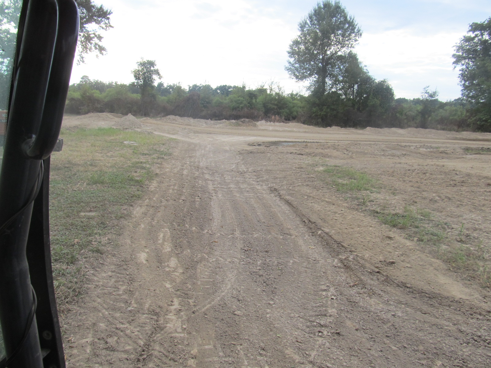

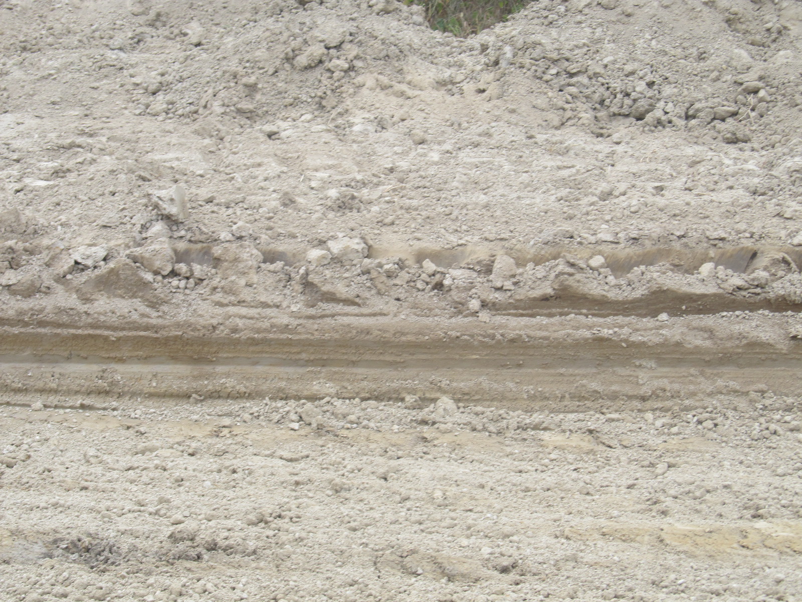

IMG_6597.JPGStarted working on this last fall just before it started raining. Now that the irrigation is turned off and it has started to dry up it is time to get started again. My wife on her Kubota BX 2670 and me on my Kubota L 2600 both with box blades. The boxes are set so we get a full load on each trip across the pond. The old pond in the picture was fill up with some of the dirt. We are going down to five feet or so. Wife used her loader to square up the bank. When we get though the new pond will be 100 x 250. The soil was a loam for the first 2 feet now down to clay. We have moved some of the dirt around the farm with the BX and the RTV 900. So far we worked on it about 10 hours each. The first Picture is the old pond then, The second picture is the old pond now, The third picture is the spillway, The fourth picture is what it looks like now. We are now down 30 inches. 1010537_534466553285494_1941258780_n.jpg

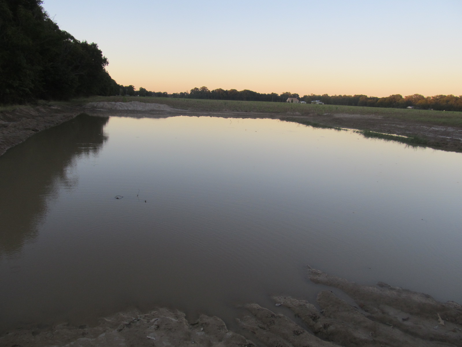

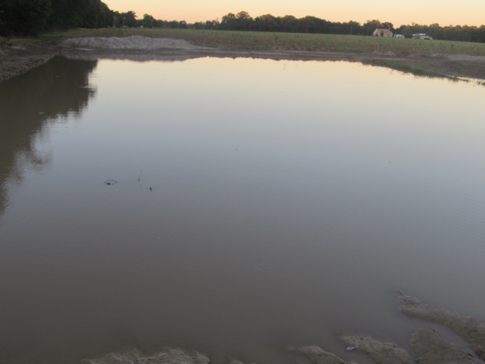

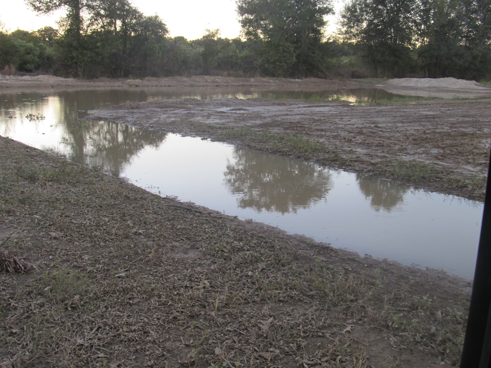

The weather caught us on the pond plus I have had a rough 2 weeksIMG_6665.JPGIMG_6580.JPGIMG_6666.JPGIMG_6667.JPG. It is only 1/2 the size we wanted it. We got 6 inches of rain in 18 hours plus about 60 acres drains into the pond so she is full. I guess next fall we will start again. So here are the pictures.
