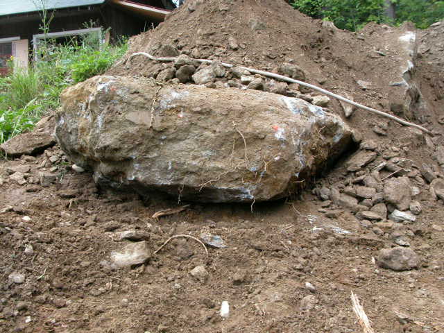

   / Digging for foundation expansion
And one of the smaller boulders that were on top of the little stuff. Note the orange "blood."
Pete
   / Digging for foundation expansion #6
Ah shucks Pete; that's Texas pea gravel.
Egon
