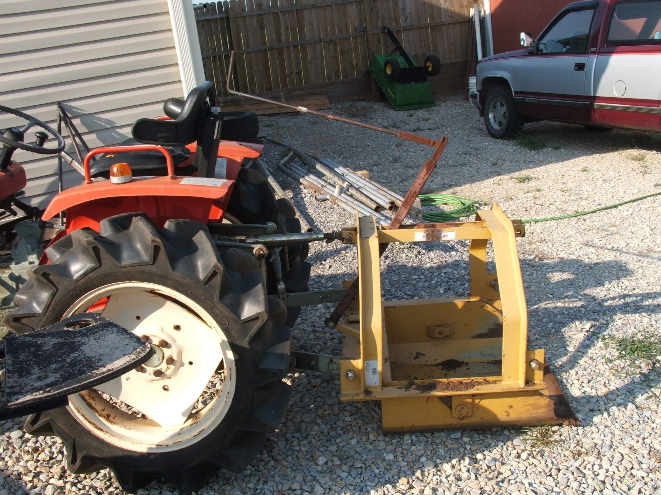

I built this pond about 2 yrs. ago with my yanmar 2210 and a 5 foot boxblade. Took every evening after work till dark and every Saturday and Sunday from sun up till sun down for about 3 months. Only spent about $80 in fuel. So my 1/4 acer pond ten foot deep took a lot of my time. but was pritty cheap I would say. The 3 pt. dirt scoop I bought towards the end of the pond build. I was not that impressed with it and stuck to the boxblade.

Man you have a lot of patience, pond looks great...
