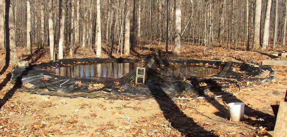

   / Diggin a small pond with the trencher
I have attached a picture. The pond has a leaf cover on it
I am trying that picture again. The resolution was too low before.
   / Diggin a small pond with the trencher #8
Wow, great job. That must have been allot of work and time.
keep the pictures coming.
PJ

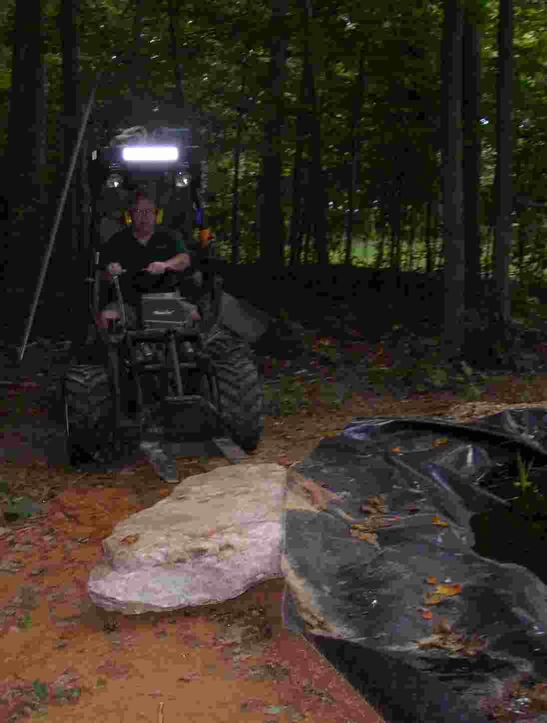

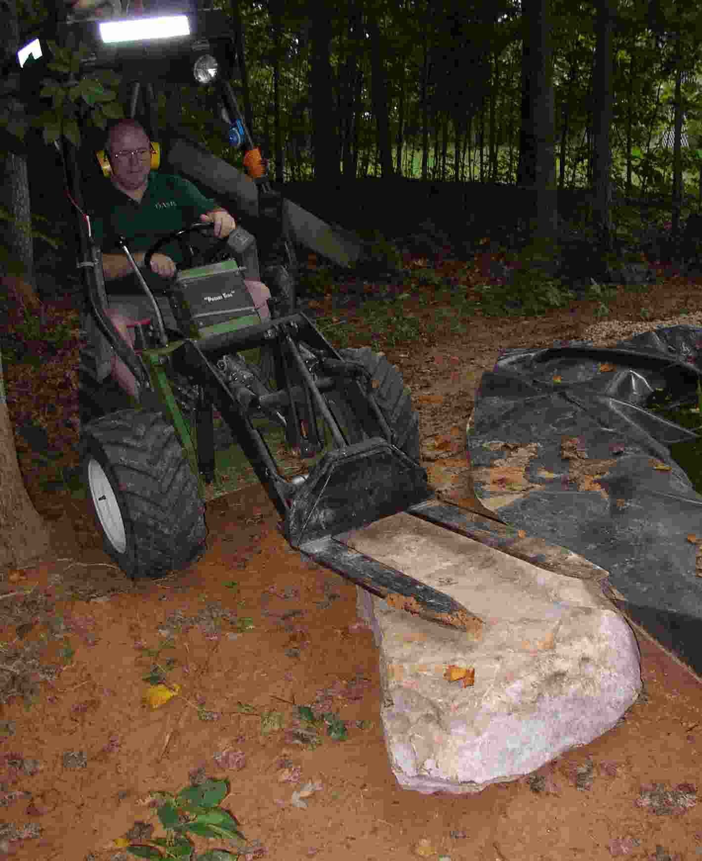

The neighbor asked my to move a stone today. It's one he wants to put on the side of the pond. He purchased it and they charged him for 820 pounds of stone. I felt the PT422 would not be able to pick that up, but maybe we could roll it. I put on the forks and drove over. The delivery truck had left it on a pallet. I was just barely able to lift the stone and pallet, so I asked the neighbor to stand on the bumper, and we were able to move it near the final location. I don't have pictures of the move because the photographer was standing on the bumper. Once the pallet was put down, I used the forks to flip the stone over twice and get it near the final location. I then pushed in place with the forks. See attached photo.
Bob Rip
Just to show the size of the stone I put the forks on top. See attachment
Bob Rip
