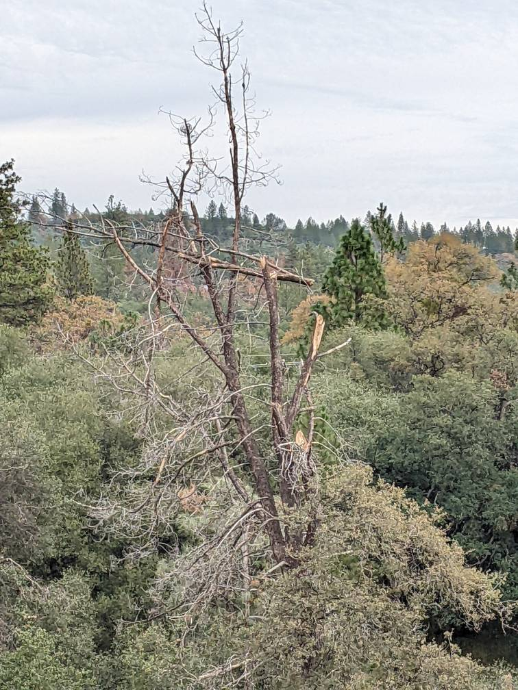

I cut it up and either burn logs on a pile or leave it on the ground to rot (which barely takes any time).
The stuff has the most sap of any wood I've seen, and watch out for skull-splitting cones - if you see a squirrel run up one, don't go near that tree for a while because it's probably rigging to drop one on you (friend got a broken shoulder getting hit by one - near miss to the head!).
Another thing to consider about these is that they seem to die almost arbitrarily but always after growing at a severe angle (unlike most pine, they'll grow towards sun instead of just soldiering on vertically until they finally get some). This results in a super brittle dead tree that's got a 20-30° lean. If one grows anywhere near a structure make sure you cut it at first sign it's leaning towards anything you care about or you're going to be hiring a crane crew to cut it down eventually (if the wind doesn't beat you to it!).
(Pic: one that looked live and happy one year and was falling apart the next; it's leaning away from anything so I couldn't care less at this point and it's providing endless entertainment for a flock of woodpeckers.)
