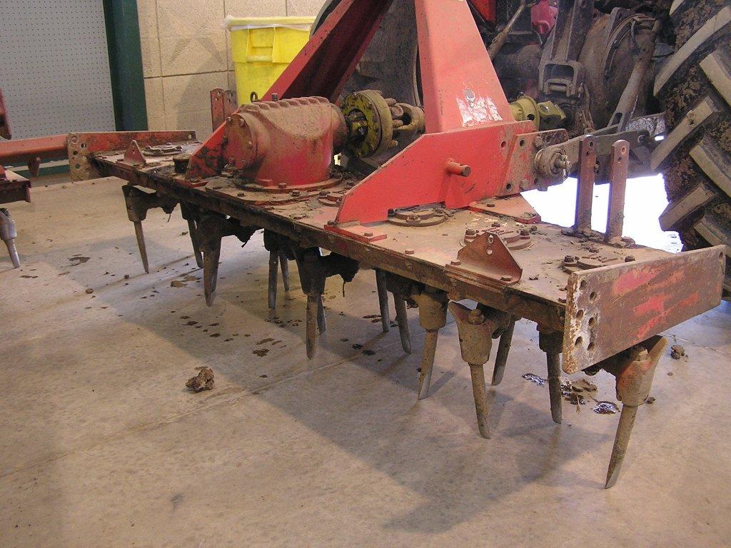

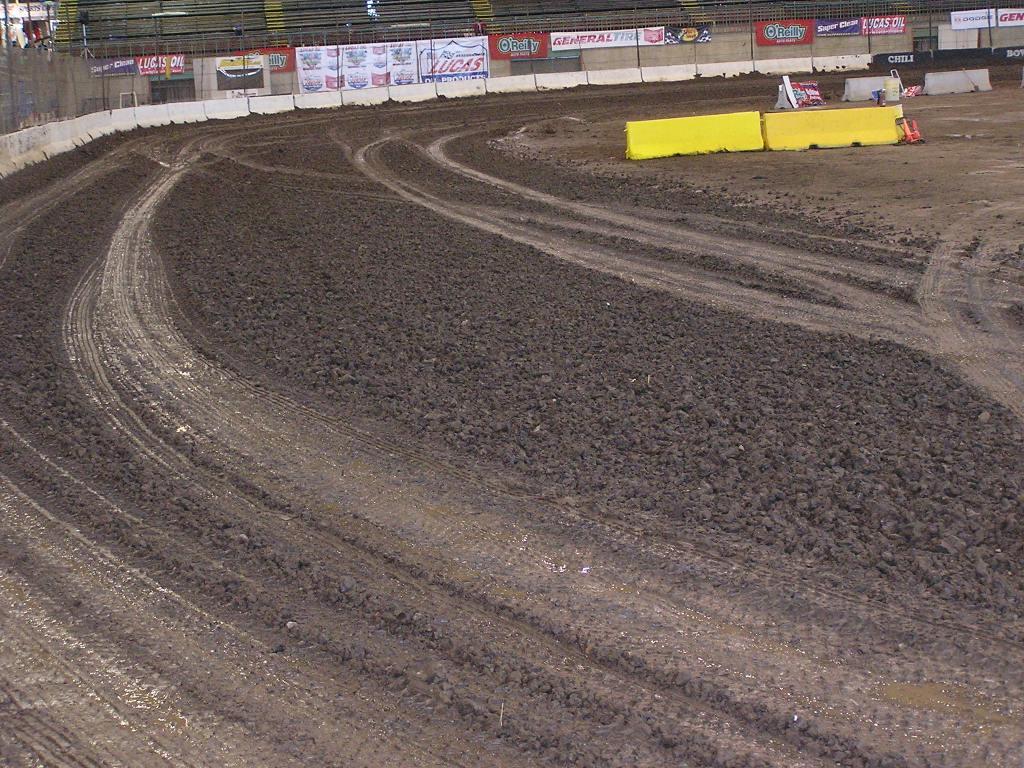

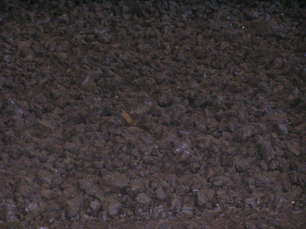

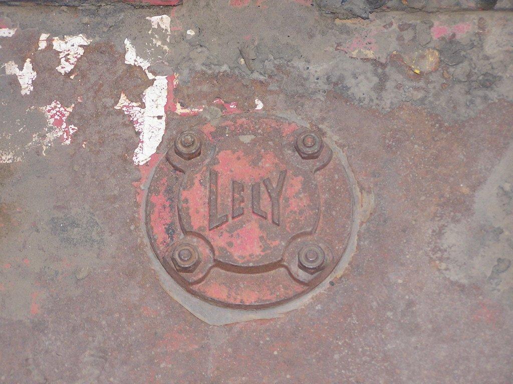

What is this thing called? What is the normal use? It does work good for preping a race track.
The tines spin on a vertical axis.

Looks like some type of arena groomer... which is why it does such a good job on the dirt track :)

That appears to be a Lely Rotera. I saw them used in the late 1970's around here. Very fine piece of equipment. It was an option around here for some of the heavier soils and would work a very nice seed bed in the right conditions. I would love to have one again.

This is a type of rotto tiller. It is used in soils mainly that is already tilled and just needs to be fluffed up. You can use it as a primary tiller but it isnt as easy to use. Lots of times i have seen these used to open up the soil so it could dry. They actually work very well. I wouldnt mind having one.

And their real claim to fame is they do NOT overturn the soil...:D
Currently manufactured by Tulip Industries and under Peecon...
Peeters Landbouwmachines BV - Tulip & Peecon landbouwmachines.

Dealer I worked for in the 70's had a unit demo'ed that had a row like that behind other tillage tines. 14' unit worked the stuffing out of a 1206 IH.
