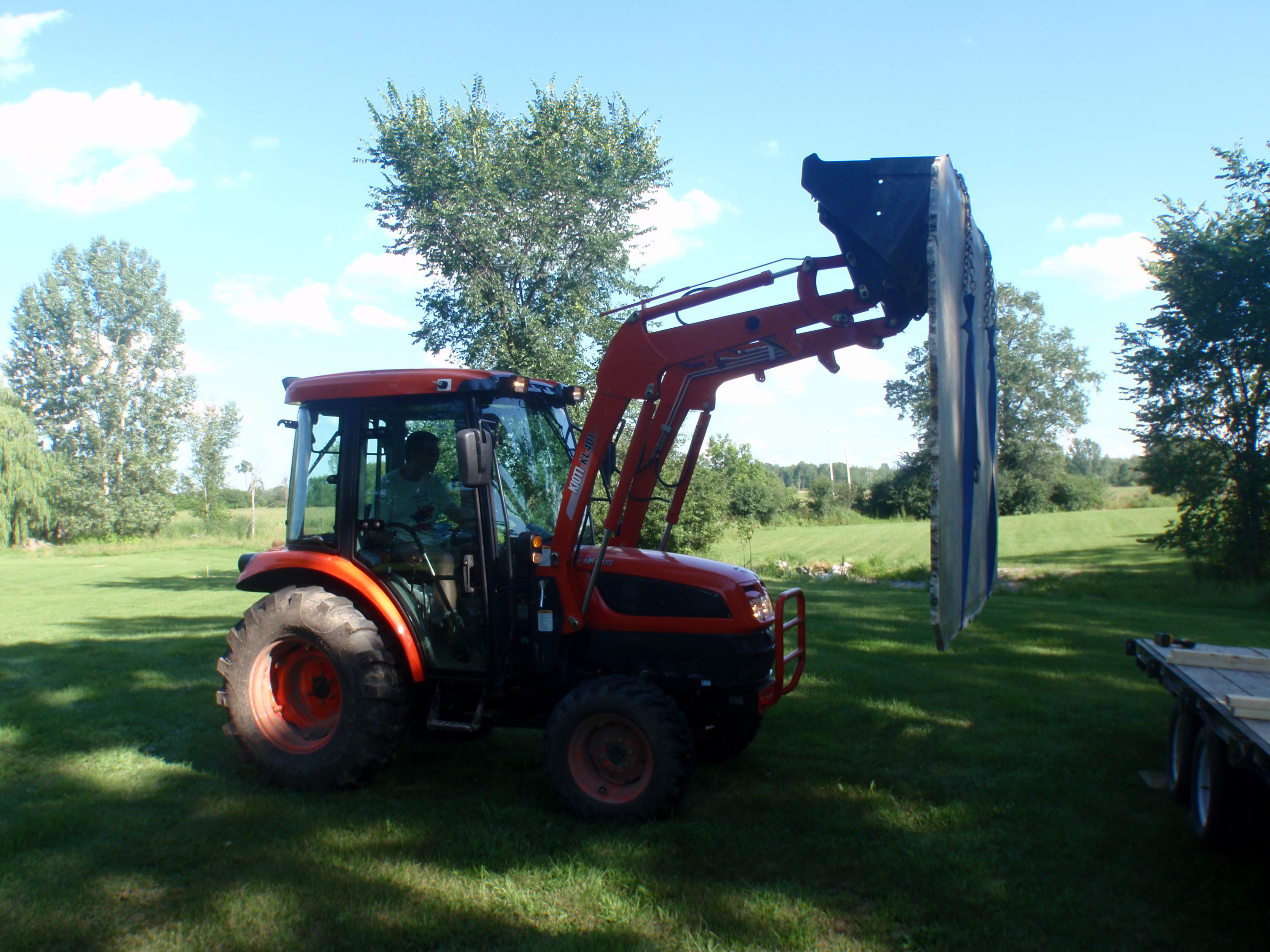

It's worth a shot, but usually, the big step up in price is for the DK50, just like the step up to the CK35 in that series. I wanted a DK50 but went with the DK45 because my dealer could do much better on price and he couldn't do any better on a DK40. I've had both CK and DK series. The CK was great, easily beats the competition IMHO, but the DK is a totally different story and a real beast with a lot more useful features. I regularly do things with mine that are simply unimaginable for my CK30 (or my wife :D).
Here's 1000# slab of granite hung near full height. With the proper ballast, I could have done two at a time.
