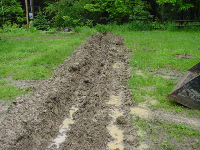

Heres a pic of a fitch the middle buster dug..

/ difference between sub soiler and middle buster? #7
And another

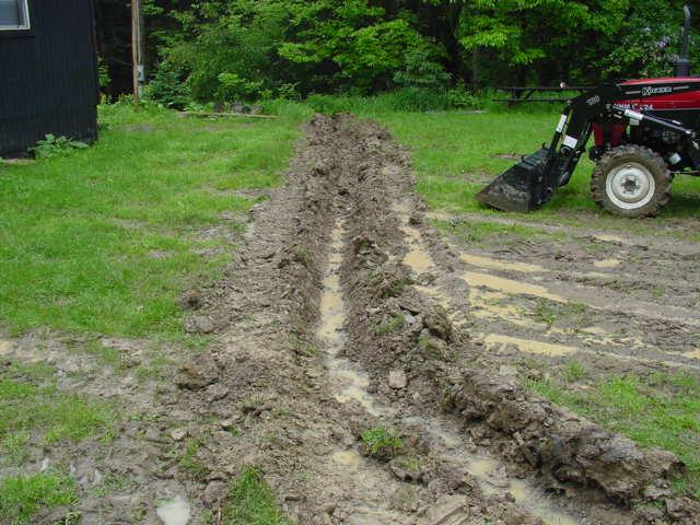

/ difference between sub soiler and middle buster? #8
One more. It works to bury 4" corragated drainpipe. Actually put in 100ft and it took about an hour........

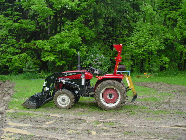

/ difference between sub soiler and middle buster? #9
This is almost exactly what I need. I need to cut small drainage ditches alongside and/or at the base of hillsides. Does any one make a middle buster that is offset to the out side of the rear tires? Sort of a “side buster.”

/ difference between sub soiler and middle buster? #13
</font><font color="blue" class="small">( This is almost exactly what I need. I need to cut small drainage ditches alongside and/or at the base of hillsides. Does any one make a middle buster that is offset to the out side of the rear tires? Sort of a “side buster.” )</font>
This is what I did. See attachment. Gerard

/ difference between sub soiler and middle buster? #14
Another view. Gerard

/ difference between sub soiler and middle buster? #15
Gerard, how deep can you get with that? That blade looks very familiar, what did you fashion it from? I like the concept of what you did to offset it by attaching it to your blade.

/ difference between sub soiler and middle buster? #17
</font><font color="blue" class="small">( Gerard, how deep can you get with that? That blade looks very familiar, what did you fashion it from? I like the concept of what you did to offset it by attaching it to your blade. )</font>
Bob:
With this particular set-up I can go about 16" deep. As for the blade (see attachment) it's a KK. I painted it with gloss black rust-oleum. Hated the mustard yellow. Gerard
