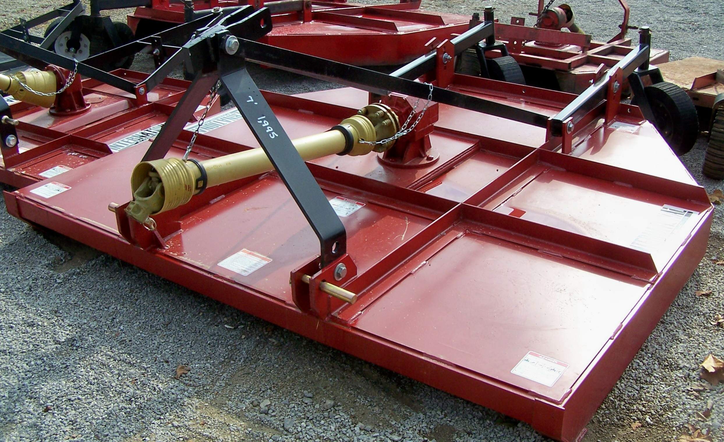

The MX series is showing some signs of giving problems. We sell the 7 ft Hawkline/International for $1995, This is a true HD cutter at a $1500 savings. I am not trying to sell you one, I can't ship it. Just showing you what a range of cutters are available. Ken Sweet

Ken I was curious what the HP rating on the Hawkline gear box was. I thought most truly heavy duty rotary mowers ran gear boxes with 90 hp ratings.

I would buy 709 over MX7. I've run some Hawkline HD 7 footers, I was breaking bolts every time I used it. The one I used did not have chains so I almost broke a window on my shed, 100ft from where I was cutting ...
Get safety chains.
No shield on the slip clutch? That could hurt.
