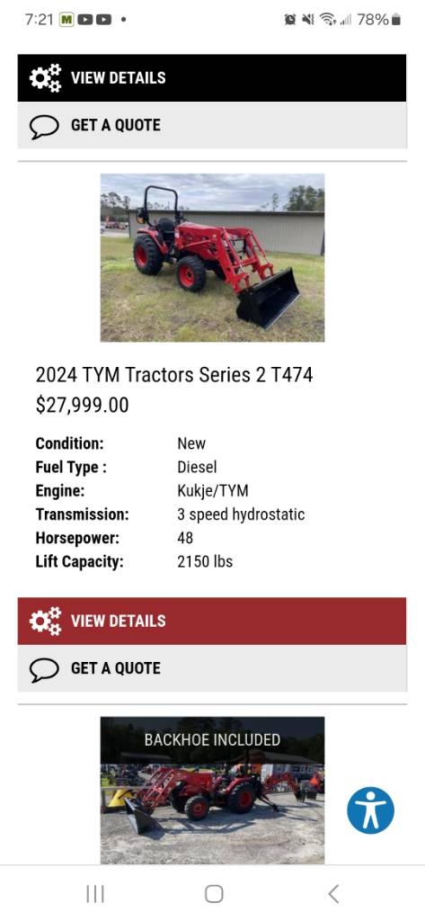

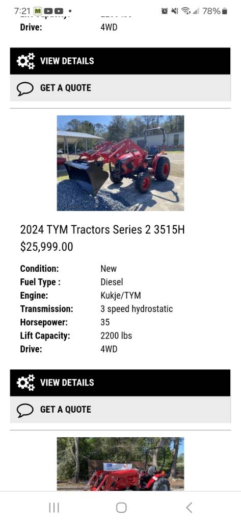

I will say, the 3515 is almost the same price as the 474. I dont know the reason, but I think it's only like a $1600 upcharge for the additional 12 HP. Given that, and your use, I would go with the 474
   / Dif between 3515 and the 394 ? #7
Locally, TYM 3515, HST, loader $26k; TYM 474, HST, loader $28k; TYM 574, HST, loader, $32k.
