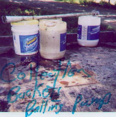

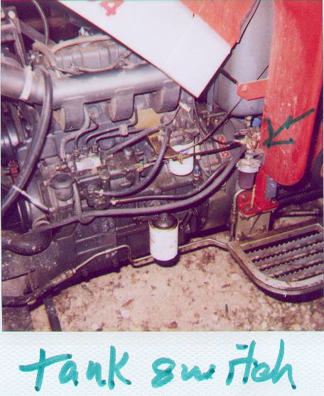

I am using used cooking oil in one tractor and a ton truck. I pick up grease from local convenience stores settle it, filter and fill a seperate tank. The tractor and truck both have tank switches. I start on Diesel ans switch to grease after the coolant has sufficiently warmed the grease. Shutdown for long periods is the reverse. I have posted pics on my photo gallery rdbigfarmboy.
The idea is to save money, with minimal inconvenience and no disruption or loss. Filtering both from the collection from store and filtering into tank is the heart of the project.
The tractors add on tank is from a junk yard $15. I added lines to run coolant thru tank. The tank switch cost about $30.
The truck needed a line to run coolant thru the factory front diesel tank.
The pump is a mini PTO pump run by the tractor. It sucks from the collection buckets and pushed thru the 3 filters.
Each item has its own filter water seperator that is drainable.
Works very well.
Cost of fuel after filtering is about .20 per gallon. The filters are about $2 each from Walmart or RK. The water block is about $10-12.

I have ran the grease for over 100 hours on the tractor and several tanks on the truck. As far as refinement I want to find a cone bottom tank to settle and drain off contaminants. I am very familiar with lye soap thats where you add a hydroxide to form a precip and with this grease skim it ( soap) off (over simplification of process). The remaining grease would be alkaline. I have noticed small floating globs of esters (fat) from the meats being cooked. My limited experience tells me the better the filtration the less problems. My logic is I can use about twice the amount I collect locally. I collect from 5 local stores that are not high volume, they produce too much trash (fines) and water. I want to batch process in order to have a stable supply. I start and warm on clean diesel and before shutdown switch back to clean the distrubitor and filters. Additionally my engine filters have water seperator drains.
Understand biodiesel and used cooking oil are not the same. Biodiesel is diesel blended with vegetable oil different companies have different recipes.
