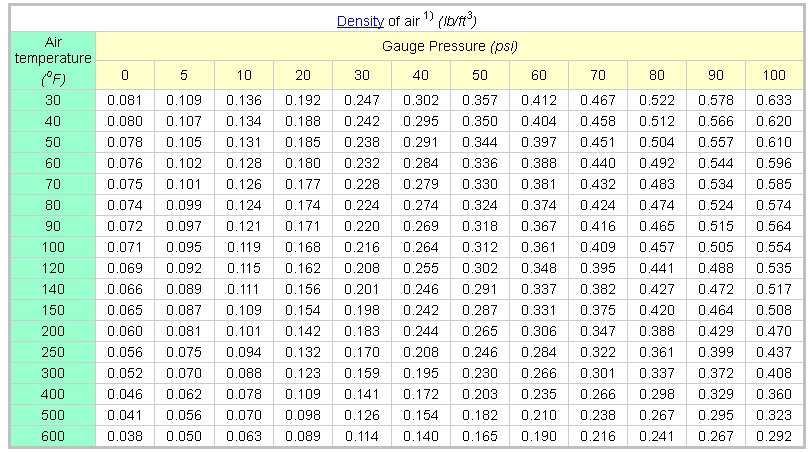

Diesel fuel flash points vary between 126F to 204F, depending on which graph you read.
Our diesel engines generate about 400 psi cylinder pressure.
And using this chart on air/pressure temp, I've come to this scientific conclusion.
If I'm not cold; no preheat. If I'm cold; 10 sec preheat. If my B's are cold; 20 sec preheat.
