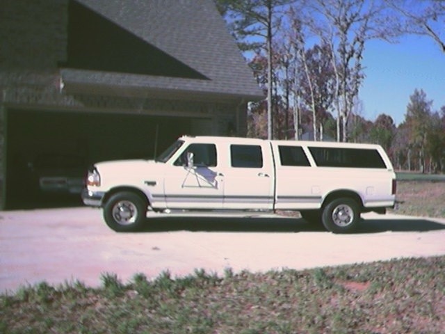

I've had a diesel pickup for about five years now and have never let it warm up before driving away. I imagine the fact that our tractors are most often used at high revs or working hard with some implement is the reason we need to be more careful with a warm up period. In my truck I just take it easy on it until it reaches temperature. Can't comment on the engine heater as my truck has gone from blustery Tucson, AZ to that winter wonderland of Charlotte, NC./w3tcompact/icons/smile.gif
Jeff
