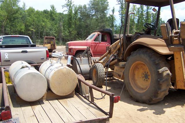

I was given two 100 gallon aluminum fuel tanks that are used on semi trucks. Both tanks were dented and missing there fuel caps. Oddly enough, it's almost impossible to find a fuel cap for certain tanks.
I had a welding shop weld a female threaded coupleing to the tank and the I put on a electric fuel pump from tractor supply. A discount and it being on sale made it pretty cheap.
I connected both tanks and fill one tank, then pump from the other tank.
I can get ecaxtly two hundred gallons in it if I fill it slowly. If I pay cash when I buy it, I get 3 cents off per gallon.
Eddie
