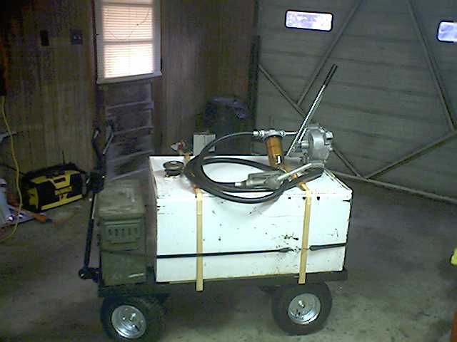

Here is a picture of the refueling rig I finally came up with. I bought a 10 micron Golden Rod filter at TSC along with a filter install kit. The tank holds 55 gal., the pump is a Great Plains Industries unit along with the hose and nozzle. The wagon I got at TSC for $76. All of the components you see can be purchased at TSC. I found a local petroleum distributor and filled the tank and a 30 barrel up with off road diesel for 95 cents a gallon. I had to fill out a paper for agricultural use and waiving sales tax.
