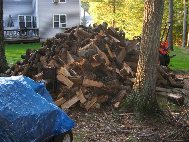

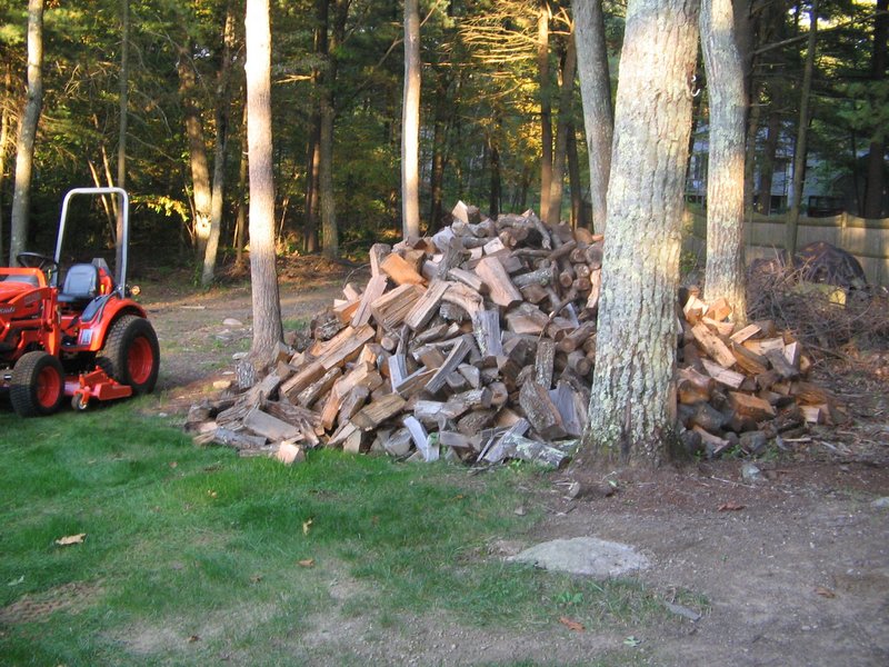

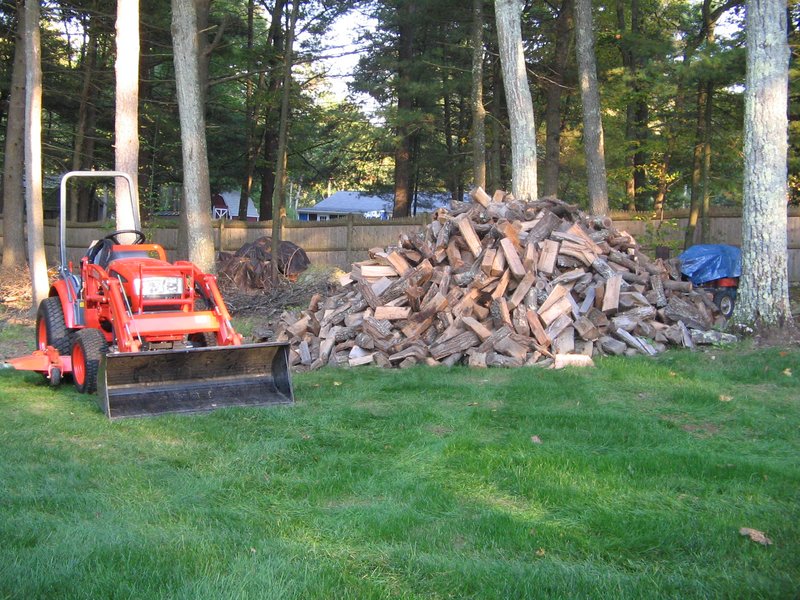

Attaching some pictures of recent woodpile created from 5 or 6 oak trees cut down in the yard and split w/ 30 ton White outdoor products splitter (can be seen partially in photos along w/ tractor although the business part is covered w/ a tarp).

I see you got the grill guard on the ck20.. almost stole that from Harvard Equipment when I went to pick up my filters a few months back for my ck25.
