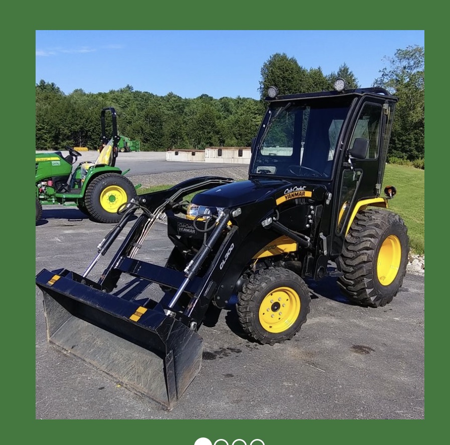

Purchased a new to me 2010 Yanmar Cub cadet with 200hrs in mint condition with Curtis cab with heat. Looking to add a skid steer quick attach to loader and 3rd function valve anyone have any recommendations on how I should go about doing that tractor currently does not have rear remotes and I can’t seem to source it anywhere. IMG_1389.JPG

SSQA hardware weighs 120 - 130 pounds. That weight comes out of your Loader payload, about 16% lift decrease. Grapple will have SSQA + additional weight, further decreasing Loader payload.
You may be happier with good quality bucket clamp-on 40" Pallet Forks or clamp-on 24" Manure Forks, if you want to move brush. Note Manure Forks are rated for lift greater than your FEL lift capacity. Shorter length improves maneuverability. Manure/Ultraforks are round, therefore pick up less dirt with debris than flat Pallet Forks or flat Debris Forks.

For me I’m pretty heavily invested in the SSQA system. I totally agree with you on the weight issue I have been looking at Everything attachment root grapple. It only weighs 230lbs compared to my other Grapple which weighs 500-600 lbs and would be useless for this machine. I do plan on doing a loader lift test because i think there specs seem under rated but i post an update thanks for the advice IMG_1417.JPG

The title of your post is "Did I make a good deal" . Not tryin to beat you up but if you dont share what you paid for your rigg , people here wont be able to answer your thread question .

My bad that probably would help Paid $12,900

Check the Yanmar usa website to see if there is a dealer near you . These tractors were totally Yanmar built and they will have parts for them including rear remotes. However the loader quick connects on my EX450 are exclusive to Yanmar and other Quick connects won't fit.

I think its a very good deal, the cab adds a few thousand of value too.

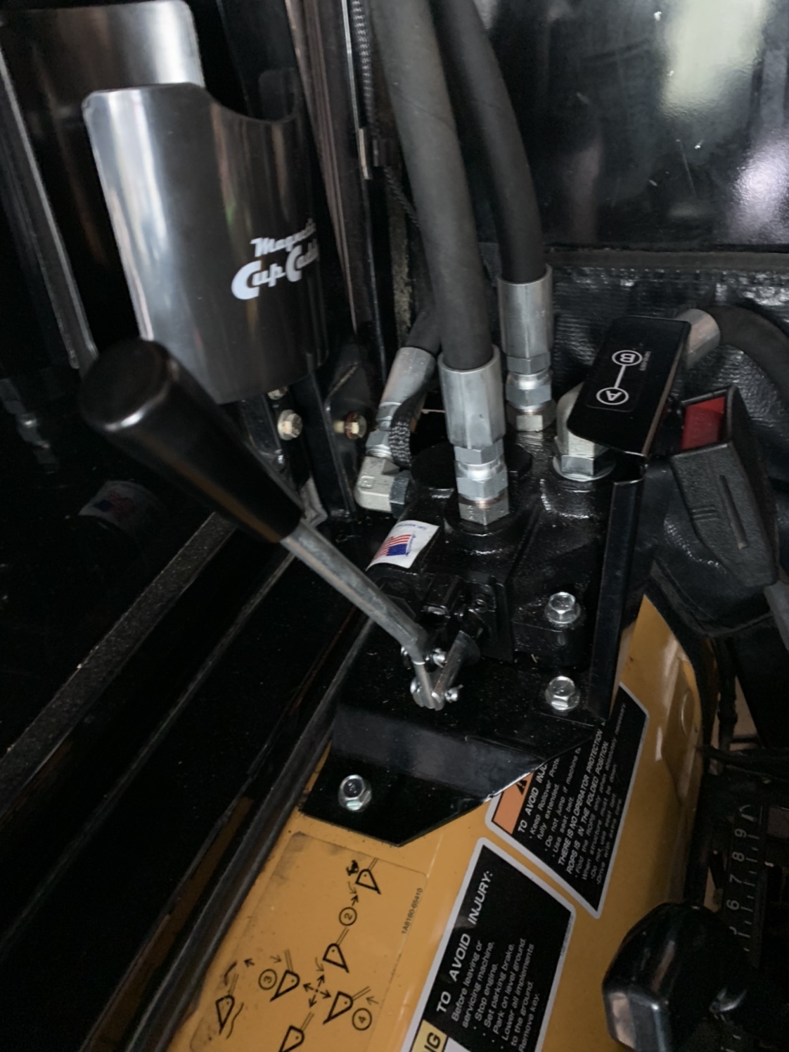

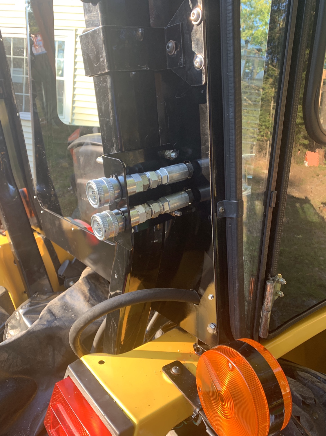

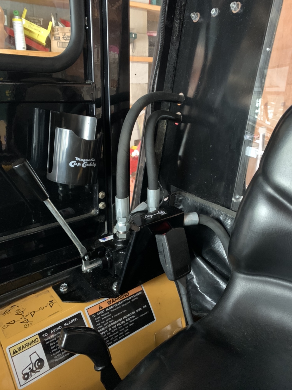

I have to thank you for referring me to Waterman farm and machinery what a great service and people both Bob and Brian.
They had 3 remote valves in stock new old stock. Total cost on the valve was $906.80 with tax which I was happy to pay because I could not find it anywhere else I’ll takes some photos tomorrow of the actual kit
Thanks
