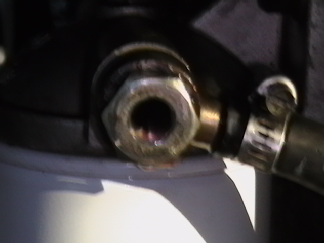

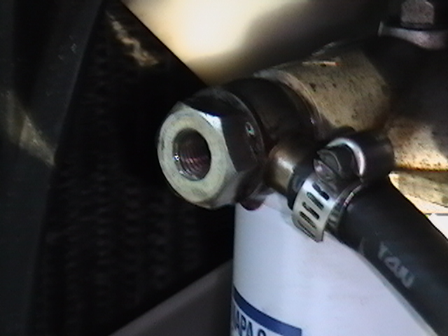

Ok, here is the fitting I made. Easy to do. Just drill and tap for 1/8" NPT and install a small needle valve and tube to your reservoir. You will also have to install a return line to the tank from your new reservoir- ok to go via the injector leak-off lines.
