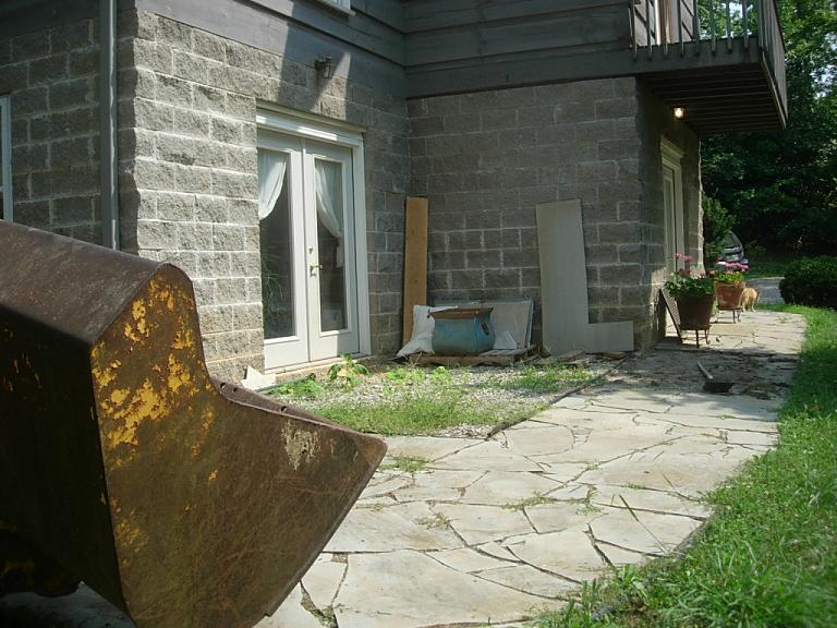

I guess I wasn't too clear. These are not "square" type flagstones. Nope... the wife wanted NOTHING to do with square/rectangle of any shape. These are 100% irregular pattern which means fitting them with nice tight seams (as she insists) is just about impossible becuse when I need a seam with a 90 degree angle in it... I only happen to have rounded stones. When I later need a rounded fit...I only have pointed stones.
/ Diamond saw blade?
This is a BEFORE picture but it's the only one I seem to have here at work.
(did I just admit I'm hanging around here while at work? :rolleyes:)
Anyway, this is the original sidewalk we (I) put down and this is just before I ripped it all up so we could do our addition to the house.
Now that the addition is done, I'm in process of putting the walkway back down. I've had to buy two more pallats of flagstones (4 tons total) These new flagstones are much more consistent than the ones in the picture. The new ones are about 2-2 1/2" thick and as these in the picture, are irregular shapes. The new ones however, seem to be larger stones than these in the picture. Some of them are downright BIG and I'll use them on our stairs to replace the "piecemeal" treads we have on the stairs. (I have had one of the existing treads "flip" up on me about an inch or so when walking on the steps, I'm going to pull those off and replace with a single larger (new) flagstone)
Regardless.... this is the mosaic type of stuff I'm having to piece together. Why she didn't simply get square cut in the beginning to make life easier....is beyond me.
I think she's trying to kill me while maintaining culpable deniability :rolleyes:

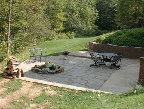

I know your pain:) I just got done with about a 500 square foot patio and 11,000 lbs of the same material. I found out that I am not very good at jigsaw puzzles.
To answer your question: Yes those blades will cut your flagstone. I bought a 7" masonry blade for $20 because I had some block to cut and ended up using it for the flagstone as well. Ended up going through two blades.
I didn't trim too much of the stone, I tried to fit it together as well as I could. Be prepared for a lot of dust. I strongly suggest a decent respirator. I've included a pic of my project. It turned out pretty well. Now I'm starting phase II of the operation.

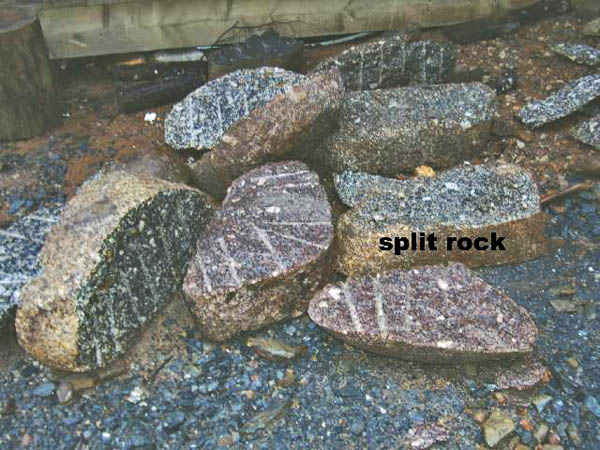

I've used a 4 1/2 in angle grinder wit a dry cut rock blade on granite stones.
I also have a 14 in. dewalt circular saw with dry carbide rock blade. It has cut through 5 in granite.
I assume you are cutting as deep as you can for the full length of the piece that has to be removed and then using a wide chisel on the backside to break off the piece. When doing so do you have both sides of the cut supported full length and off the ground so the rock can break properly? The long side support should be as far from the cut as possible.
Do you make one cut and then turn the stone over to cut the opposite side?
Pictures Not flagstones but granite rocks that have been split just to show saw cuts.The saw cuts are quite hard to see but they will be on the side where the drilled holes start.:D
