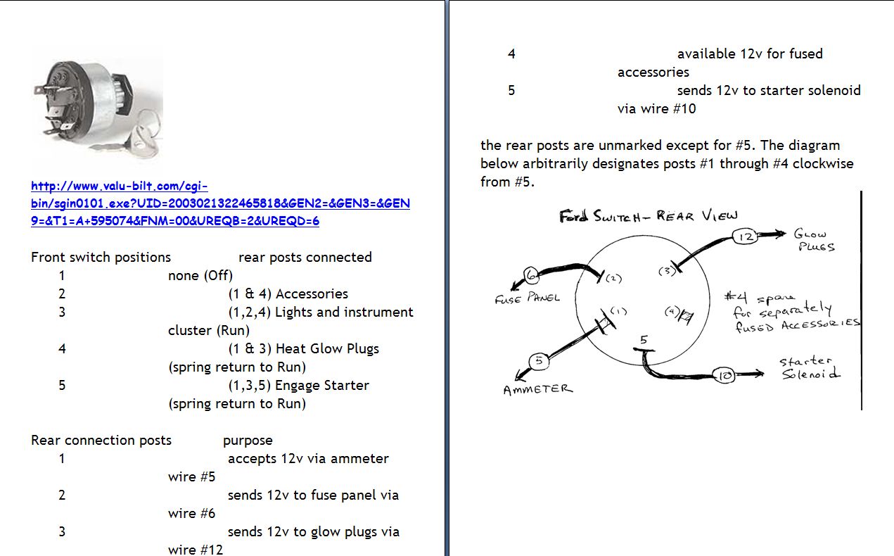

/ DF-354 : Ignition Switch Substitution? #9
With regard to switch substution - I have a Ford 3000 gas and this switch does not work for me. Unlike the switch described, mine - the same part # has onlyt one spring back position. Otherwise the contack arrangement is as desctibed.
I have it wired :
1) 12+
2) coil
3) starter
4) lights and gages
5) never connected to 1
My problem is that whrn in the starting position, key position 4, I have no power to the coil.
/ DF-354 : Ignition Switch Substitution? #10
the switch being discussed is for diesel engines, the other spring-return position reserved for pre-heater (glow plugs or manifold heater).
But you should be able to make it work for a gasoline engine without using the glow plug connection. Be aware though, that not all Ford cold start (diesel) switches are configured like Larry described above. You really need to put a multimeter on yours to confirm which connections are made in which switch positions. Or else just trade it in for the gasoline engine switch.
//greg//
/ DF-354 : Ignition Switch Substitution? #11
Greg -
I have tried. The problem is that when the key is in position 4 only the #3 terminal is hot. NO other. The #5 terminal is never connected to #1 Currently I run an external wire to the coil to start it. Do you know of any other switch ?
James
/ DF-354 : Ignition Switch Substitution? #12
That's the spring-return pre-heater position I told you about. On a diesel, you first turn to key to #4 while the glow plugs or manifold heaters warm up. Then you turn to #5 to engage the starter solenoid. Releasing the key from either position automatically returns the key to position #3.
But something sounds wrong with your terminal connections. Yours might be numbered differentely, or simply a bad switch. Because terminal 1 (battery) should be connected to terminal 3 (pre-heater) and terminal 5 (starter) when the key is in position 5.
Take a look at this document, see if it helps. Again, it's for a diesel. But it should reinforce what I mentioned earlier about not all of these Ford switches having the same terminal pattern.
//greg//
