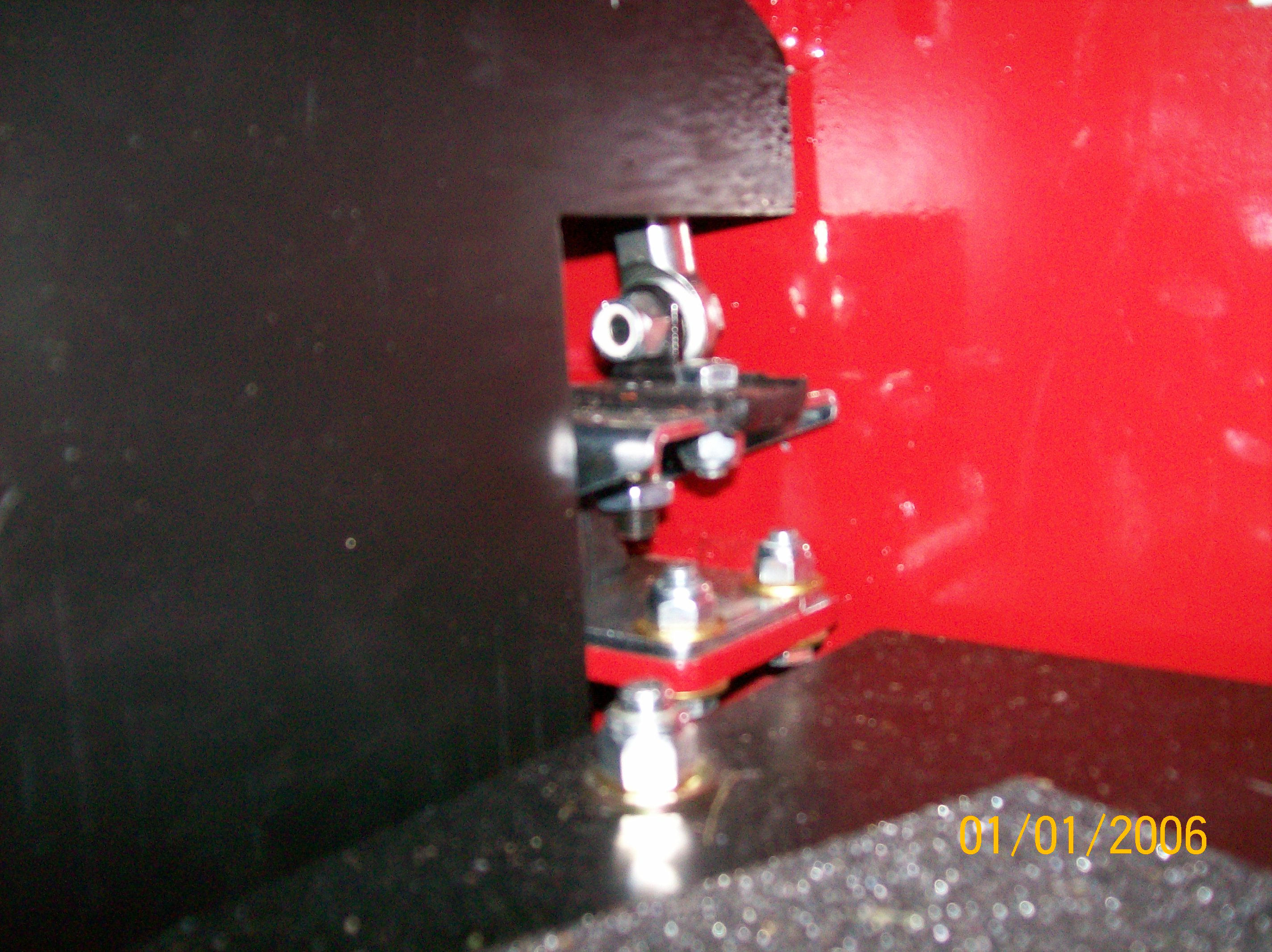

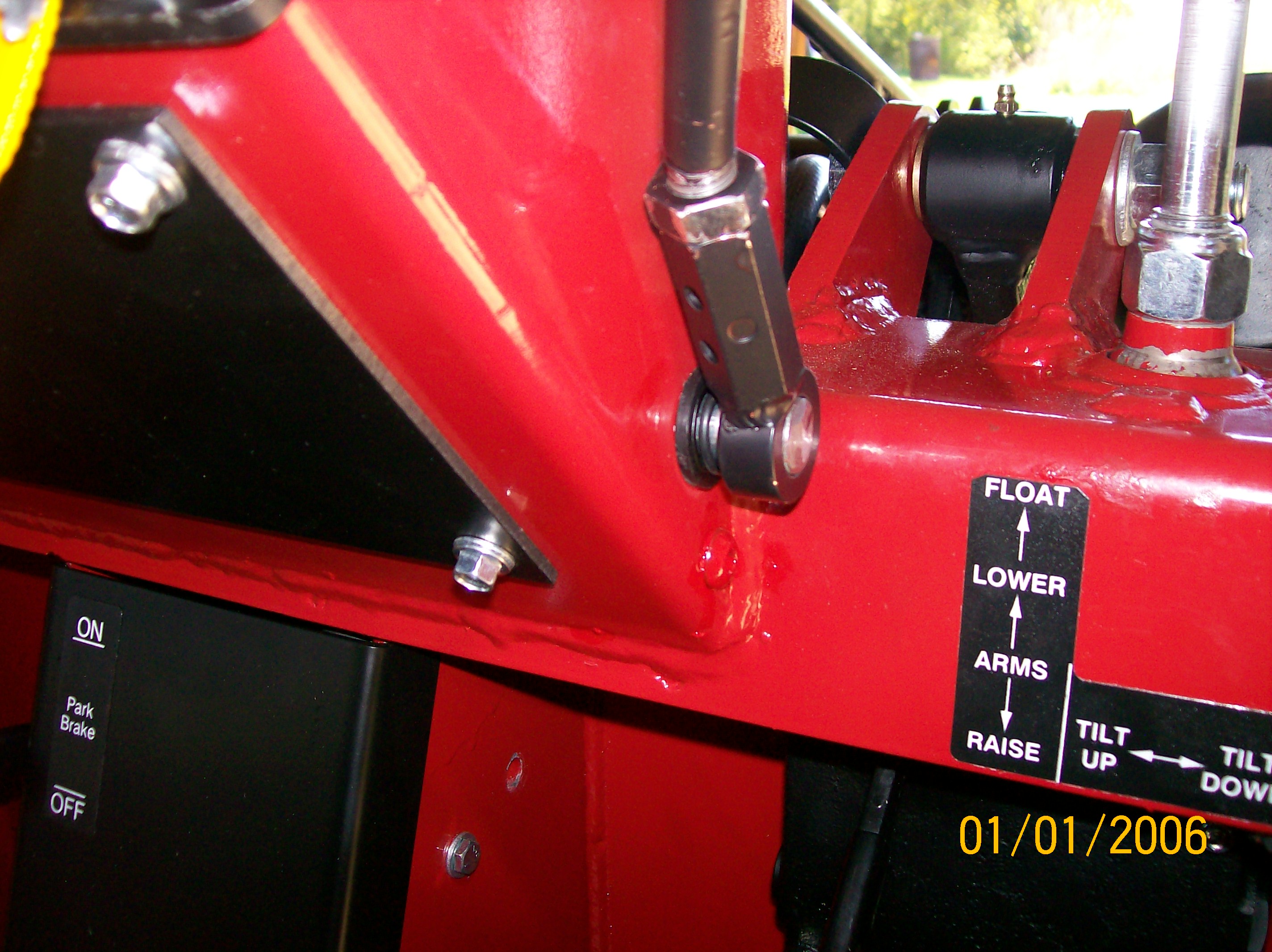

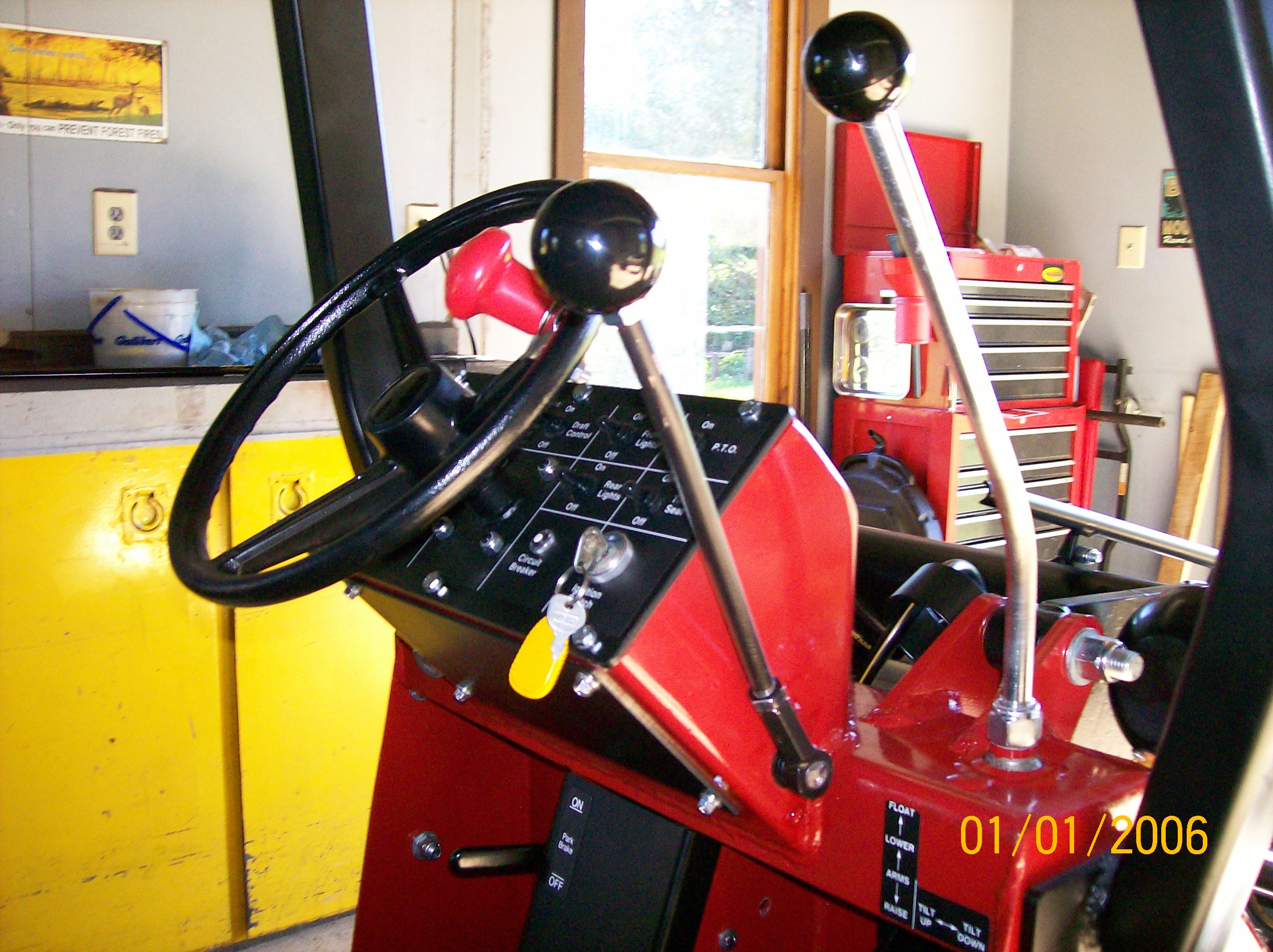

Since my feet don't work nowadays, I put these hand controls on the 1430. 100_0286.JPG
   / Deutz Front Seal Leak #9
