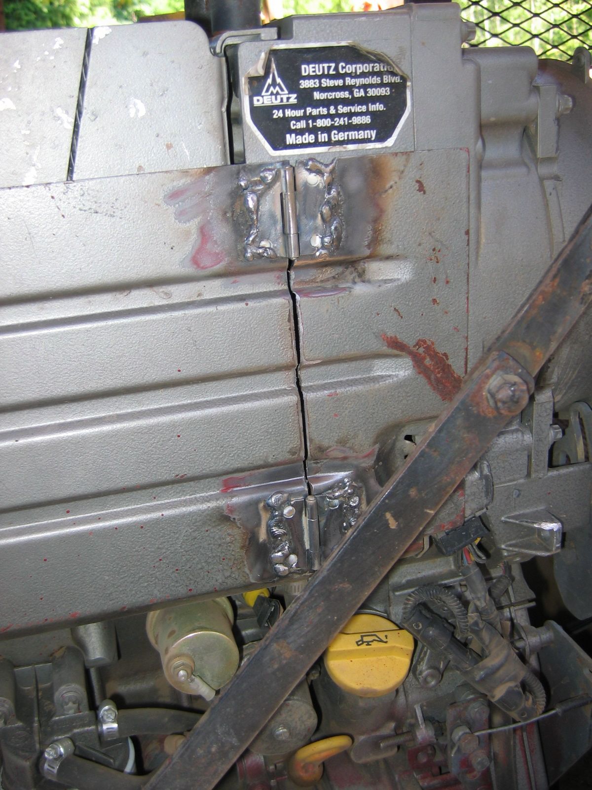

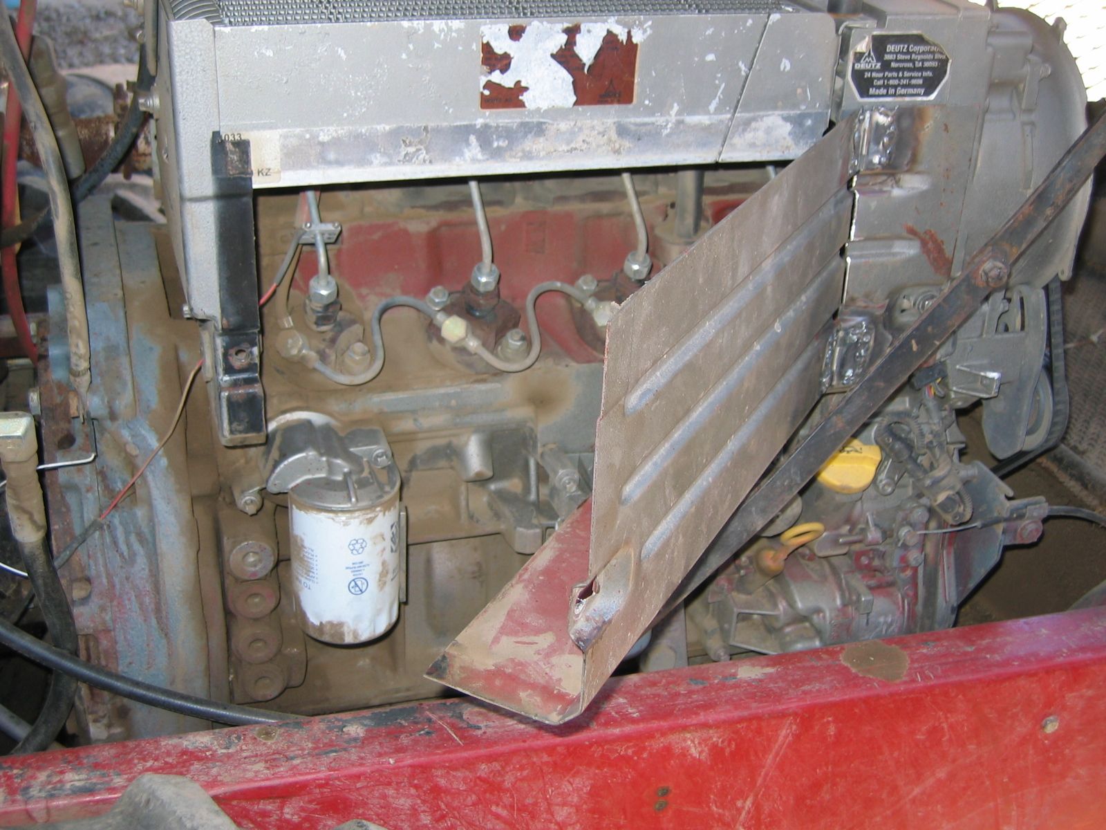

On my 1850 I have to take the side cover off the engine with two bolts to properly blow it out. I had the welder out so I cut the plate up, welded some hinges on it and but a washer on one of the bolts to act as a thumb screw and now I can easily access the oil radiator. This, along with the raised out take vent should help keep the PT running cool... Just tell me this. Who in the heck decided it was a good idea to put the engine air intake and cooling intake in the back of the tractor where all the dust can get sucked in... Dumb design..
Also, I am just learning to weld, and I found doing this that doing thick 1/2" steel is much more forgiving than this thin stuff....
