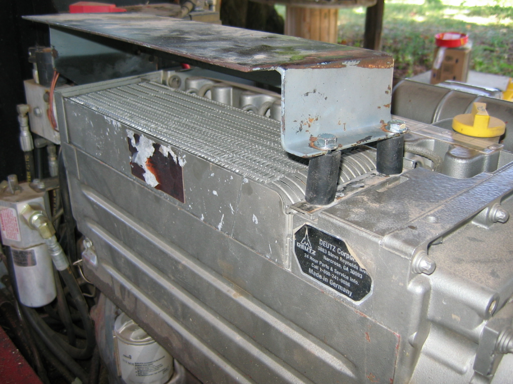

Thought I would start a new thread for 1445. I know of a few, here is the two I did.
First, I added risers under the top baffle on the engine. I feel that the baffle that PT puts on restricts air flow. I feel I gained a 7 to 10 degree drop in operating temps. This does not prevent obstruction, but it helps in easing cleaning.
I think the front riser is 2" of 1/2 Pipe and the back riser (the side along the muffler) is 1.5" I felt a bit of a pitch up would cause the air to blow out one side, and maybe create a bit of draft as well...

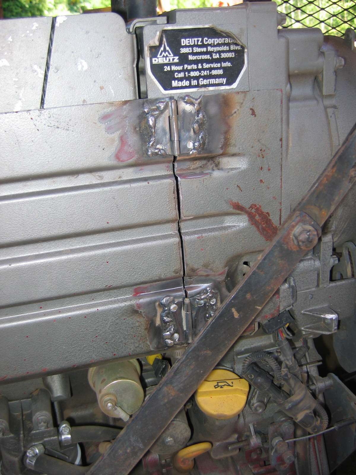

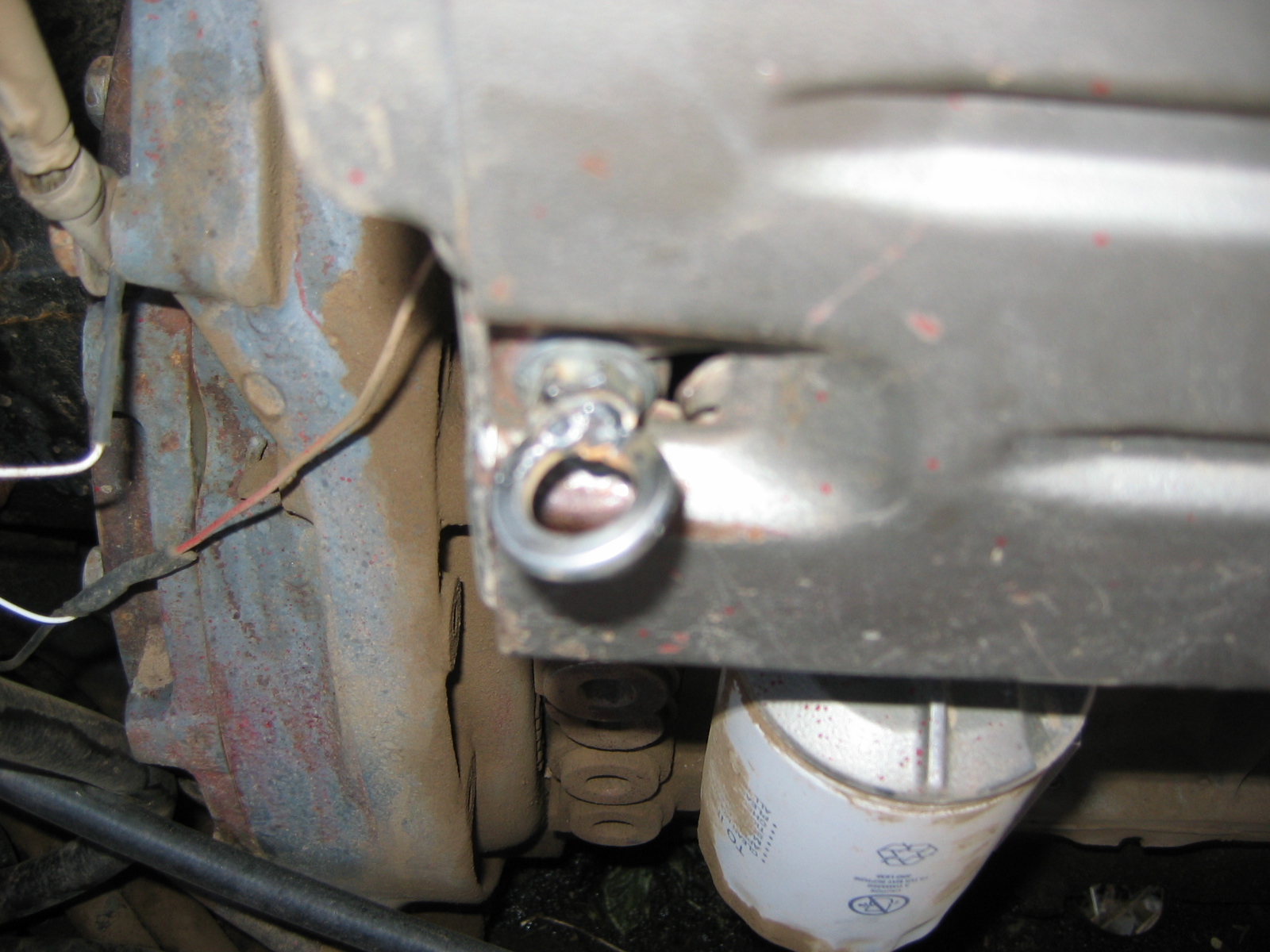

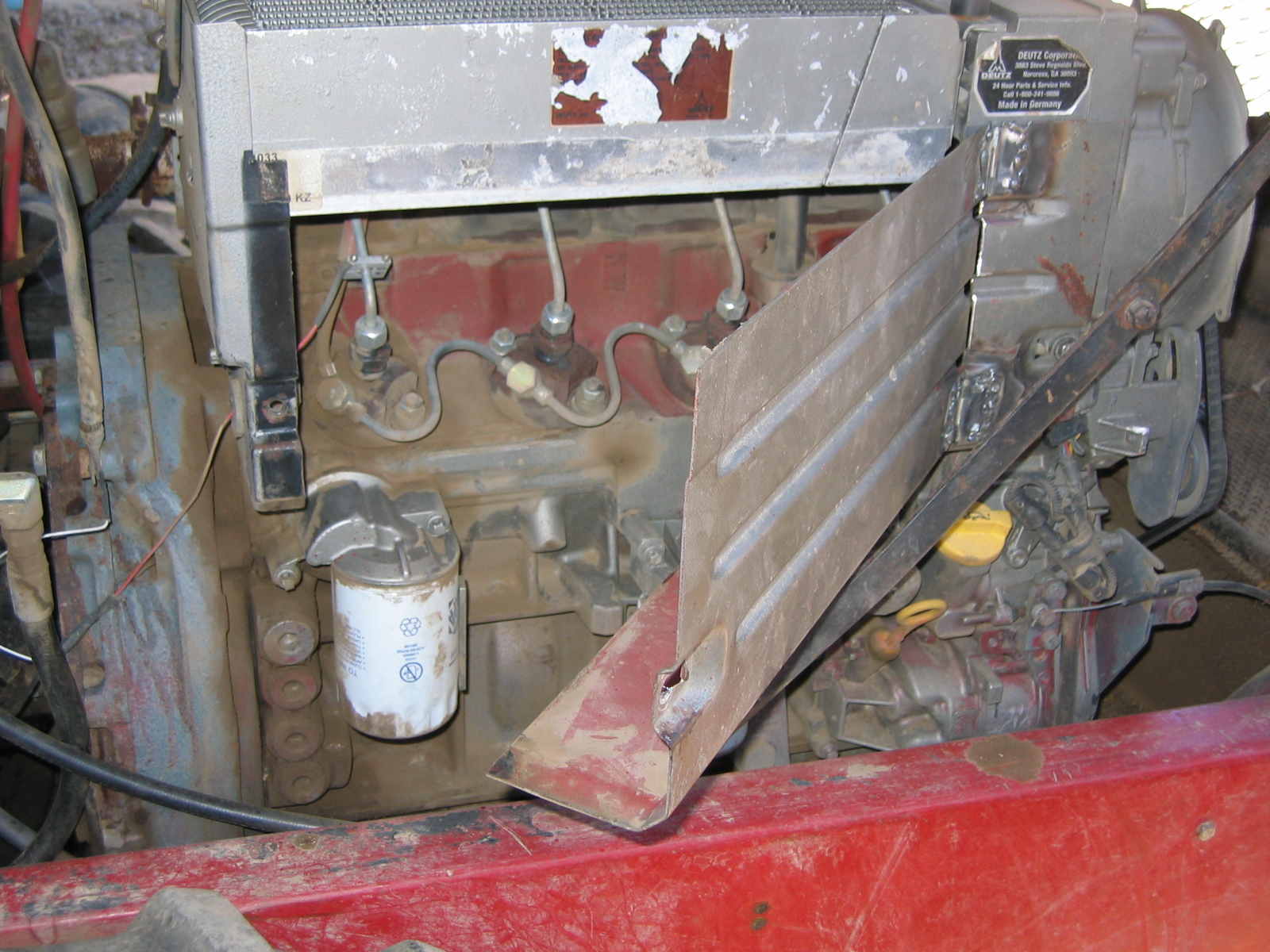

The second thing I did was make it easier to access the engine cooler. I did this by cutting the cover plate and welding on two hinges. I also welded a washer to the front bolt to act as a thumb screw.
I used my 4" hand held cut off grinder, and then chunked it up using my stick welder (I have no welding skill)
I also purchased an extended air nozzle at harbor freight - - Harbor Freight Tools - Quality Tools at the Lowest Prices
Works like a charm

WF - Good thinking on those changes. My thought was the big issue is how quickly the air passages become clogged with grass and dirt. By attaching screens all around the engine cover, on the outside for easy cleaning, I could keep the cooler clean. Turns out to work reasonably well, though the PT still runs hot.
