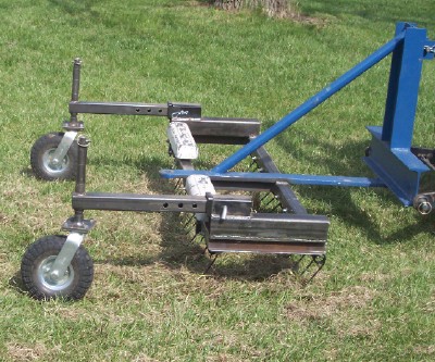

For what it's worth, and you may have seen my earlier posts when I built this.
I built a rake loosely based on Mad Referee's design, using material I had on hand, except for the rake teeth and caster wheels.
I originally set it up to use the wheels, but I can't tell you the last time I've had them on it.
I intentionally built it to stick out a ways from the tractor because I have a lot of evergreen trees.
It works nice to back up under the trees, drop the rake and drag out big piles of pine needles.
If you have any questions, let me know.
