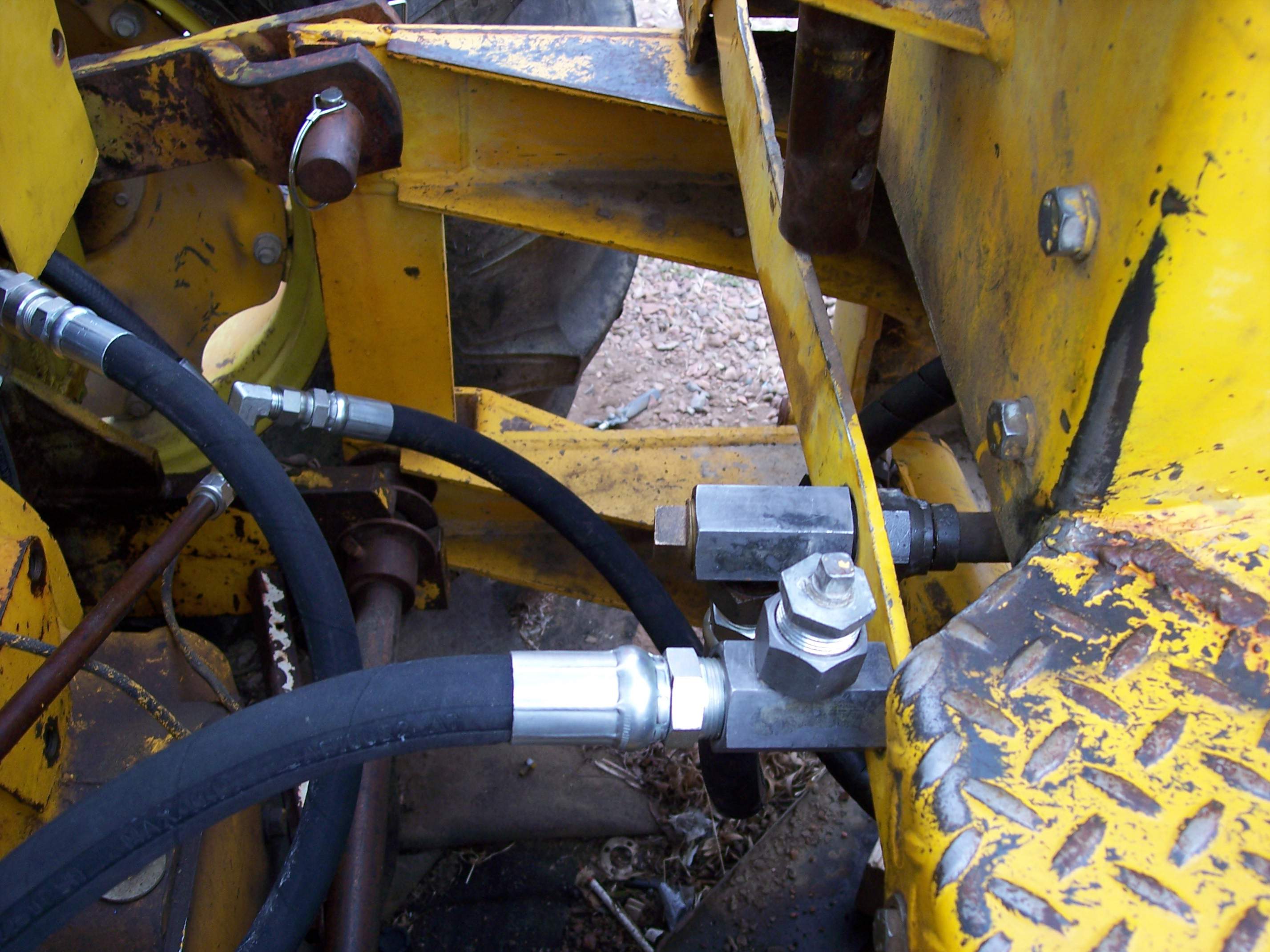

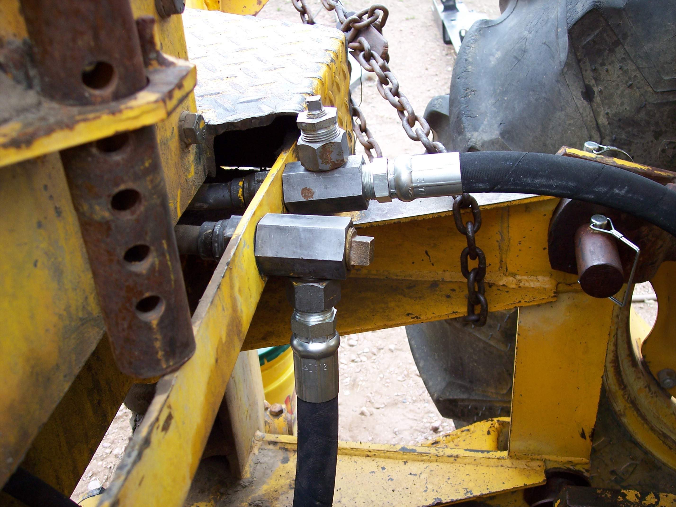

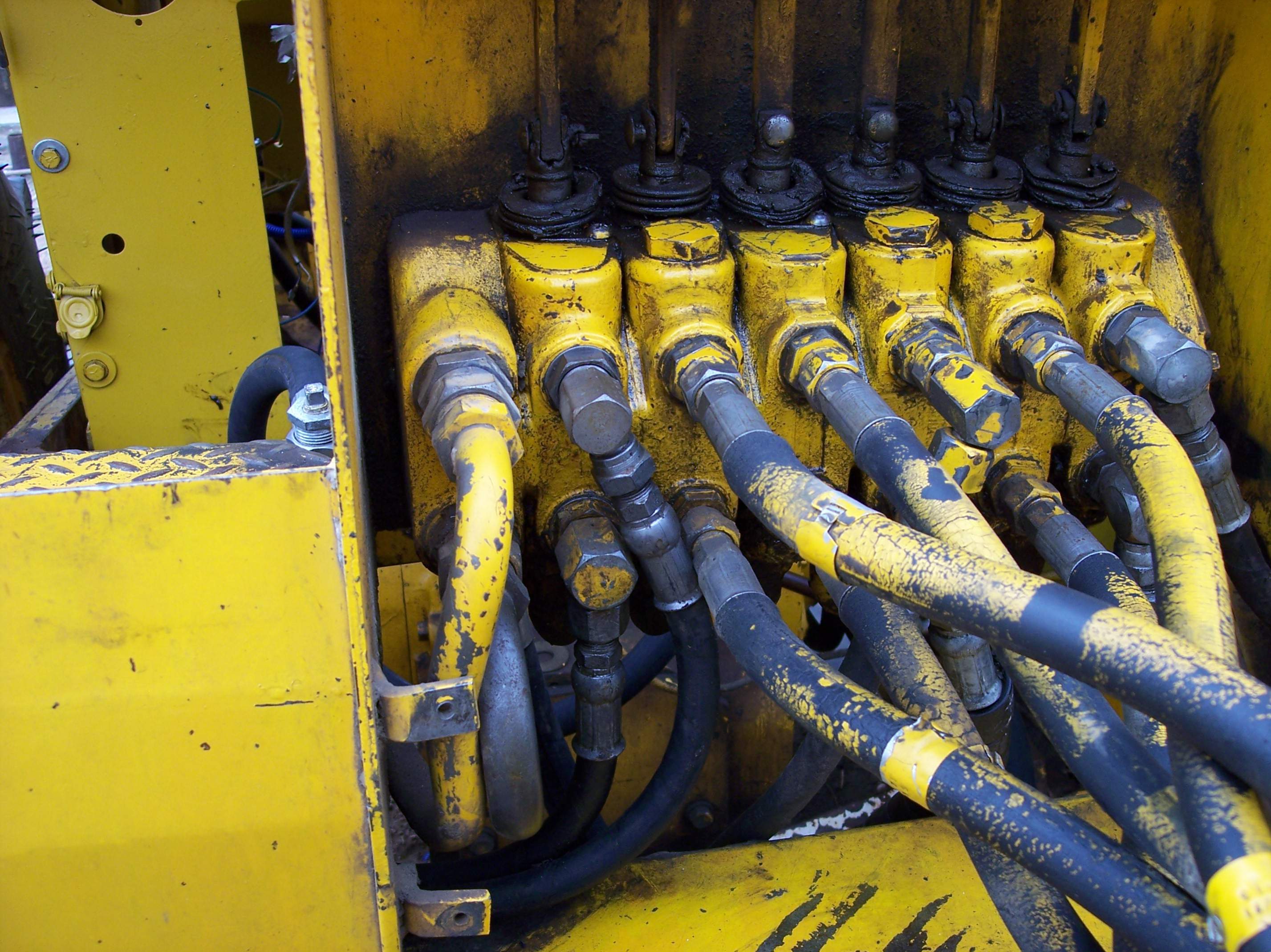

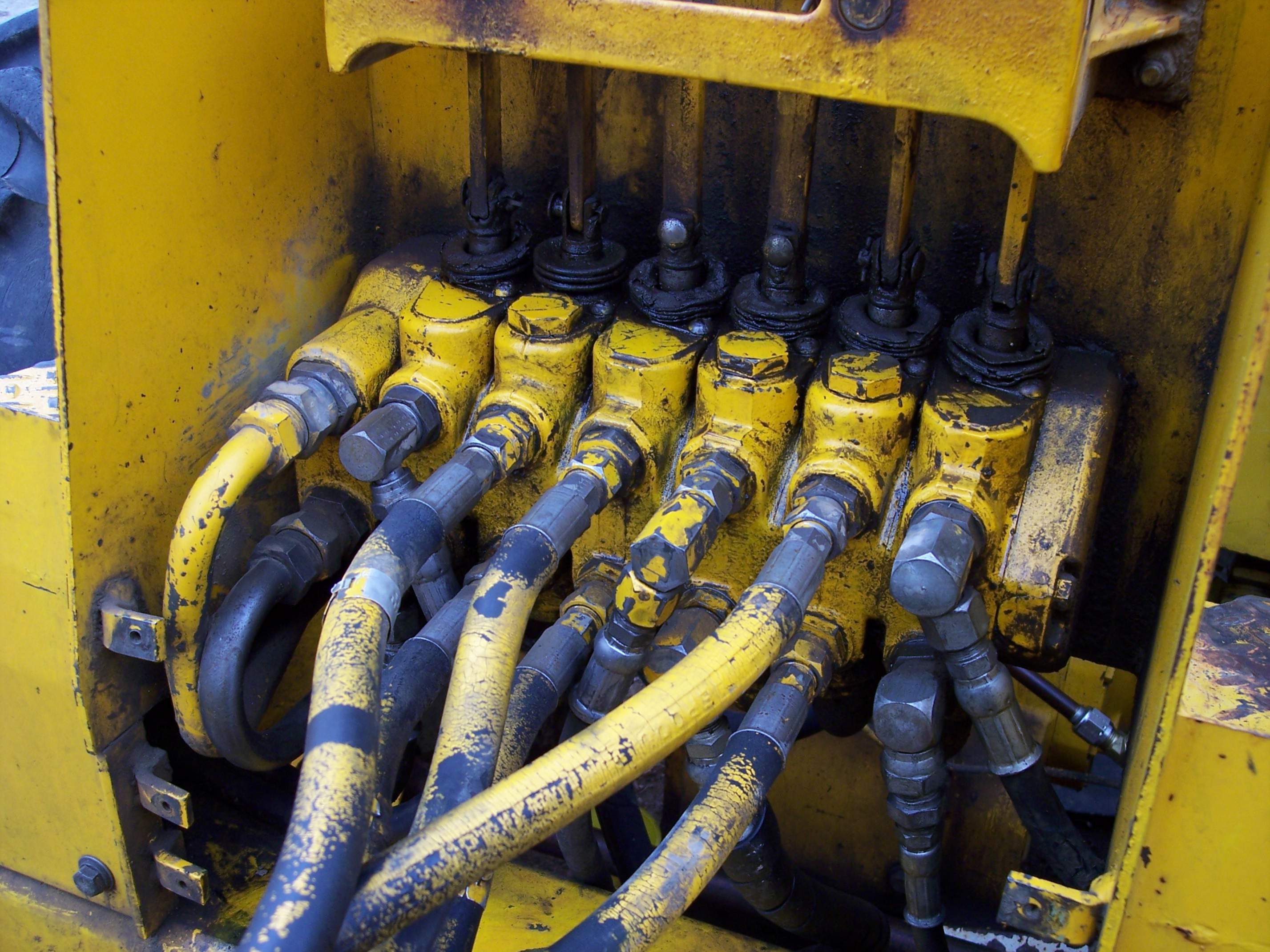

I am going to try to load these pictures now.The first valve body section to the left of the picture is the inlet-outlet section the upper one is painted the lower is unpainted. The rear pictures show the two ports, hoses 100_0645.jpg100_0646.jpg100_0647.jpg100_0648.jpg100_0649.jpg just attached to keep the dirt out.

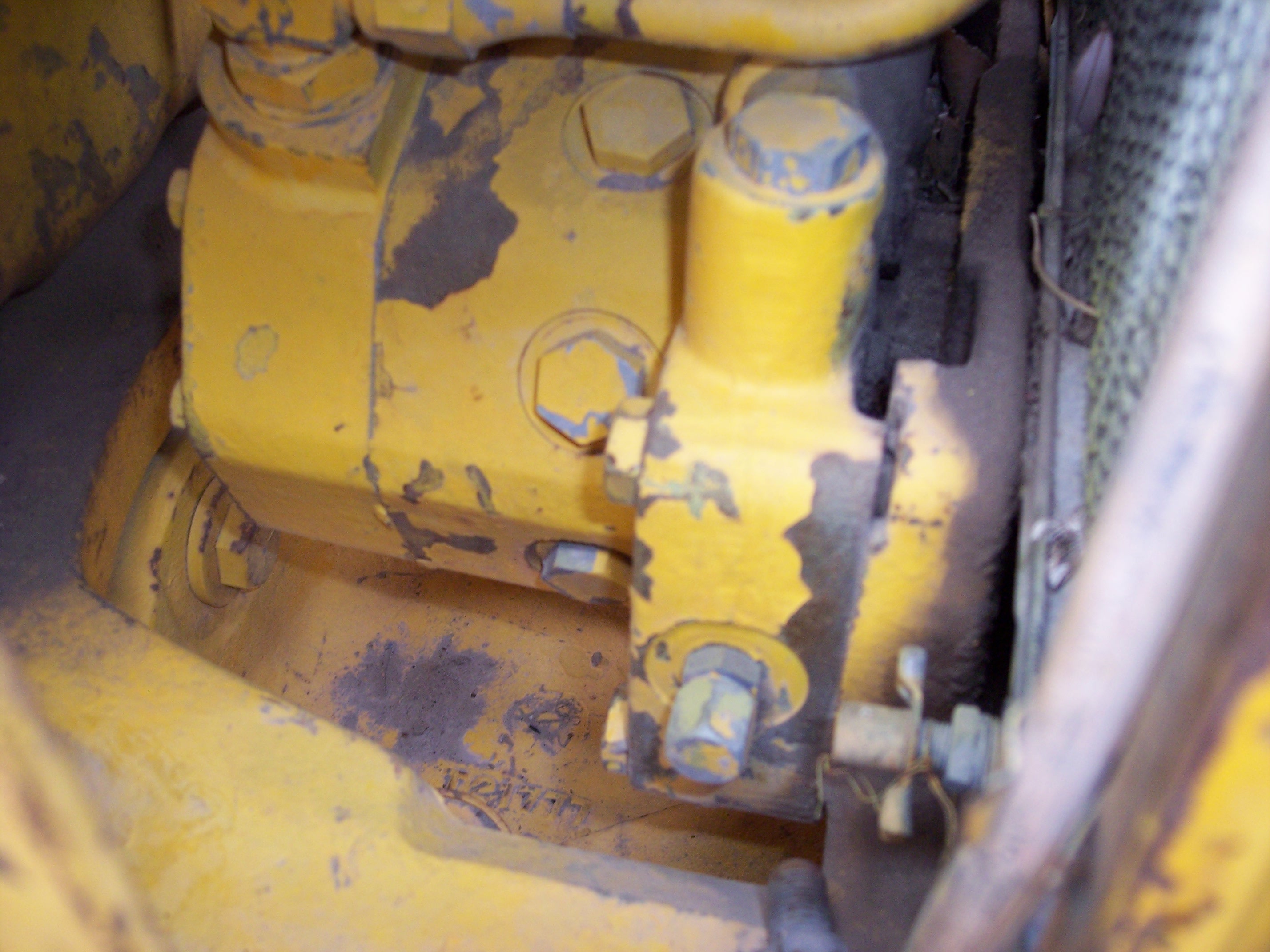

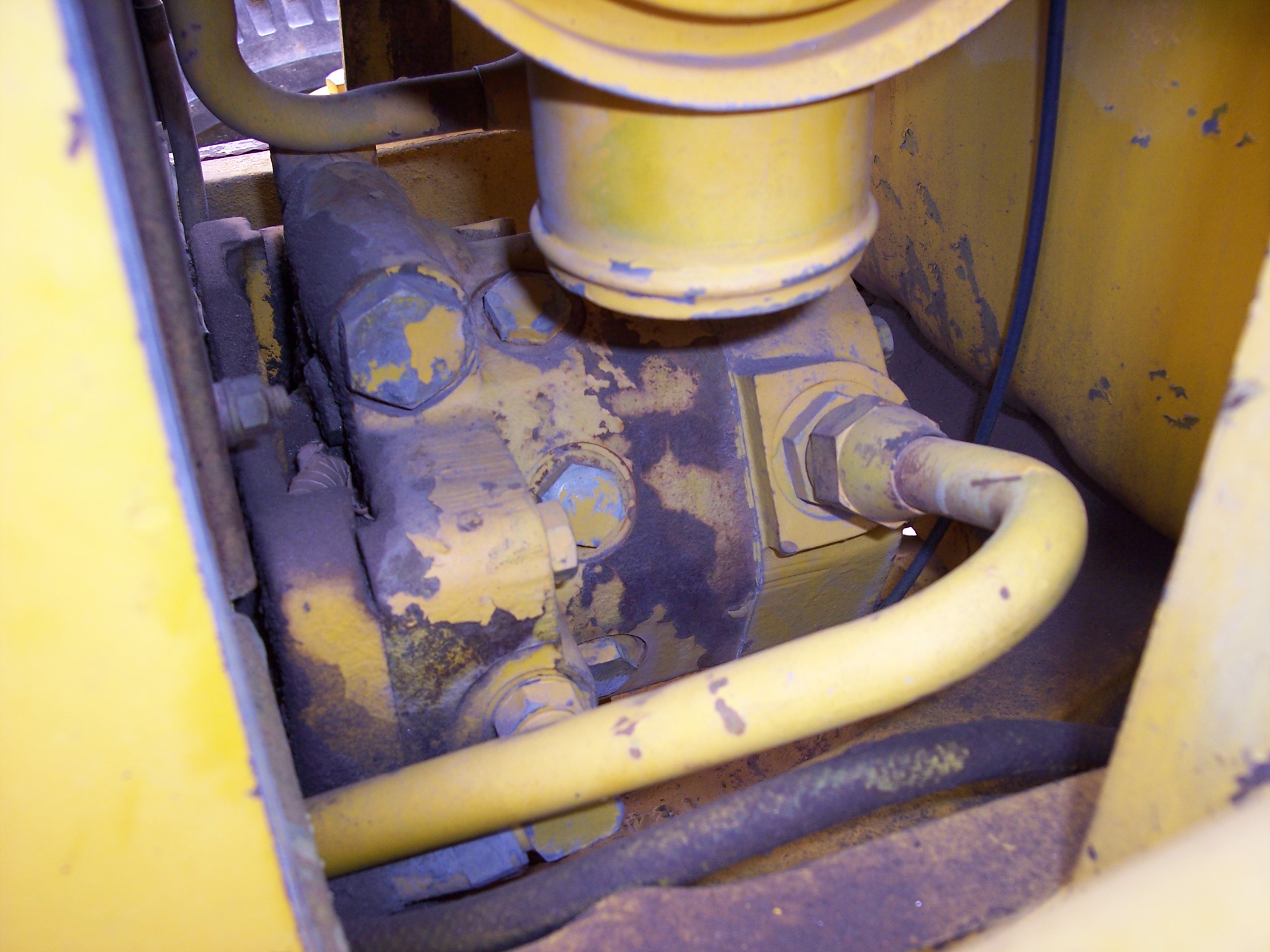

I just looked at the pump area didn't see a relief valve Here is two pictures of the pump as good as I could get. thank you100_0650.JPG100_0651.JPG
   / determination of inlet- outlet on an unmarked closed center valve body #10
What is under the hex cap in the last picture?
